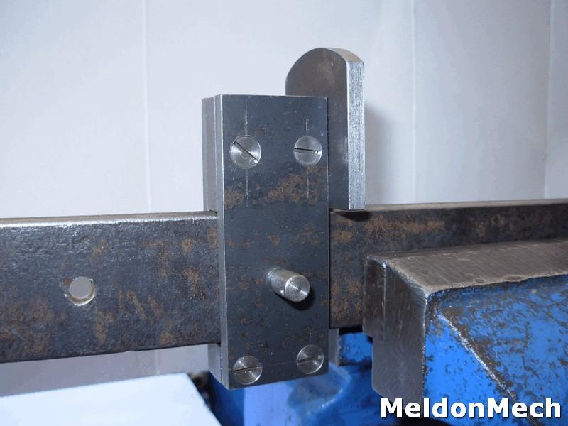

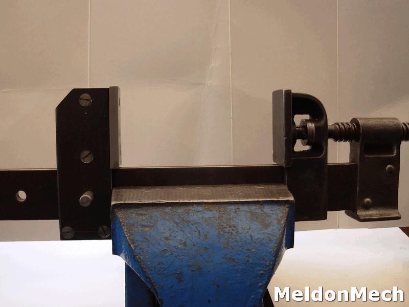

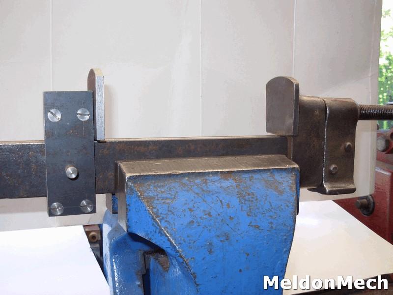

Hi Guys

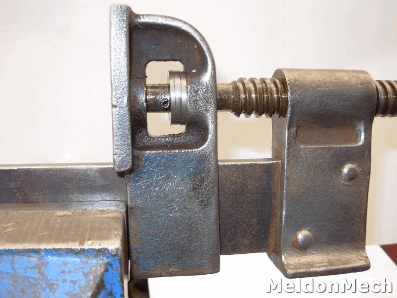

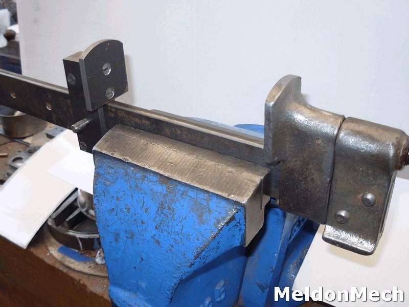

              I recently spotted a pair of rusty old sash cramps at a car boot sale, in fact they were not an identical pair but of different make, but the same length three feet. The sliding adjustable stop was missing, as was the tapered locating peg on each cramp. I hummed and hah'd but when I asked the price, it was " £3 quid each mate, or two for a fiver," and the deal was done.
         When I arrived home, out came the wire wheel, and half an hour later, they were showing off their burnished finish. Three washers and a new roll pin were required on one, to reduce backlash in the clamping screw.

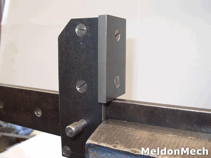

         The sliding stops were fabricated out of bits of scrap plate I had in stock.  A couple of pins were turned up, and drilled for their chains, which I have not yet aquired.
          I am quite pleased with the results and the cramps work well.
                                                                                         Cheers David

   Thanks Guys for your replies, I fitted a short nut and bolt in the last holes to ensure the moving jaws could not get lost in  future.
                                                                                    Cheers David
