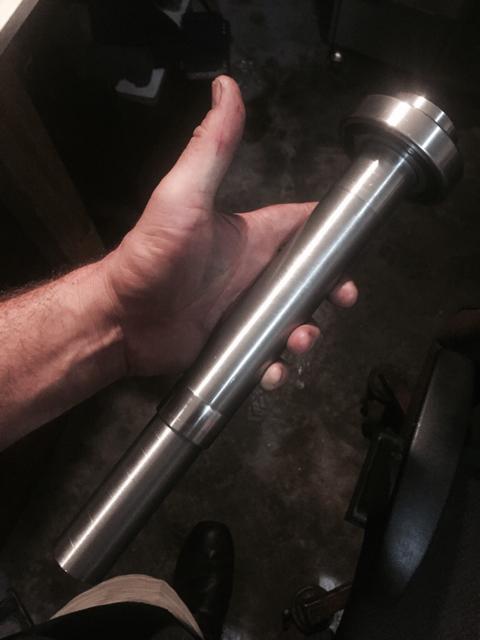

Hi all. I have been contemplating for a while now the build of a new spindle for my Tom Senior M1 mill. Reasons as follows
1. Current knuckle head configuration utilizes a 45 degree helix gear set, the teeth on my set are worn sharp and dont like high speed or mild steel at all. Lots of noise gets generated
2. Head hight with the current head is very limited
3. High spindle speeds for very small end mills are impossible due to machine construction
4. Very limited angular movement of current head.
5. I would like to preserve the current knuckle head
in a working condition, thus need a replacement spindle before this one gives up the ghost.
After trolling the internet for ideas i saw some people fitted Bridgeport M heads to their TS mills. Bridgeports are extremely scarce in my neck of the woods, let alone parts or something as exotic as a M head. So i decided i will take the plunge and build my own spindle.
The spindle needed to be belt driven and not break the bank
I decided to use angular contact bearings for the spindle bottom and a deep groove ball bearing for the top. Will see to arrangement as i go along. Any suggestions?
Well i started to machine my spindle to be out of EN19T and it is slow going on my ML7!!

Hi all, thanks for the suggestions. What would the best lubrication be for the angular contact bearings be? I was thinking about auto transmission fluid (ATF). Would that be too thin?
Re: Homebrew TS mill spindle
« Reply #5 on: June 02, 2015, 02:02:04 AM »
First question: Why ATF oil? Do you have excotic coupling/friction materials in it?
Second question: Why oil? You have vertical spindle, right? Oil has tendency to fall down to bottom bearing and drip out. You need some wics, capillaries or something to oil the top bearing and not to drown the bottom bearing.
I would first consider standard grease and seals. If standard grease is marginal, then a little of high speed grease and if you need more rpm than DN factor / temperature allows then you'll need oil.

Hi Steenkamp,
I've made two milling spindles.
The first made about 25 years ago was for my Aciera F3 which came with no vertical head and all the drive removed.
This one has a Myford nose and 2MT bore. It uses a preloaded 25mm bore double row a/c bearing at the business end and a floating single shielded deep groove bearing at the pulley end. The pulleys are 4-row J section Poly V. They are 3 step and have ratios of 1:1 (3,000 rpm max), 1:2 (1,500 rpm max) and 1:6 (500 rpm max). The motor is permanent magnet DC. The bearings are grease lubricated.
The most recent was for my CNC mill.
This also used preloaded double row a/c bearing (this time a bigger section - 30mm bore) at the cutter end and two shielded deep groove bearings at the pulley end. The two deep groove bearings are preloaded together with a wavy spring. They are an easy fit in the housing so that they can float as the spindle warms up. The idea of using two deep groove bearings was that they tend to run quieter with preload. The spindle takes ER32 collets directly. The a/c bearings are oil lubricated with an oiler. The seal is a labyrinth with a drain so, in theory, I'm not sprayed with oil. This hasn't been entirely successful and I have a new design in the pipeline. This also has 3 step pulleys from 2:1 to 1:3. The belts are 5 step J section Poly V (easy to get as they are used on lawnmowers). The motor is a 3 phase Inverter rated motor which I run up to 5,000 rpm. This gives me a range of spindle speeds from 450-10,000 rpm. It's surprising how much of the time I use 10,000rpm. 8,000 rpm was the limit for grease lubrication.
Both spindles work very nicely but I have a feeling that the version with 2 deep groove bearings at the top is better.
You say you are considering one a/c at the bottom and one in the middle. Is there a good reason for this? As you run the spindle it will heat up and this will affect any preload on the a/c bearings. The bigger the distance in between, the more the preload decreases.
Hope this helps.
Cheers.
« Last Edit: July 13, 2017, 01:22:02 PM by philf »

Thanks for the sound advice. Pekka, i will probably just use some highspeed grease. Phil, how do you keep your spindle from being pulled down into the cut if you have a floating bearing at the top? Or am i going to the doctor before falling out the tree? Did you run a bit of I understand  what you mean with preload increasing and was worried about that with my configuration.
Offline Steenkamp
  • Posts: 41
« Reply #11 on: June 03, 2015, 12:04:15 AM »
Phil ,sorry, that one was sent waaayyy to soon. What i wanted to ask was whether you ran a bit of preload on your top deepgroove bearing to keep the spindle from moving in deeper sidemill cuts
« Reply #12 on: June 03, 2015, 01:26:21 AM »
Phil ,sorry, that one was sent waaayyy to soon. What i wanted to ask was whether you ran a bit of preload on your top deep groove bearing to keep the spindle from moving in deeper side mill cuts
Hmm... on this bearing arragement double angular contact bearings should take all the machining forces. It is a textbook example an proven to work
http://www.skf.com/binary/21-3587/1__en__001_0212_tcm_12-3587.jpg
http://www.skf.com/group/products/bearings-units-housings/ball-bearings/principles/application-of-bearings/bearing-arrangements/index.html
I see what you mean, but the way I have seen, the preload in a single nonlocated bearing is used only if bearing is not loaded enough, here is a belt drive, that should give the bearing minimun load it needs.
http://www.skf.com/group/products/bearings-units-housings/roller-bearings/principles/selection-of-bearing-size/dynamic-bearing-loads/requisite-minimum-load/index.html
In order to this tail end bearing taking a significant cutting force the arbor should deflect and A/C bearings would yield or move, neither is desirable.
I think.....I'm electrical engineer not bearing engineer :lol:
« Reply #13 on: June 03, 2015, 03:35:39 AM »
Hi Guys
Hi,
The double row a/c bearing is clamped in the housing and there is sleeve between the inner races the a/c bearing and the deep groove bearing. (On the version with two deep groove bearings there is also a spacer between both bearings). The nuts on top clamp everything together. The a/c bearings have the preloaded built in - the outer races just need clamping together.
The wavy washer just preloads the deep groove bearings.
Offline Steenkamp
  • Posts: 41
« Reply #14 on: June 03, 2015, 07:10:02 AM »
Thanks guys, now its clear! Will be back home next week, so will put onto practice what i have learnt from you!
Offline Steenkamp
  • Posts: 41
« Reply #15 on: June 03, 2015, 07:16:53 AM »
Hi guys
Here is a pic of the spindle outside done, bearing journals polished to size, with bearing on to test fit. Inside is drilled through with 16mm bit. Had to use a long masonry bit to finish the last little bit in the centre to break through. Still have to cut the 2 morse taper and threads for retaining everything.
