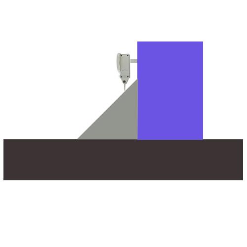

Can one not precisely check or set angles by turning (and / or grinding) precisely sized disks and abutting them? Three such disks firmly in contact with each other can have straight edges tangentially touching two disks and forming an easily calculated precise angle between them?
Re: Checking a 45 degree square?
« Reply #24 on: May 27, 2015, 05:45:29 AM »
If it's triangular shaped couldn't you measure the lengths of the sides, and just make sure they match and the angle between them is 90 degrees?
There are some practical considerations on how sharp you can make the edges....therefore this is not very accurate.
Yesh, this is old "book" method and used to check squares etc. I would take some roller bearing parts or ball bearings or such. Surely there are three of them proper sized lurking somewhere? But you need a good square or four identical bearing rings to check the square first :wave:

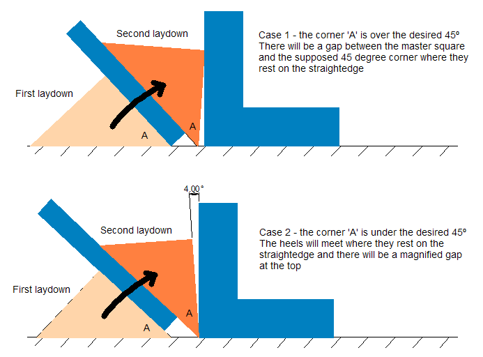

Rich,
Given you've already got an accurate 90 degree master square, I think you could make an assessment by adding just a flat base plate, 'something' with one known good straight edge, and a short length of known parallel bar - and no need for any scribing or interpretation thereof:
(i) Lightly clamp your straight edge to the plate. (ii) lay your new one against the straight edge (iii) lightly clamp the parallel against the upper edge of your new one, (iv) ease the new one out and re-lay it against the top side of the parallel, (v) compare this against your known good 90 degree master square.
Sketch below .....

DMIOM, I see how that would prove that the two 45s add up to 90, but you wouldn't know if you had a 44 and a 46 though? Or am I missing something?
I thought about using Pythagoras but I can't see a way to accurately measure the length of the thing, plus the slightest bit of damage to the edge of the triangle would make it hard to measure.
I'm trying to understand the method for using rings/bearings but I'm not getting it... Could someone explain? Do you mean to put two discs of different sizes side by side (like oO), having made the sizes of them such that an object laying over them would be at exactly 45 degrees? That seems like a plausible method?

I guess the attached image is what I was thinking.
By turning the two cylinders to size (and presumably finishing really carefully with some fine sandpaper) I could do the maths and end up with a parallel or suchlike lying across them at 45 degrees, I could then indicate off that to assess the one I was making/testing.
Kind of just like a sine bar really, but since I don't have a sine bar or a set of gauge blocks it saves having to buy them  :clap:

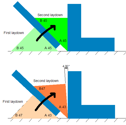

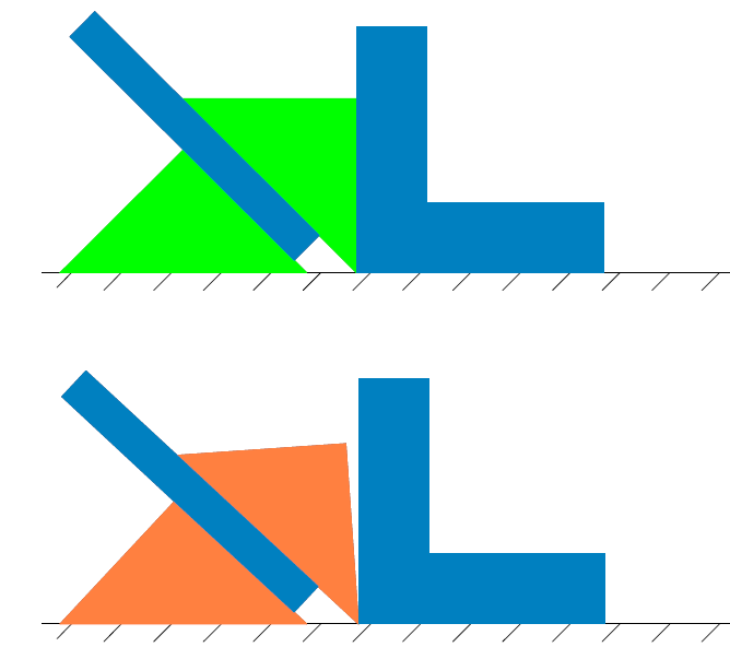

DMIOM, I see how that would prove that the two 45s add up to 90, but you wouldn't know if you had a 44 and a 46 though? Or am I missing something?......
The key is to keep the same face up and just rotate it about one corner ('A' in the sketch below), so you're doubling the angle of one corner - and if its the desired 45 degrees, then you'll match your 90 degree master square, if not the discrepancy will be magnified by a factor of two.
Annotated version of sketch attached.

Dave - that's boggling my mind a bit! I'm still a bit unsure how I would know which way the error was, I'm sure it's possible I'm just getting confused  :hammer:
Having said that - I think I've just come up with a way of doing it which only requires one 45 degree part and the master square-
If I set up an indicator on the master square such that it's tip is about 10mm off the surface of the square, pointing downwards, and bring the 45 degree and butt it up against the master square such that the indicator reads off it's height (say about 10mm 'in' to the 45), note the indicator reading, then turn the 45 around and do the same on the other side. If it's not 45 the reading will be different, if it is 45 the reading should be the same.
It would then just be a case of scraping off whatever the error was from the 'high' side, and re-flatening the thing.

This is what I mean:

Loply you don't need an indicator. An adjustable hard point will do. You just need contact both ways.
Besides, do you have an indicator that measures the 10 microns which is your goal?
The real question that has been missed all along, is not how to measure or get an angle, which you can do with many methods discussed and others as well, but how to rub and scrape it to that angle using contact methods, rather than measurement methods, which are the inevitable step in any mathematical determination of angle.
Sure, everyone knows Pythgoras theorem and owns a calculator, but once you've done the math how do you translate that without measuring? Sine bars and machined holes and pins are all measured somewhere along the production process -- whethere it is of the mill table calibration, mill tool size, mill movement, etc, and NONE of those are to my knowledge done to a 10 micron tolerance.
The whole essential of traditional hand scraping is a method which does not depend on measurement, but upon indicators of contact. We use math to do approximate work, and discard math in favor of contact and a contact indicator (blueing) to do extremely precise work.
I've already given a contact method which will, with a contact indictor, allow a person interested in a practical method, to scrape, and see non-contact areas. It will work as is.
I'm sure it could be improved upon (as most things can) with slight modifications to get work done more efficiently, though not necessarily more accurately. But most of what I'm reading here ignores the tolerance stated and the methods necessary to reach it. No system of measurement with a lower tolerance anywhere along the line of production will guarantee the tolerance required by the OP.
Rich - your indicator method doesn't (IMHO) make use of the full length - you're trying to make an ultra accurate measurement over a short span.
Have made another sketch to show how you would tell if one corner was too fat or too acute (the examples have 43&47 degree angles to make the differences visible)
