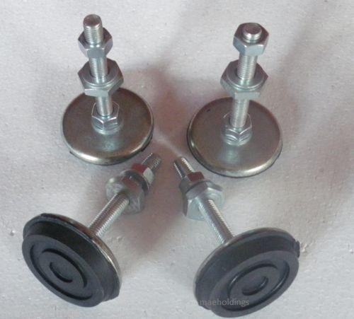

Are there no adjustable feet under the lathe cabinet? If not make some - big nuts and studding works well, or find some 'anti-vibration feet'.
Makes levelling very easy.
