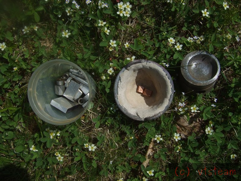

Since David (Meldonmech) in his QCTP build thread and Andrew mentioned alloying copper with aluminum to increaase hardness, I did a few lookups online (and in a book I have) and found an alloy that looked interesting using 6% silicon and 4% copper, so decided to try it with scrap onhand.
I used a 14 oz piston for silicon content (likely about 12%) and 14 oz 6061 extrusions, which would bring the silicon level to about the 6% needed, and 1.2 oz of copper tubing for the 4% copper. I flattened it and rolled it together to reduce oxidation. Here are the ingredients:

I wasn't sure if the aluminum would dissolve the copper directly, or whether the copper should be molten first, so I tried melting the copper to start with. After about 25 minutes and the copper glowing bright orange, it still wasn't molten, and being impatient, I started dropping some of the aluminum in. When a good heel was going I added more and eventually the piston, and had a brimfull crucible as a result.
The copper did dissolve in the aluminum, so I probaby could have saved much time and fuel had I just put them all together to begin with.

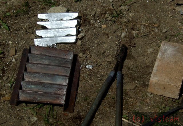

I just poured ingots -- long ones so I wouldn't mix it up with my other stock in muffins.

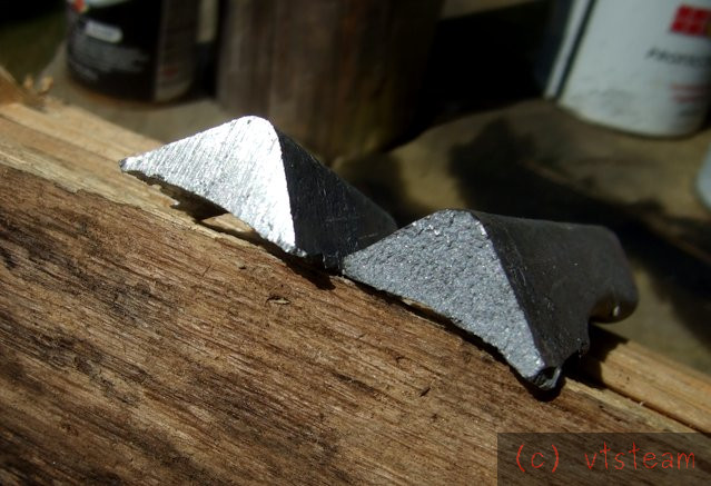

Rob, I haven't tried machining it yet, but will. I did snap one of the thinner ingots in half in the vise with a big hammer. It definitely breaks rather than bends. It feels hard, and rings hard. But it isn't any harder than a piece of 6061 I tried scratching it on. Also, no harder than a cast aluminum part on my Gingery lathe (pure melted pistons). Not s hard as zamak za-2. But it did scratch some of my newer stock of ingots (also pistons). Not much harder than them, though. I'm guessing the difference may be due to aging of the castings and 6061, possibly making them harder, while the newer ingots were scratched.
Anyway, not a big improvement in hardness. Nevertheless just handling it, it seems hard and tough -- just a subjective impression. I don't know why that is.
It saws readily with a hacksaw. No tendency to smooth over or gum up.
It files easily, and again seems harder under the file subjectively.
Unfortunately I can't compare it to my other cast aluminum for strength and brittleness, since I don't have a similar section in those others for the vise break test. I did try some 6061 of similar thickness which seemed much tougher. But it's a good tempered extrusion alloy compared to cast, so that wasn't unexpected. The big question is, is this a better casting mix than just straight pistons?

Here's a sawn end and a broken end:

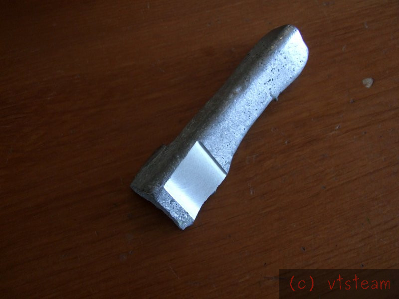

I just machined this mix (un-treated) and it machines well enough as is. No idea if it were hardened.
The finish is not as shiny as plain 6061, but maybe a little shinier than the high silicon piston material that I use.
