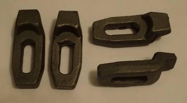

What is "workshop grade"?
I bought some swan neck clamps and complained that critical parts were not machined. I can't imagine how they would be used before milling the nose to few degrees down - these have a slight nose up attitude.
I complained about quality and got this answer:
All Our swan neck clamps are of workshop grade and this is the reason some defects can be found sometimes. If your unhappy with the product please feel free to return for a refund.
Or are my expectations too high? For the price I paid for four pieces I could have got 1-2 good ones. IMHO I made a bad deal.

You could use them with a higher packing piece behind them or you could clamp them to the faceplate and machine them flat. It can be a useful exercise to manufacture them from scrap mild steel or cast iron pieces rather than paying for castings that aren't very cheap due to the small number sold.

For what it's worth they don't look very nice.

In all fairness you can see the surface on this picture, but they don't have creases and seem to have a healthy nose down attitude.

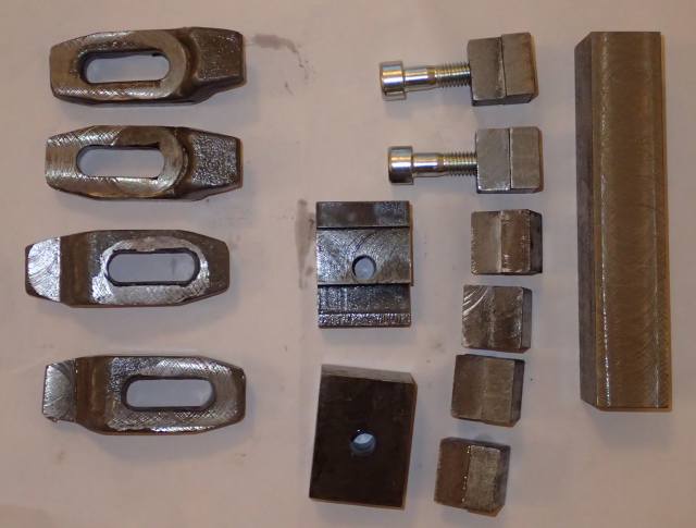

Anyway I started to mill down vice clamps from 20*30 mm HRS. I though I got something ready instead of starting from the ore.
I'm going to figure out how to bolt these down to just minimum amount of surfacing on clamping parts. Maybe this can be fixed.

I machined these clamps and they felt very soft, even cheesy. Hope they will be good for something.....I don't use sinkers.

Little milling and almost there.
