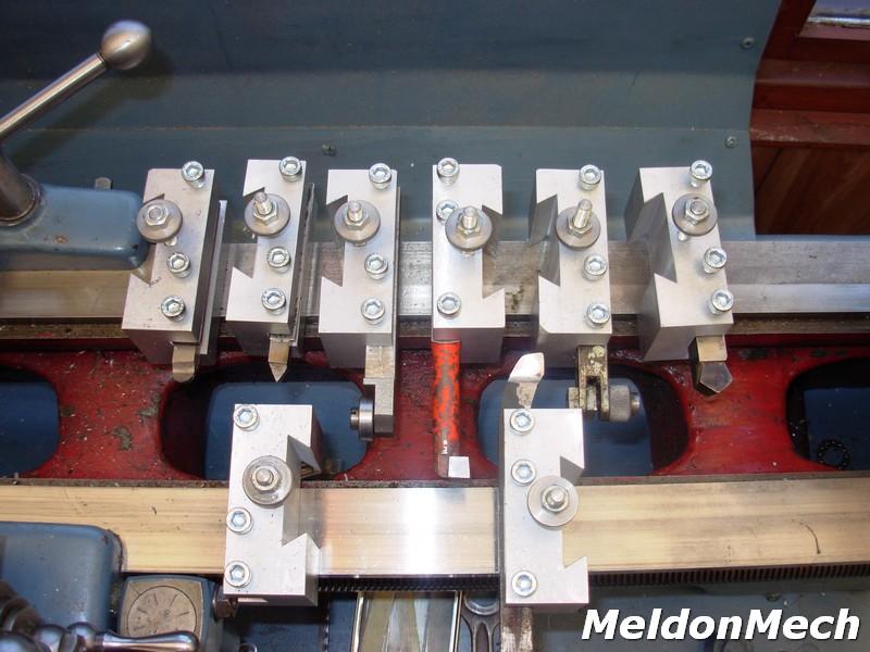

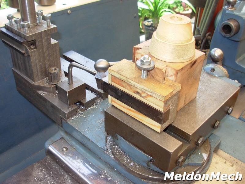

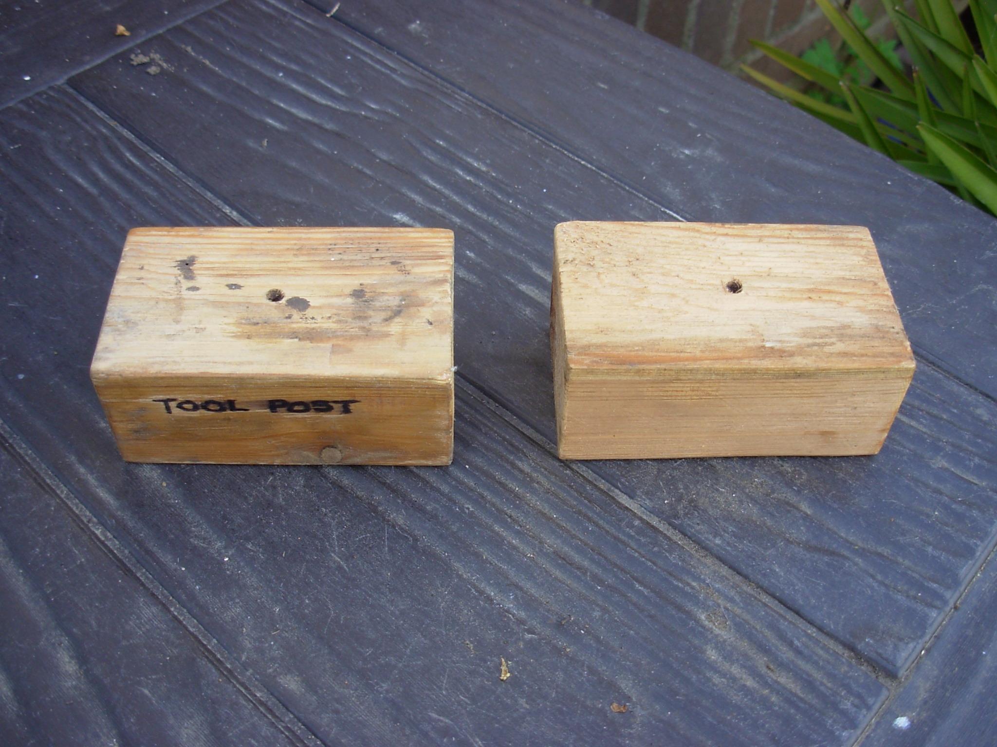

Hi Guys

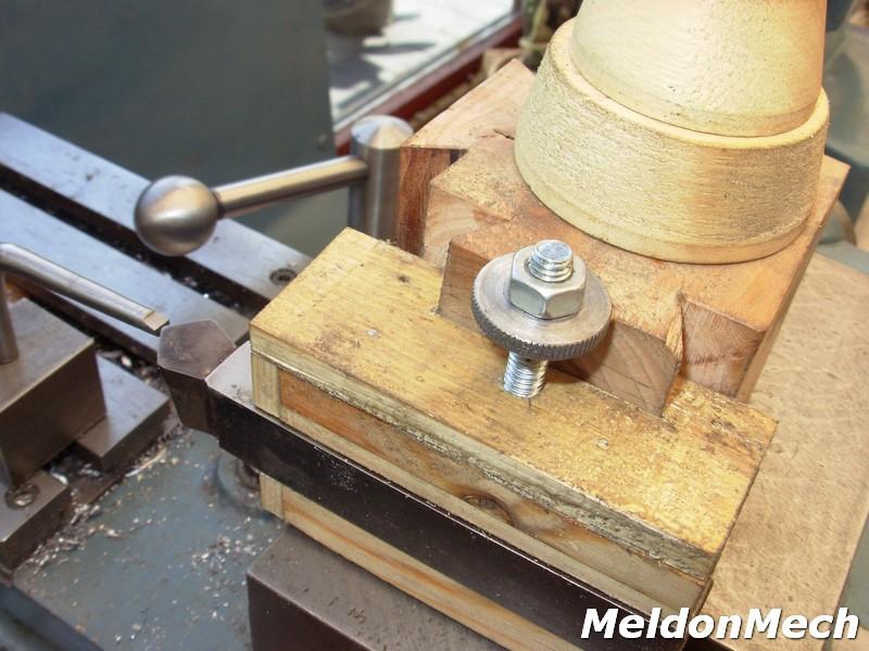

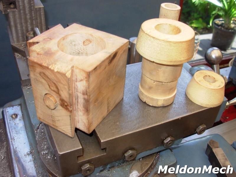

  When I bought this lathe it came  with a non adjustable single tool post. Reading posts from members re,which size to purchase for their lathes, I decided to make a few sketches and make my own. To ensure it would fit my lathe, I made a prototype out of timber, to prove the design. The wooden model worked well providing positive locking.
                         I had a steel ground block, which has sat on a shelf in the workshop for years, and suddenly realized it would make the ideal  body for the tool post. The tool holders will be cast aluminium.
                                                            Cheers David

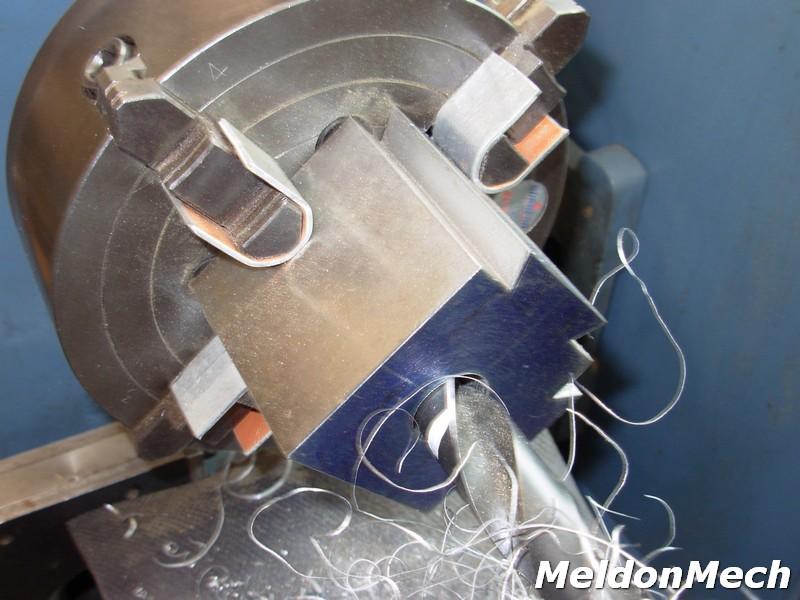

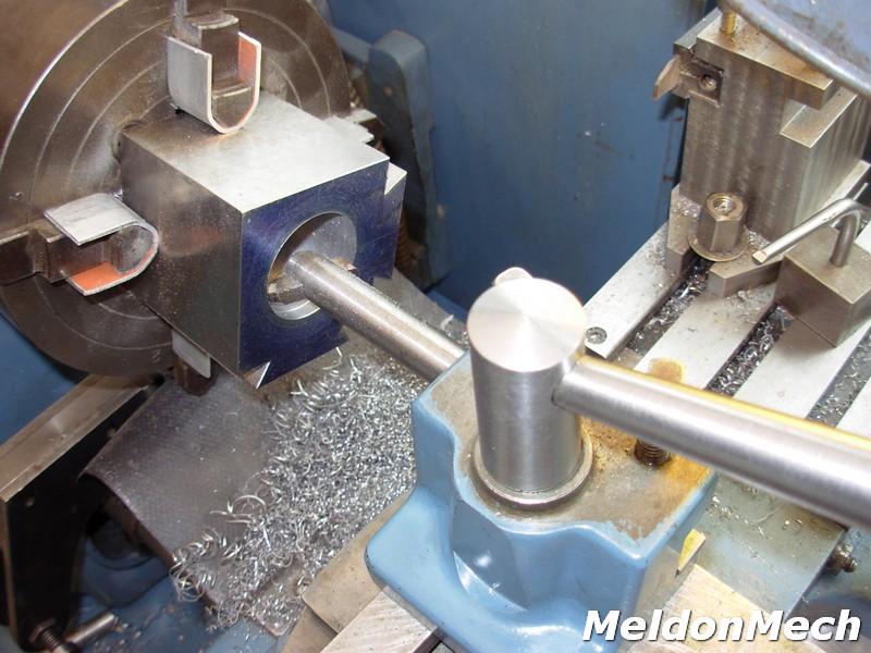

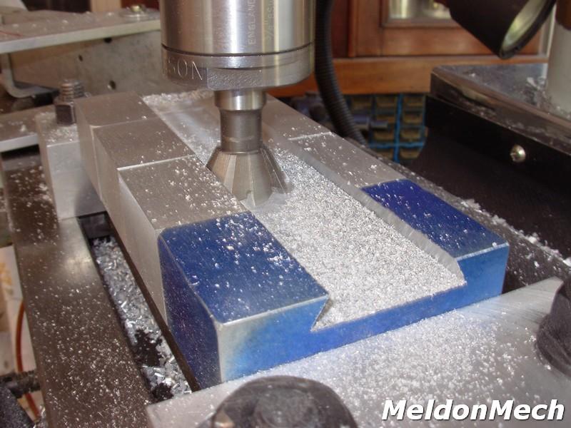

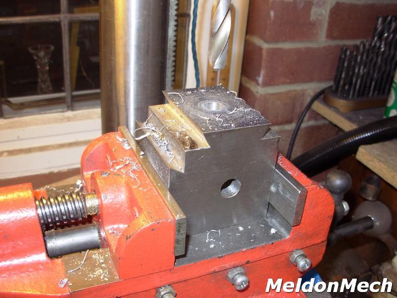

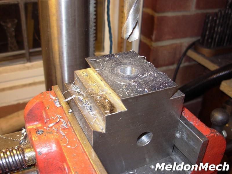

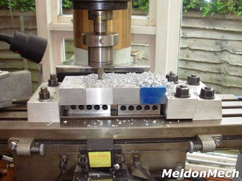

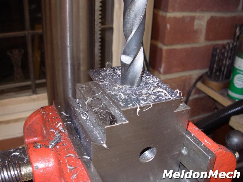

The steel block block was marked out, and the dovetails cut on the milling machine.  They were roughed out using an end mill, and finished with a 60 degree angle cutter. The flat bottomed hole was then drilled and bored in the lathe. As the block had been previously ground, aluminium protection strips were fitted to  the vice jaws.

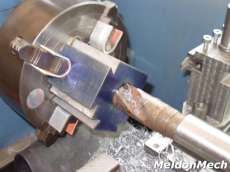

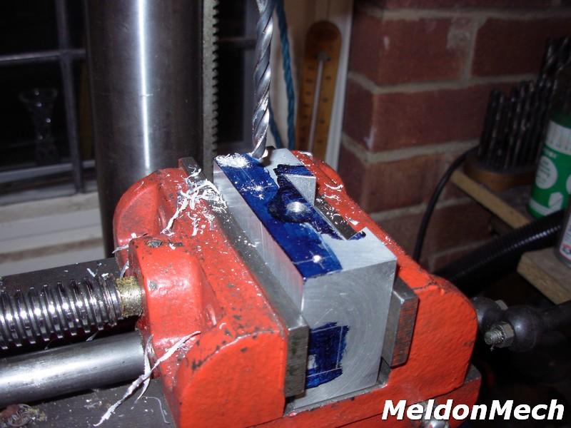

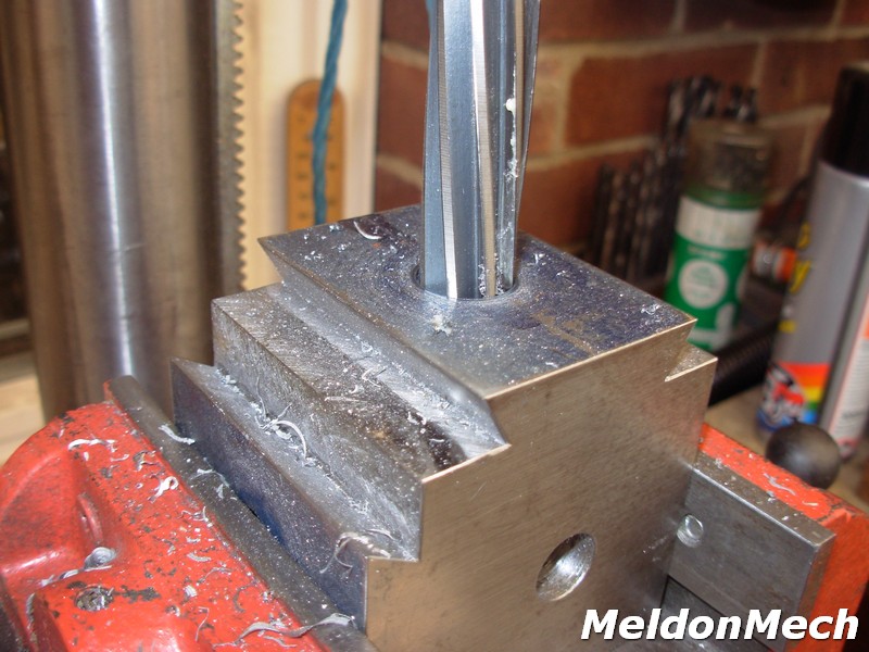

   The block was then drilled, and reamed for the locking plungers.
                                                Cheers David

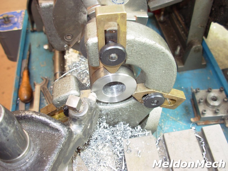

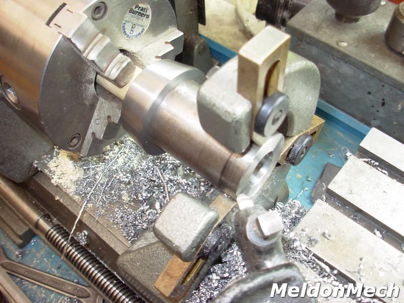

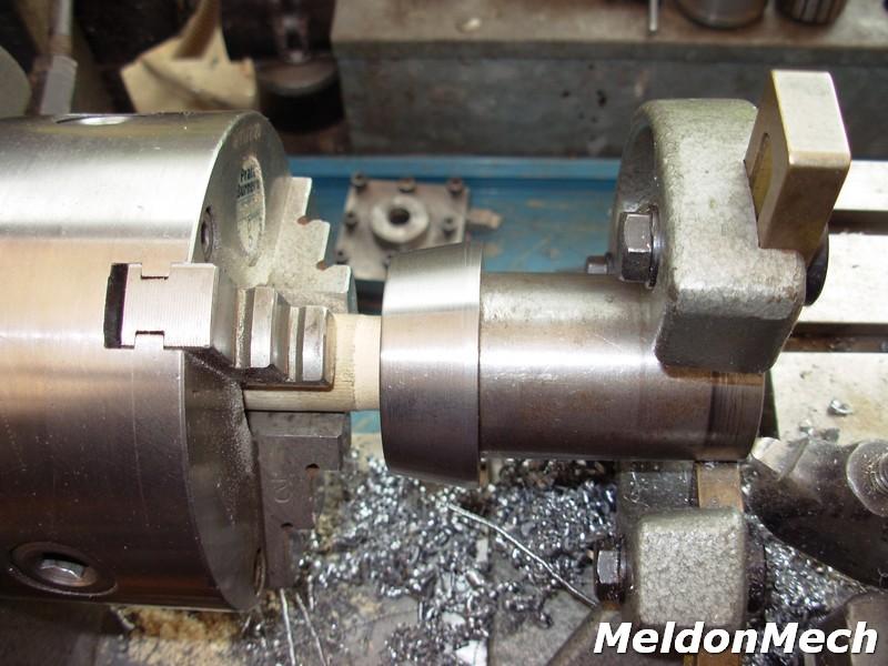

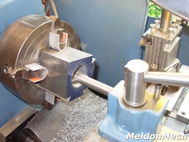

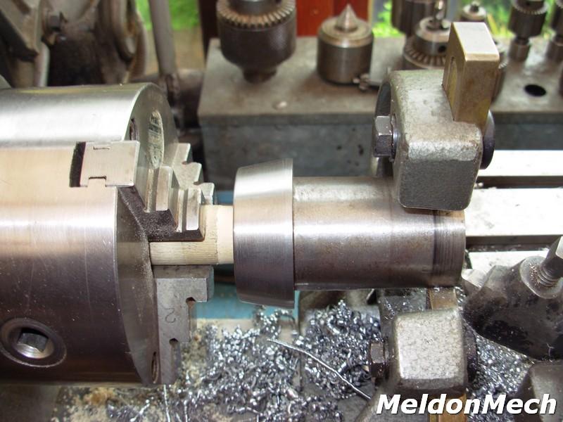

 Next came the locking cam, which aims to lock the tool holder in position, in an angular handle movement of 45 degrees. The basic turning was done in the four jaw chuck, then set over to machine the cam. Finally, the height had to be machined, to provide a close running fit in the tool post. The chuck was first changed to a 3jaw.  A hard wood mandrel was turned with a slight taper to fit the bore of the cam, and a fixed steady used at the other end. Light cuts were taken to carefully machine the bottom to size.
                                                                         Cheers David

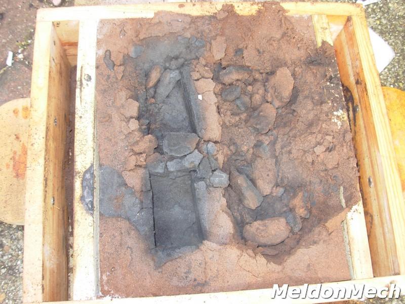

   The tool holder patterns were made using timber. Because  the patterns were so simple I tried open sand casting.  The moulding was much easier, and the castings satisfactory.

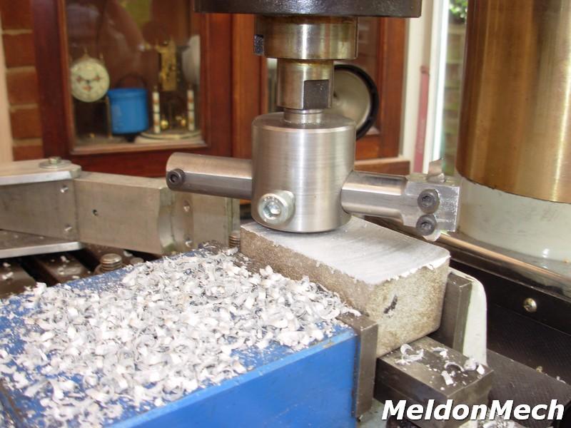

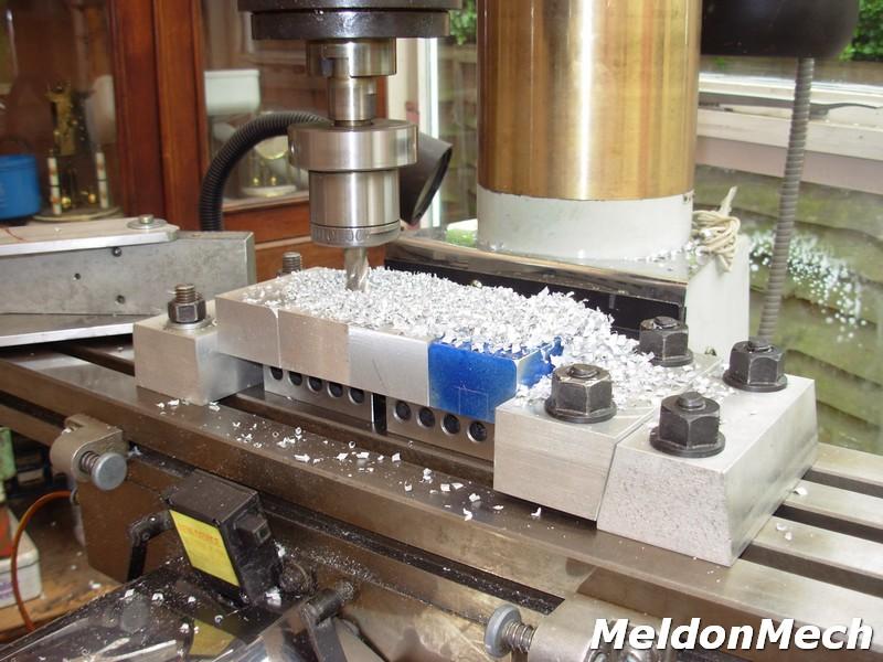

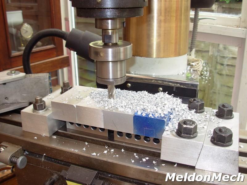

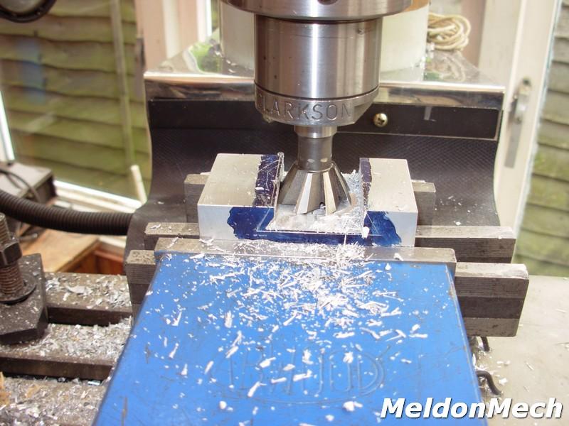

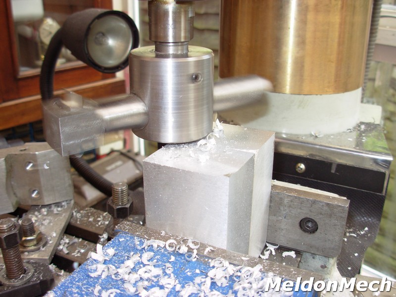

The castings were machined to size on the milling machine using a fly cutter.  They were then marked out for the next operations

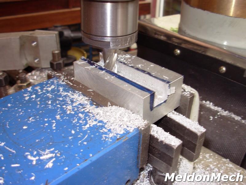

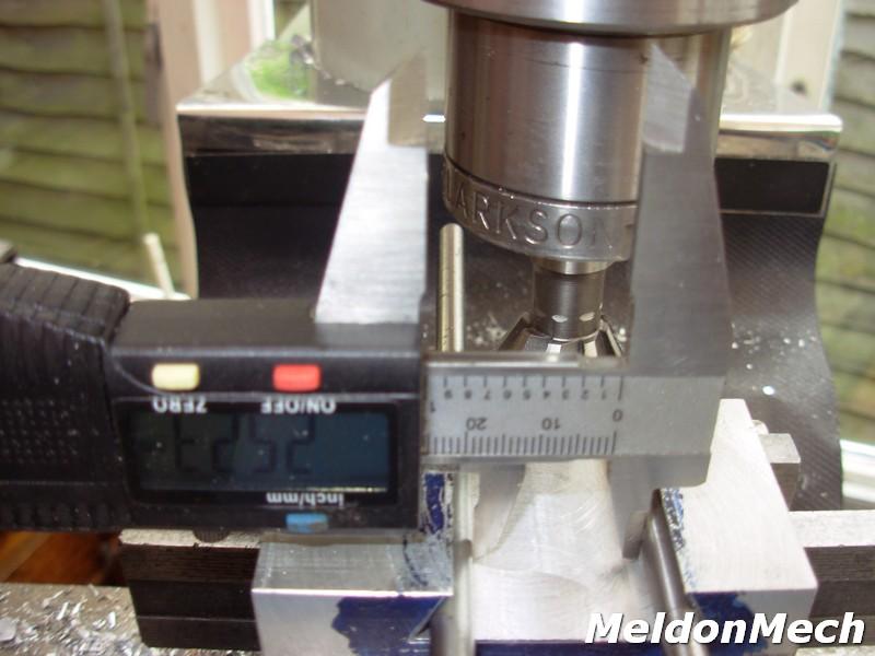

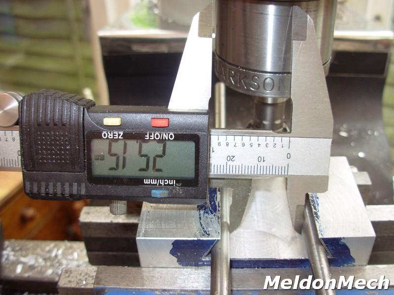

One of the machined blocks was set up in the mill to cut the dovetail. A slot was first cut using an end mill, then finished with an angle cutter. When angles had been formed two pieces of ground silver steel were inserted one either side to check measurements. The dovetails must be a tight sliding fit with the tool post.

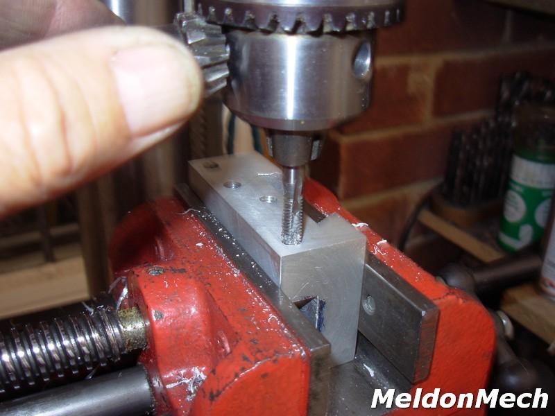

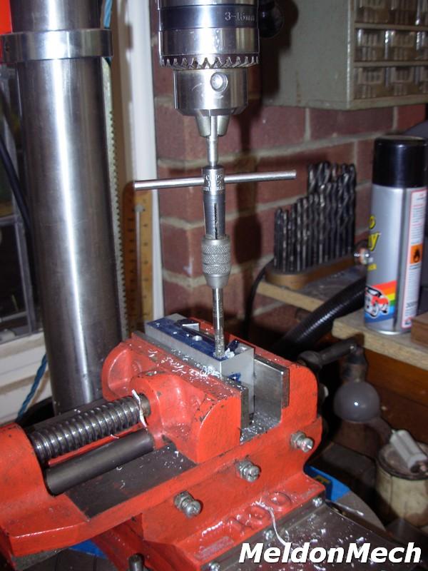

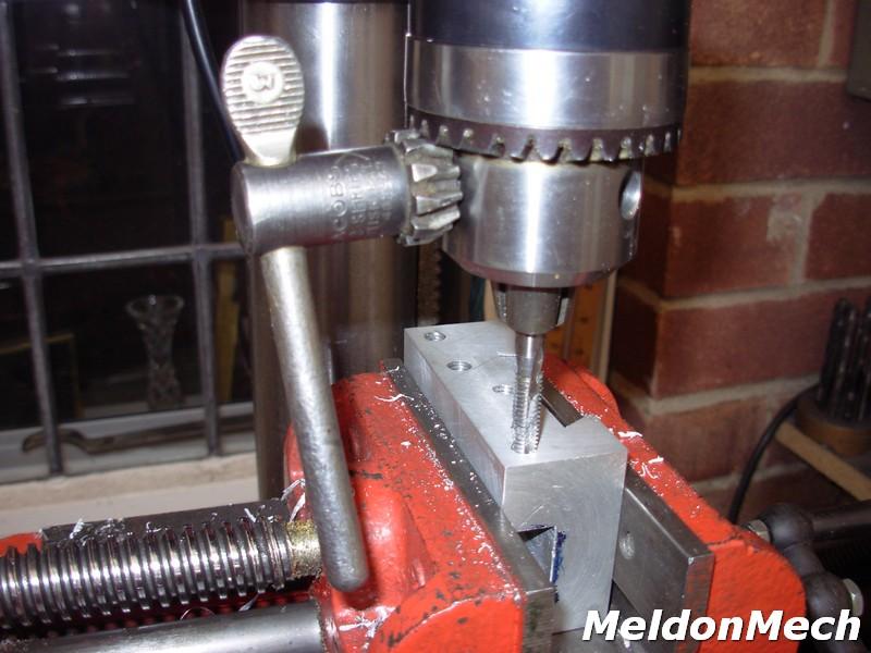

 The slot for the tool was milled, and the tool holding down screw holes, drilled and tapped. Note I made the front two holes close together to enable short tools to be held. A

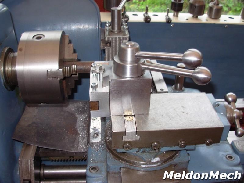

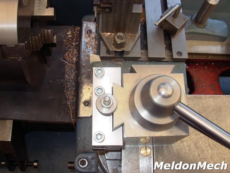

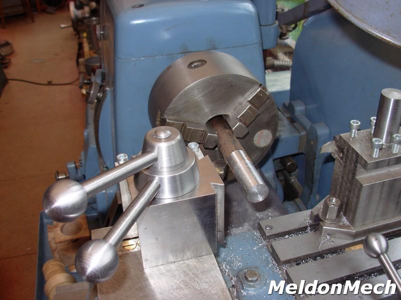

 The remaining parts were straight forward machining ball handles etc. the tool holders were assembled, and tool post set up. A trial was completed, and I was pleased with the results.
                                                              Cheers David

I have a Dickson QCTP, the tool holders are silly prices. It had never occurred to me that cast aluminium would be ok for tool holders. I will be looking at it more carefully now. I could cast long sticks to make the machining quicker and then cut them off to size.

 Norman, you are quite right, on my last batch I made a new pattern and cast a block of six. After machining the block to size, dovetailed the block then sawed the tool holders into six.
          This is definitely the way to go.
                                                                         Cheers David

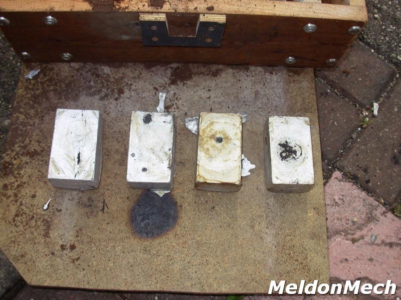

 Andrew, I cast a couple of tool holders from a recent scrap melt which consisted of aluminium carpet thresholds which were surprisingly hard, and some old hard drive cases which contained some tiny copper coils. The resultant casting was so hard it blunted my HSS fly cutter and I had to use a carbide tool. The casting was also quite brittle. I dropped one tool holder I had finished and rather than a burr which I half expected, it had chipped the edge. The finish on this hard material looked almost polished, and was very reflective.
                                        What form was the copper you applied to your melt, for instance was it filings? I think my melt may have contained too much copper. The percentage required is quite small.
                                                        Cheers David

About 4% by weight copper would put it in line with the major copper-containing high strength non-tempered aluminum sand casting alloys. Increase in hardness seems to be from about 45 to about 60 Brinell.
I might try that today as the day's experiment......  :dremel:
(looks like it needs 6% silicon -- so a combination of piston and 6061 extrusion scrap I have here...)
