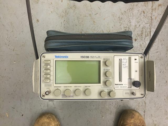

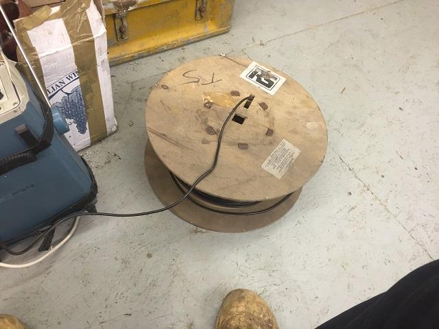

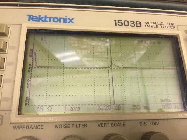

A few details of my unit:
It's a Textronix 1503B TDR bought for peanuts on ebay (can't let these things get away !) from a chap who had no idea, and cared even less, what he'd bought as a job lot from BT. I think I paid more for the manual than the TDR, and the manual was only £15  :ddb:
In the picture I'm measuring the length of a reel of cable (circa 262 metres in this case)
It's really intended for fault detection in telecoms cables, but once you've calibrated it for your cable type (dead easy - ping a length and tell the machine how long it is) it'll work on any cable so long as it's uniform construction along it's length. You will be able to see joints as smaller echos along a length as well which is handy for identification.

Seeing your photo testing the roll, I thought about the large number of nors cable we get these days coming from China.  There is no way to tell if a roll was a reject without testing it like you did.  I guess this unit will be just as reliable as modern day oscilloscopes, as I see a digital display, and won't need regular calibration which is extremely expensive when you let someone do it for you.  I have used Textronix equipment in the past, not a cable tester though and it was great kit to have.
