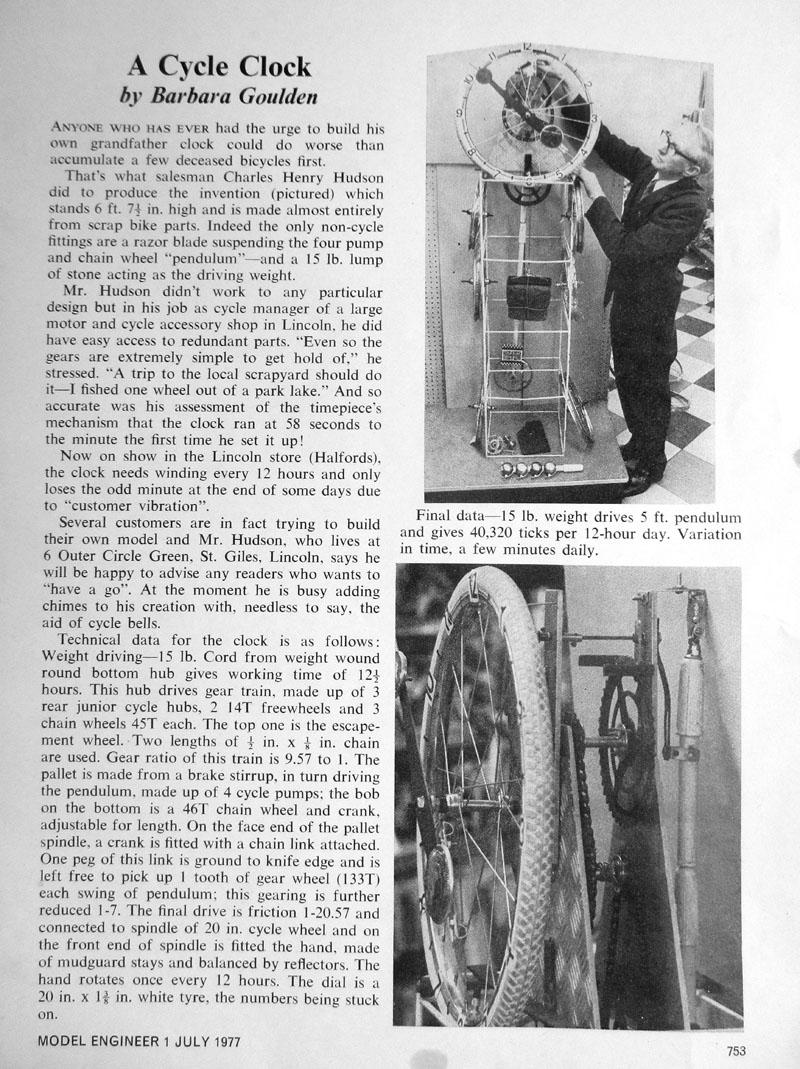

« Reply #21 on: July 12, 2017, 04:49:30 AM »
I was reading an old issue of Model Engineer magazine (1977) and came across this.
