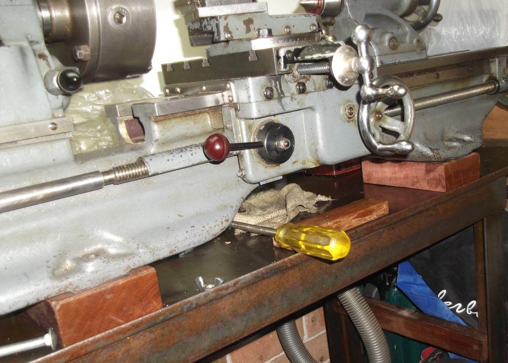

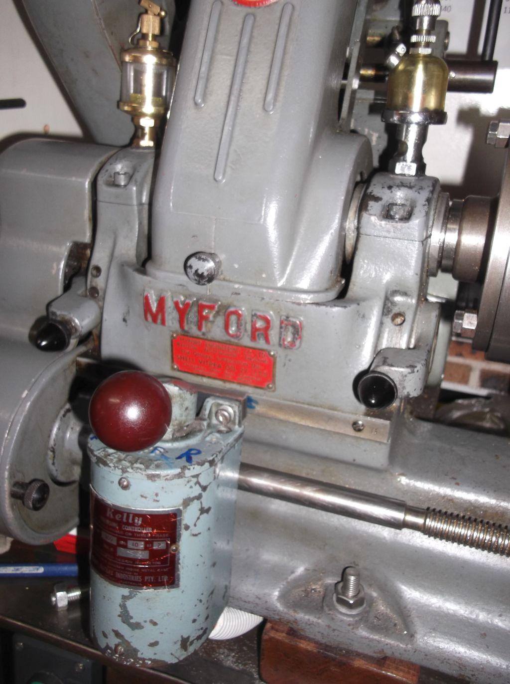

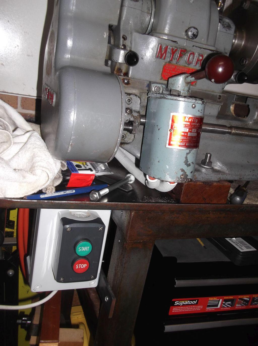

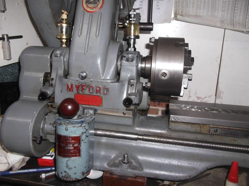

 :D I had my ML7 re-wired and reversing switch fitted recently I mounted the Dewhurst switch to casting this morning works like a dream. Two mates did the lecy work.
Here's the whole tale http://woolnwood.blogspot.com.au/2015/05/its-just-bump-to-left-and-bump-to-right.html
Oh raising blocks of Jarrah t lift it 40mm so cables could fit.
