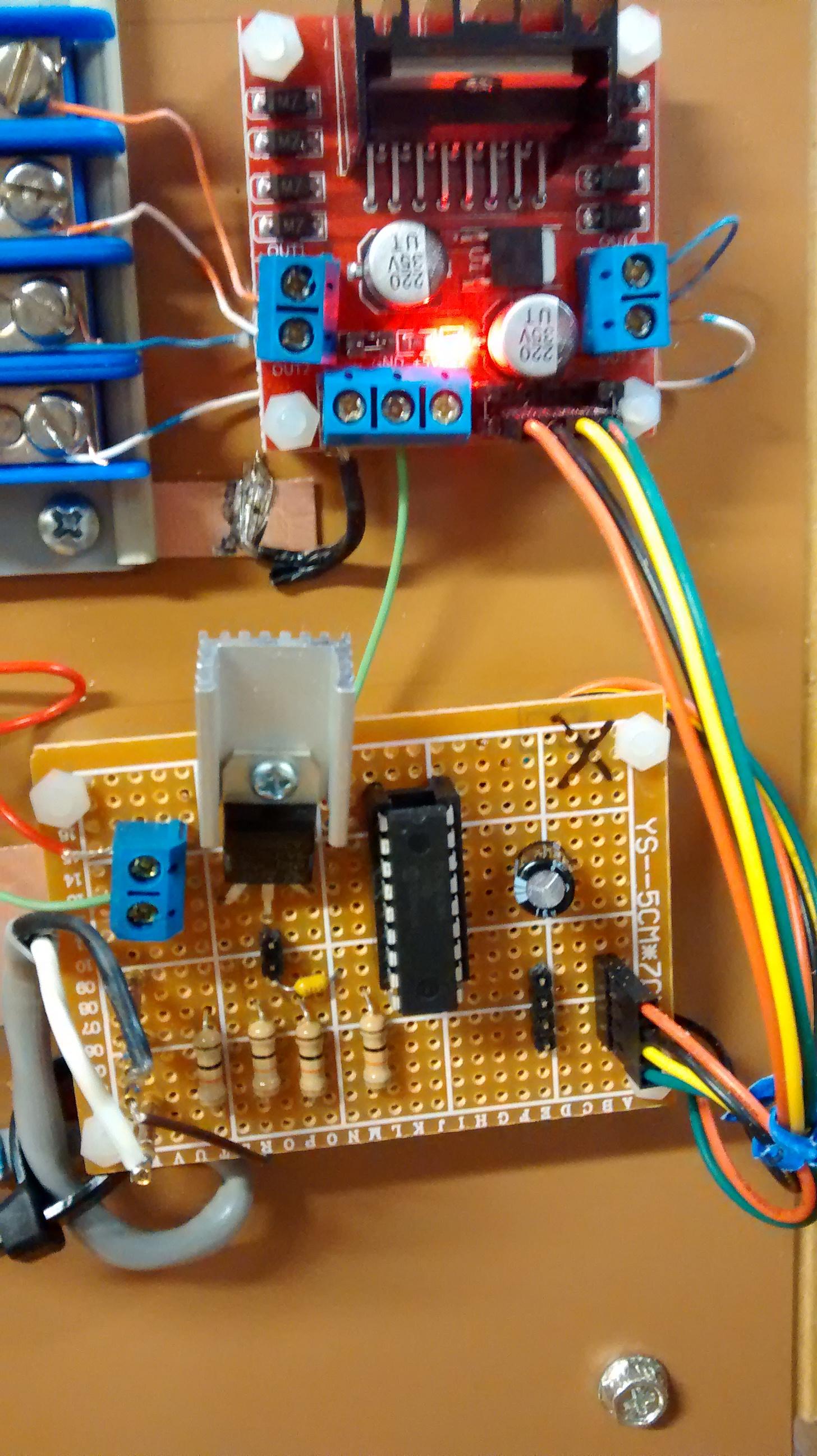

Hi,
Here's a pic of my Z-axis stepper controller and dual-h-bridge for driving a bi-polar stepper
either forwards or backwards. The step/dir in my case come from an Arduino UNO board
which has 'g-code' passed to it via USB port from a desktop.  My controller is a PIC based
'628A' 18 pin processor written in assembler. While my code doesn't need it, you can generate
a clock pulse from a rectifer from the 60hz line which is a precise 60 pulses/sec.
cheers
cheers
Great idea.... But here in the UK, mains is 50 hz.....separate osc ? Or generate in s/w?
