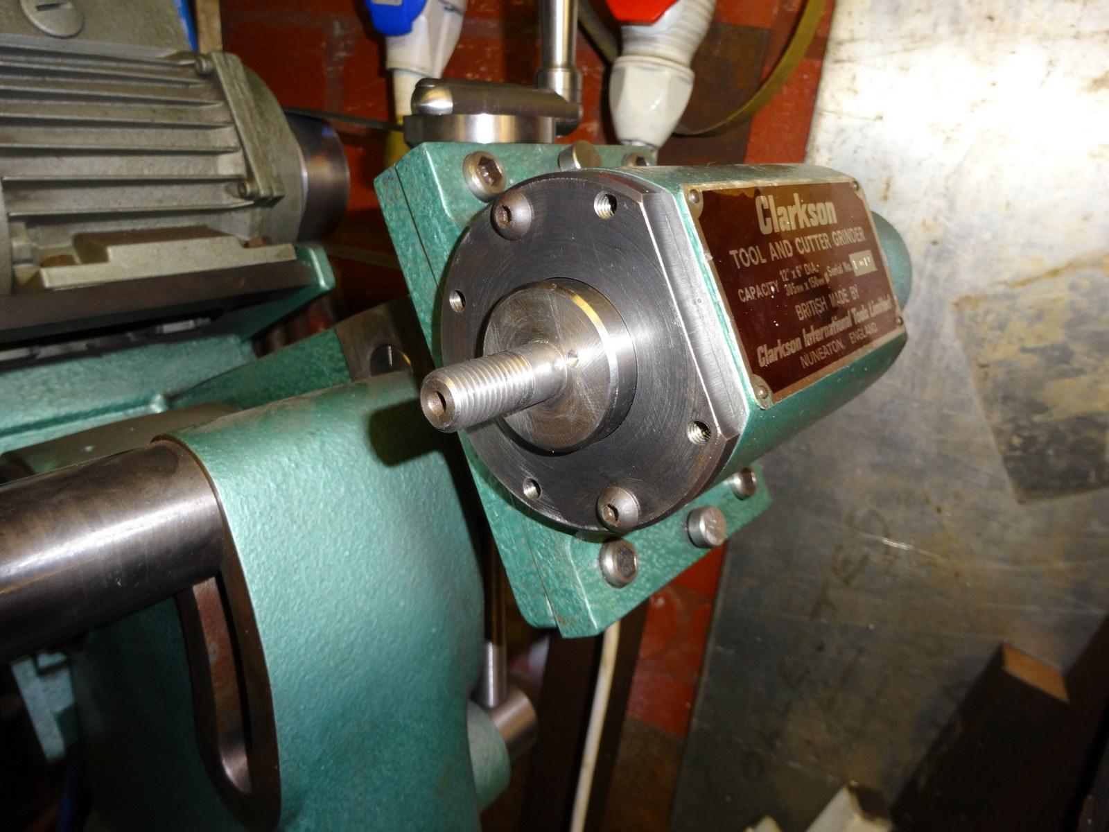

I stripped and removed all parts bolts, screws component parts,
As I split the base plate it revealed its true colour, the original grey.
Now came the hard part I removed all the dirt and grease and set about preparing the painted arears .  I've recently bought a soda blasting kit for my new project I only wish I'd got it earlier and used it for the Clarkson, would have saved a lot of time..
A new single phase motor was ordered,  I got a drive belt from ebay, a Mk2 belt guard from Machine Spares together with the attachment bolts and a new motor pulley to fit the new motor.
« Last Edit: April 21, 2015, 07:23:38 AM by ArnieB »

Thanks vtsteam it was hard work but I was pleased with the result.  I started assembling the parts, first drilling and tapping the belt guard attachment point. It was plain sailing, the motor fitted well and I was able to get correct belt tension. I rewired putting the wires through the pedestal leaving an outlet free for lighting  I had replaced the spindle bearings and it ran as good as  new.  I put a dial on the bed and got almost no runout, can't remember what exactly it was.  I managed to buy a Clarkson radius tool, and an as new 3 way 4" vice that still needs a purpose mount to the Clarkson.
As you can see been doing a bit of polishing.  I need to find a good light for it probably LED . Next will be a spindle stone guard with vacuum point and then find a pair of centres, I can't afford the price Machine Spares want, so I'll keep looking. I also have a height guage to put on.
Hope my post has been of interest  Arnie. ( I'll be back )

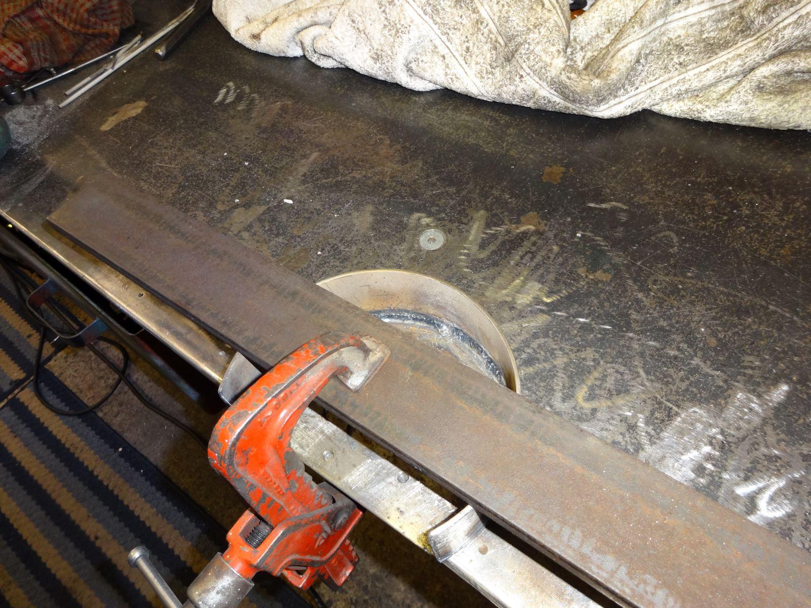

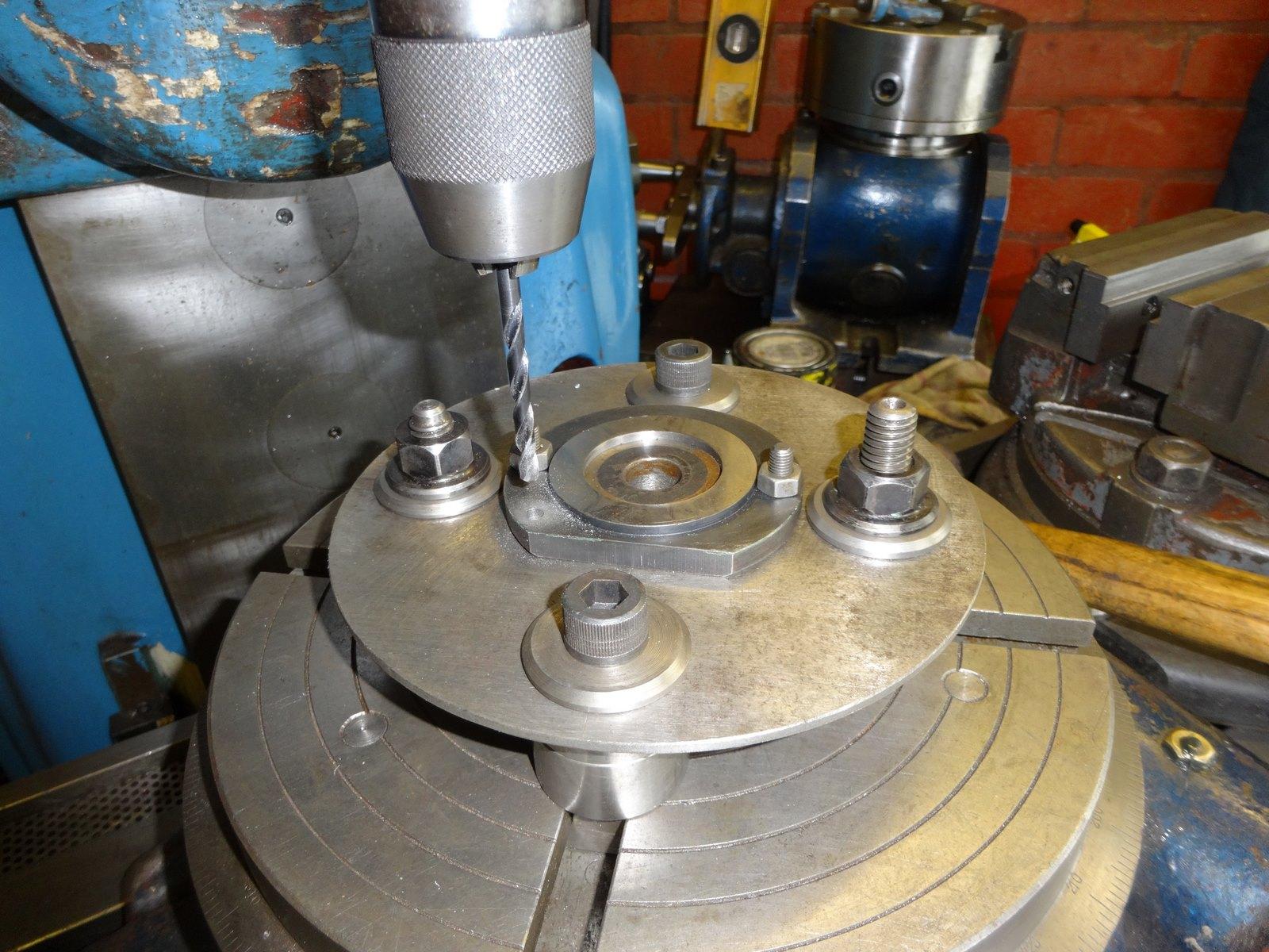

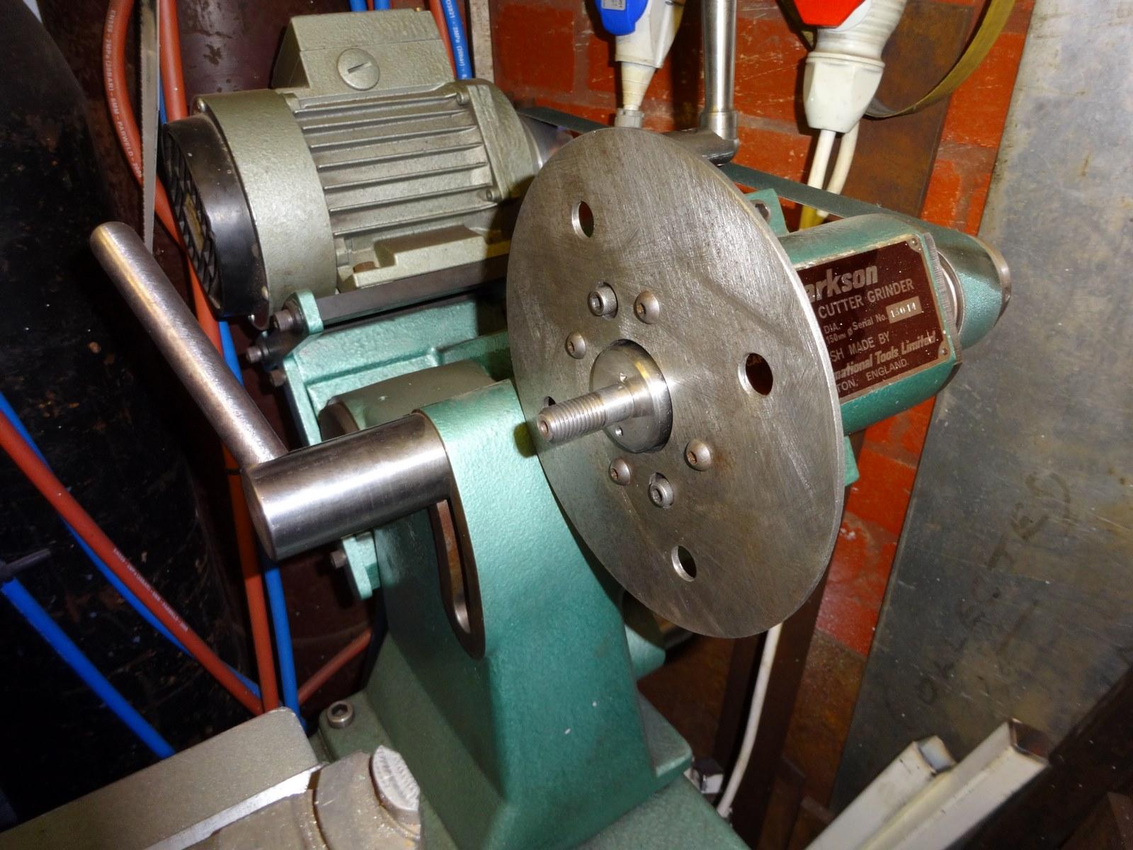

That's a job very well done, and the workmanship appreciated, as I know what it's like to try and sort one of these out..
I've had a little play with mine of late, thought it time to make a guard, especially as the size of wheel I intend to use is getting bigger..
I hope you don't mind me posting a few pics, as it might give a few ideas....
