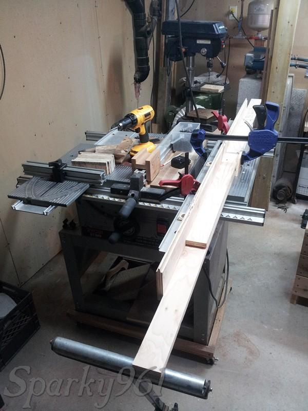

I have a long-term project on the go and the next step requires that I make a "strongback" roughly 12 feet long, with a width between 1-1/2" to just under 2" and height from 3-1/2" to just under 4".  I can deal with some imperfections over the length, say maybe 1/8" deviation over the length, but my main concern is stability.
The obvious answer is to go and buy a 12' long 2x4 at the local building centre.  Although this may be the right choice, I have reservations because the wood I've purchased in the past is practically still growing and often does all sorts of funky things after a few weeks of drying out at home.  If I were to find a really good straight piece, can the stability be ensured by painting or otherwise sealing it?
My second thought was to build a "box beam".  I can use inherently stable wood like plywood, but with a small table saw how do you ensure all your cuts are straight enough, let alone the assembly?  Working with large panels on my Ryobi BT3000 table saw (no infeed/outfeed table or extension) is very unwieldy.

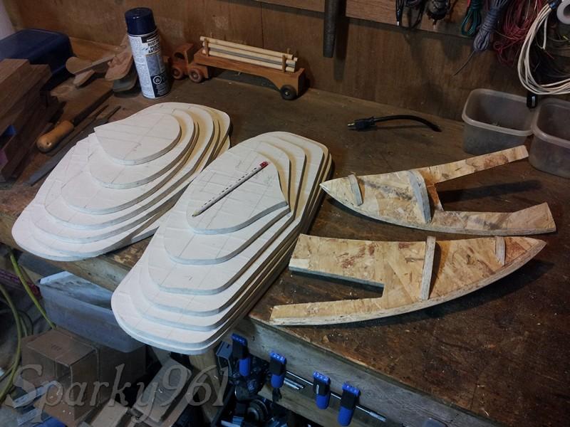

What are you making Sparky? A kayak?

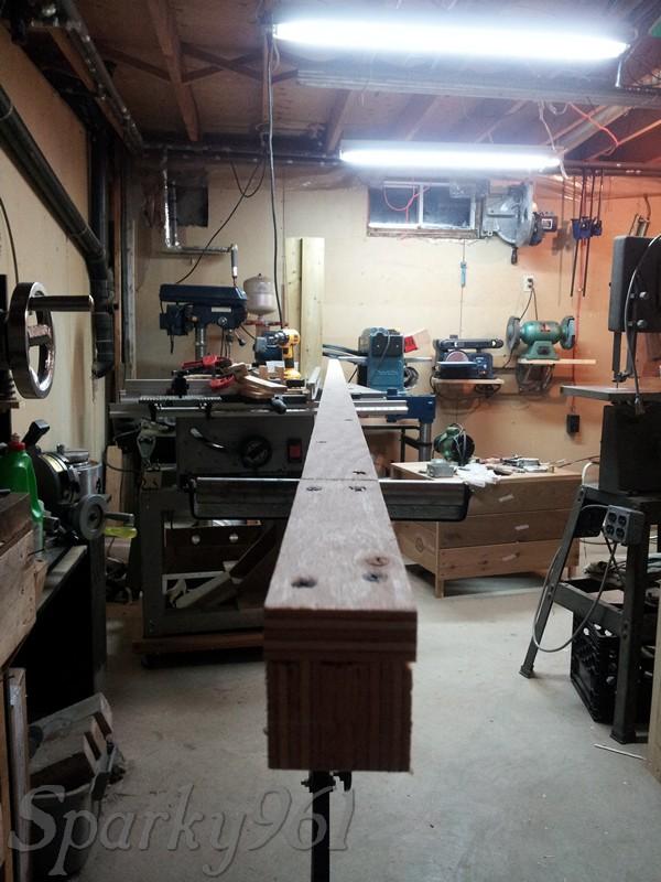

Thanks to all for your suggestions.  I think what I really needed though was a swift kick in the arse to get me off my chair and into the shop.
My worries over how accurate I could build it using tools and materials on hand were, alas, rather silly.  I ended up using some leftover plywood pieces to build a box beam.  Being already cut down to about 20 x 60" they were easier to manage than a full sheet.  Still a handful on the saw, and if they needed to be perfect this wouldn't have been the way.  I discovered that my wood glue was all dried up, so I skipped the gluing.  In hindsight, I do think this would have added appreciable rigidity to the assembly, but again - I'm calling it adequate.  I'm pretty sure that any change in moisture content of the plywood won't cause significant enough stresses to cause warping, bowing, etc.
I like your idea about using a piece of steel with furring strips on it.  It would be much more rigid than what I have now, but what I've put together seems to be alright for now.
You got your post in just as I was typing mine up, but the last picture was hinting at the application for the strongback. :)

Looks like a nice hull, Sparky. You've got a slight warp to the left. Make your mould notches wider than the strongback. Run a snapped chalk centerline down the strongback and set the centerline of the moulds on that to correct.

Indeed... sounds like you have some experience. I still need to make some stands, then carefully line everything up. Once the first strip or two is on there, nothing should move.
