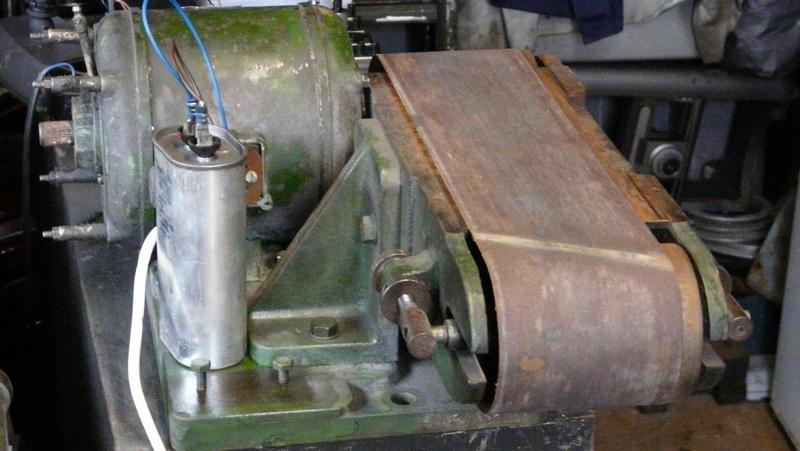

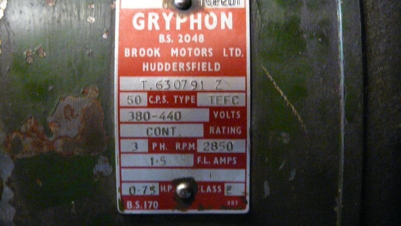

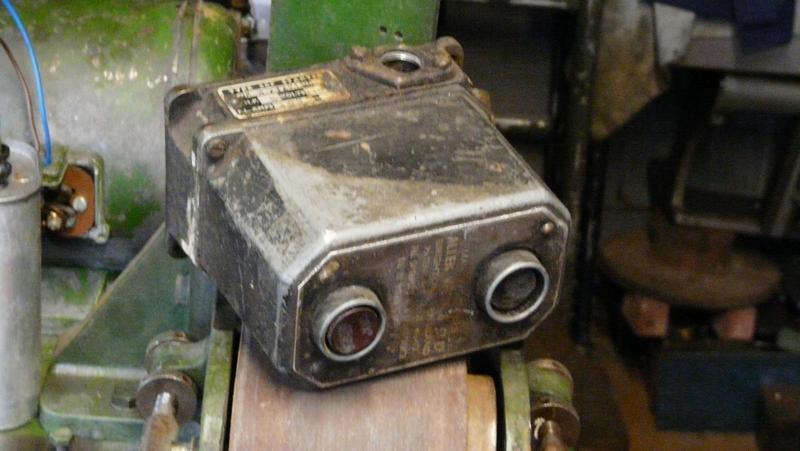

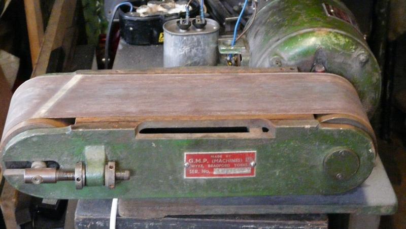

I got a linisher for £10 from the scrapman 3 phase 3\4hp , pulled it apart and rewired the motor to single phase capasitor run had to cut the coils to convert from star to delta ,  put it back together to test takes a couple of seconds to get up speed , it has one noisy bearing and needs a belt and a switch but thats all and a good clean up .

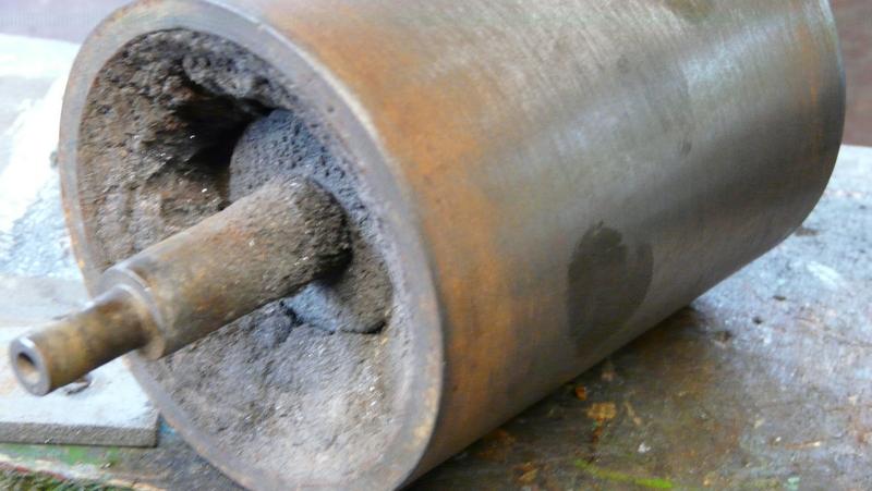

I wont be using for a while pulled apart again to clean it , if the weight is any mark of quality this weighs in at least 50 kilos .

That's a nice heavy looking one jeff. Good work!  :thumbup:  :beer:

Looks very well made, far better than modern ones so well worth restoring.

« Reply #9 on: April 05, 2015, 02:11:12 AM »
Hi Tom I used Electric motors Worshop Practice book , and had a look on utube loads of info out there just takes time , how old your motor is the newer the easer , mine was over 40 years old with only 3 terminals newer ones have 6 and links .

« Reply #10 on: April 05, 2015, 05:11:39 AM »
The formulae I read was 70uf per Kw (52uf per hp) and rated at least 1.2 x line voltage. It also needs to be continous duty type.
My machine had a 3/4hp motor so I used a 300v 40uf capacitor after swapping the leads over from star to delta. The capacitor was quite large, maybe 150-170mm long and 32-35mm dia in a metal can.
You only get up to 80% of the motors rated output but I never noticed any lack of power. Also not suitable for motors that need to start under load apparently.
