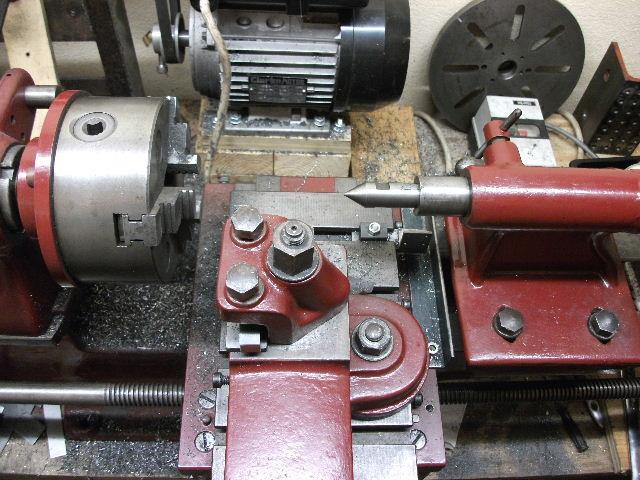

Although I've been busy doing other things recently, I managed to settle down to spending some time in the warm outhouse today. It is raining very cold water all over the garden so it seemed the best option.
Now,  as some of you will know,  I have an old lathe of unknown provenance. By the quality of the build it is obvious that it was an expensive bit of kit when it was new.
But it is quirky.  And yes,  it's red.
I'm going to note down some of the odd things as they become apparent. All those of you with (relatively) modern lathes may consider yourselves blessed.
First,  a picture. (not sure where it will appear).
Ok.
For some time I have known that the spindle nose M2 taper socket was damaged. Now was the time to do something about it.
I was watching Doubleboost's video on making a tailstock die holder and more or less followed that method.
Problem was,  as the nose socket is damaged I can't stick a centre in there to support one end of the centre I want to use to set my topslide over.
No problem, fit the three jaw and chuck up a bit of bar.  Create a 60 degree point. use that as the location for one end.
I have a centre that is wide enough at the 'big end' to fit in the hole of the tailstock without going right in,  so that was the other end sorted.
Lots of gentle tapping and the dial guage was finally reading zero over the length of the 'alignment' centre.
Great ! ready to bore out the spindle nose. Remove all the gubbings used to set up; including the chuck.
Ah....
Now you see the disadvantage of a gap bed.
With the saddle fully advanced towards the headstock and the topslide as far forward as possible on the slotted table I can't get the boring tool within three inches of the spindle nose. And that is before any cut is made.
Bugger !!  I'm going to have to make some kind of extension that bolts to the table and bolt the topslide to it.
But not today.
You can see the problem in the (earlier) picture.
For scale,  the slotted table is 5.5" from end to end.  Also note that the saddle is as far forward as it goes and the tailstock is hard up against it.
Dave :bang:

would it be worth fabricating a section of bed to fit the gap? iv seen it done for the tail end before
would take some carefull work to get it accurate but might be better in the long run?
  • Posts: 6940
Re: Red lathe woes..or 'The joy of owning a piece of history'
« Reply #2 on: April 05, 2015, 08:46:46 AM »
It can be done somewhat tediously (and carefully), with a small boring bar, and a new male taper for a test piece and some blue color -- per scraping. The compound slide angle is set by test and refinement  -- checking of the pattern of the rub. I'll probably be doing it on my lathe building thread at some point in the near future.
In general, you set the angle as close as you can get it. Then take a light cut. If testing with the blued plug shows it is hitting at the front of the cut, the angle is too fine, so tap the compound slightly to compensate. And vice versa if the rub shows it hitting at the back of the cut. You gradually "sight in" on the right angle by successive comparisons, and get to the point where it hits the tapered plug evenly whle you cut. When you have cut all the way from front to back and the taper plug contacting throughout, you're done. As in scraping, the blue is extremely sensitive.

What don't show so well in the picture (must get another one) because the chuck is fitted,  is the huge distance between the Morse taped end of the mandrel and the position of the table (and hence my tool post) even when the table is as close to the mt socket as possible.  I would need to have about eight inch of overhang on the boring tool if it was to get right inside the socket.
Many lathes have an 'H' shaped saddle. My Rufold lathe does. This,  along with the bedways going right up to the headstock (non-gap) allows one to get up close to the mandrel.
As for the procedure,  I have no problems with that. As I mentioned,  I did it before I realised I hadn't allowed for the chuck being there.
So I had my topslide all set over and ready to go.  But couldn't reach the headstock mandrel with the too.
I'll fit up something to do the job. It's not urgent.
Any way, I will be able to use the Denford when I get a PSU for it.

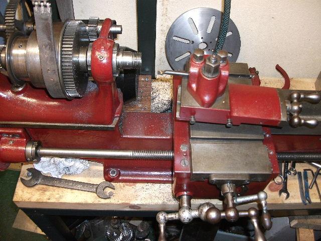

« Reply #7 on: April 20, 2015, 02:32:20 PM »
This picture gives a better impression of the problem.

David, if it was mine (and I didn't have a Morse taper reamer) I'd make up a boring bar extension out of a heavier shaft -- maybe 5/8" dia, with a hole in the end, and a setscrew to take a thinner boring bar to cut the actual taper. The extension of the smaller bar should be just over the total depth needing boring. That can be set by the depth of the hole you drill in the larger shaft.
I'd also use the largest diameter "tip" boring bar that would fit the back of the taper to be cut. You'll have to go slowly, and several passes to take up the spring of the bar(s) each turn of the carriage handle,  but you should be able to do it, given time and patience.
EDIT:
Actually if the 5/8" bar fits part way into the bore, you can make the tip extension even shorter -- just long enough to cut that part blocked to the 5/8" (or whatever you chose) bar. You could also bevel the end of the longer bar to fit further in.

I mentioned earlier that I was worried that a reamer would tend to follow the damaged hole instead of truing it up.
I think I will go for a beefy extension to hold a slim boring bar and carefully cut a new taper taking the very minimum I can out of the spindle.
If all else fails I could bore it out parallel, fit a sleeve.  Then cut a new taper in the sleeve.
  • Posts: 6940
« Reply #13 on: April 20, 2015, 10:40:53 PM »
David if you do that, you can maximize the end size of the main bar if you offset the hole in the end (from center) enough to just allow a small degree of cutting overhang with the cutting bar.
That would be just enough to keep the thicker bar centered in the taper hole while the cutting bar is cutting.
Hope what I just wrote is comprehensible!!

I realise that, but my point is that if most of the taper is fine and concentric and only the mouth of it excentric, then chances are good of truing it (I had this case). If error is big then you need to true it, I have tried similar and it was not easy to me. To the extent that I'm entertaining idea of small slender ID grinder for the final "lick". Very little, very gently.
« Reply #15 on: April 21, 2015, 04:11:38 PM »
Pekka,
I see more clearly what you mean now.
Sadly the taper appears to have been messed up by someone trying to machine it in the past.  I'll have another check with the blue before I commit myself to re machining the taper.
Believe me,  if I can get away with a very minimal skimming then that is the route I will take.

Luckily you compound looks substantial, it probably has some extra feed as you already tried it.
One daft idea came to my mind: Can you dismantle the top slide from apron and mount that on temporary mount on the gap? If your compound has enough feed you don't need any apron movement and no provision for that.
Gap bed is very useful for model engineer, specially if you have a faceplate. Those removable pieces are always a bit of compromise and I think that they are not that easy to make.
That 8" overhang is hard to work with, even if you make the tool butt end extra large, you still have that nose down tendency because cross slide support is really very far away and narow. You could try to compensate nose dive by mounting a plate with accurate top surface next to spindle like a chisel rest on wood lathe......this time it would be boring bar rest.
Some ideas, hope it is conversational piece.
