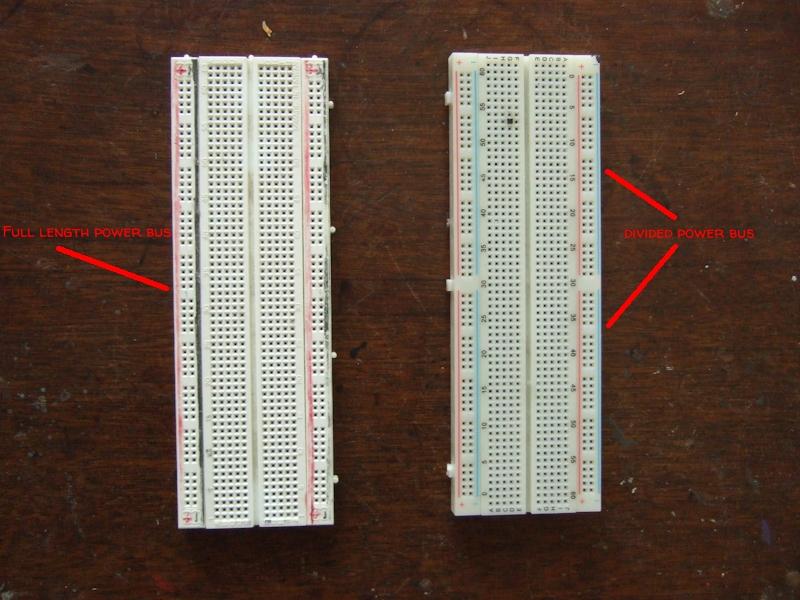

I've got a workng FORTH program now as far as reading the encoder goes, but a new fly in the ointment is that my 600 line encoder doesn't seem to work. I don't know whether its open collector outputs got damaged or not -- something the supplier warns about. I'm going to try another test before calling it dead, but that's a big disappointment. I've sent for another, since this one is way too old to inquire about a return. And maybe it got damaged in several years storage -- maybe it was a static problem.
While I'm waiting for the new encoder to arrive, I may open this one up and see if anything can be done to replace the output transistors. I'd need some advice about that from you guys if I do. Not sure what would be suitable in the box of spares.
  • Posts: 6883
Re: Electronic Leadscrew for the New Lathe
« Reply #148 on: December 28, 2020, 08:09:16 PM »
 :doh: :doh: :doh: :doh:
Problem wasn't the encoder but the breadboard. I have two of them. Apparently not quite the same, though they look the same.
The one I've used before has two sets of power busses running down the sides. The newer one interrupts both busses half way down the sides. I was using that one, thinking the busses ran all the way.
Turns out that an encoder just won't work if not connected to power! Took me an entire day to figure that out...  :wack:
Reminds me of the old IT troubleshooting litany: "Did you check to see if it's plugged in?"
