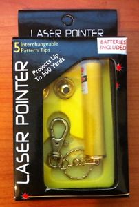

Re: Anybody build Dan Gelbart angled laser centre finder?
« Reply #27 on: April 11, 2015, 06:33:19 AM »
Hi Guys,
I just got one of these  :doh:  5mw red laser.  Its absolutely useless !
Its far too bright.  The spot is rectangular in shape.  At the distances it needs to be used at a 2.5 X 5 mm spot is far too big.
So this is one to be avoided.
I did try to measure the spot size of mine, and its about 2 mm in diameter, not quite round, it has a small flat on one side.  I think that is why I get a tiny black dot in the centre.
I'm still looking for something like the original one that I got from Aldi.
HTH
Oops forgot to add the picture.
Best Regards:
                     Baron
