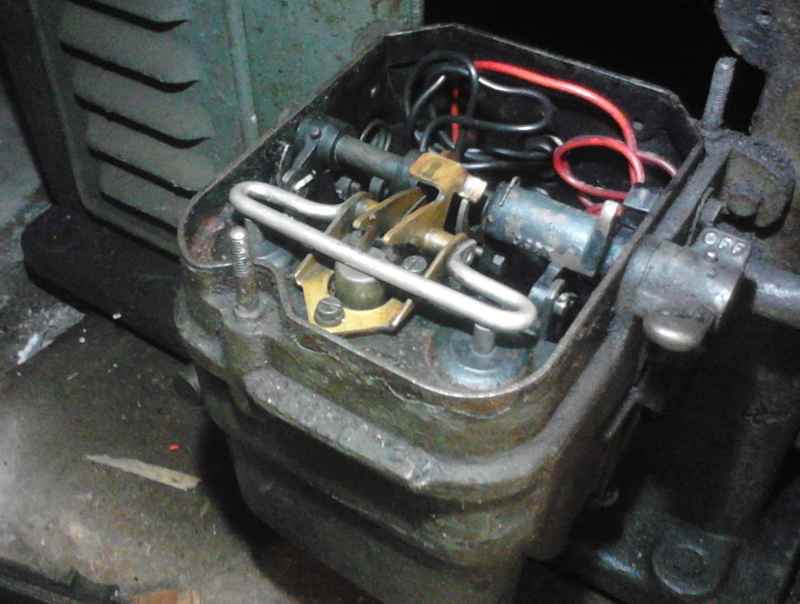

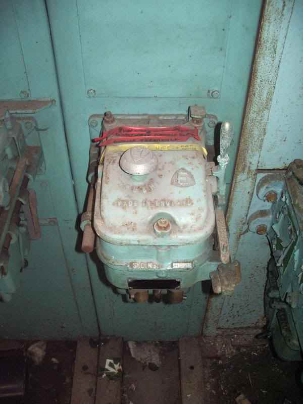

I have a friend who has a lathe which he inherited from a family business.  It's labelled as a Churchill Redman 12 inch lathe but it looks as though it would swing more than that - maybe as much as 18 inches.
It's been sat in an outbuilding for about 20 years and he hasn't got around to connecting it up.  There's a 3 phase supply in the building and he's recently had some fixed wiring done so there is now a connection box right next to the lathe.
He asked me if I'd connect it up so I went to have a look.  Connecting it looks straightforward.  The cables were cut when it was taken out so it's easy to see where it should be connected.  It appears that the earth connection might have been the flexible metal conduit.
However I was having a look to see what the rest of the wiring looked like and I have a question about the motor starter.
The starter is a cast iron object about 6 inches square and about 9 inches deep with what appears to be a detachable sump and a lid secured by 3 nuts.  The lid is cracked and it's full of oil.  It was made by a company called Ellison It's similar in appearance to the ones in the attached picture.
It looks as though there's a good chance it will work if I connect it up but I was wondering about the safety of this type of contactor.  Am I right in thinking that it's likely to be full of PCBs?
Does anyone have any advice or suggestions please?

Re: 3 Phase Motor Starters
« Reply #1 on: March 18, 2015, 02:56:14 AM »
Russell I cant open your picture as I'm on my iPad but is it possible that it is a 'star / delta' starter, and the oil is part of the delay from star to delta? I have an ancient starter on my big Shaper that uses star/delta to initially accelerate the motor but the delay there is a human one as its manual!
Offline buffalow bill
  • Posts: 86
  • Country: scotland
« Reply #2 on: March 18, 2015, 03:20:23 AM »
Russel, I cannot open your pic. but it sounds like the starter may have been immersed in oil, it could be a DOL starter (direct on line)  suitable for 1 - 2 hp motors above this size then it should be a star delta starter. Cold still be immersed in oil. The oil should be transformer oil not PCB. PCB were usually in components not sloshing about in starters.
Hope this helps.

« Reply #6 on: March 18, 2015, 07:04:08 AM »
By ek Russell
That starter is a blast from the past I serviced those during my apprentiship I now 67 so you do the maths
They are oil filled as the contacts work in the oil bath , which is transformer oil vegetable based and stinks to high heaven
As the motor is a star delta wound one I would dump that starter and fit a VFD ,not to get the over speed but give a soft start , and no I did not miss the three phase supply that is installed ,but you can get three phase in and out units , failing that get a modern star delta starter with correct over load coils , best talk to your sparks as it's difficult to advise without hand on.

If the motor has only three wires coming from it it the starter is bound to be a direct online , if it will not hold on in the run position please do not do as I have seen eons ago tie the handle up with string , it was a regular thing to find at Stanton iron works the operator would say the handle will not stay on when I use the machine it turns off so I mended it with some string ( also very common on the local farms except they used binder twine ) , all it was was the overloads tripping , but try and tell them that   :doh:
as Phil has said these were in use pre me and not common after the sixties
Unlike Phil my personal preference was not to file any copper copper contact that had a rolling motion , I found that it cause them to wear out quicker and weld up , but thats my view not to say that Phil is wrong but we were all trained with different mentors and thus have different views
you will have some difficulty in finding the oil if you need some , hope you don't just don't spill it on your shoes or clothes , you will not get rid on the stink , old Murex welders had the same oil in them ( 330 amp jobs ) and I swear they had a green haze over the tank when you craned out the transformer/switch gear they were bad

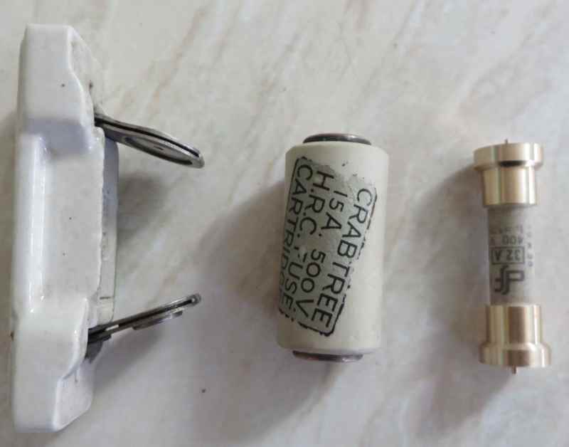

This is an update on how this has worked out so far.
The fusebox was totally obsolete and we couldn't get a new higher rated fuse.  The man in the shop said "That's so obsolete I've never even seen one".
However a little work with the lathe enabled us to use a different (physical and rating) size fuse. (Picture attached).
Safety was improved by fitting a box with RCD and single and three phase sockets (visible top right in one of the lathe pictures attached).
The starter as predicted was a bit troublesome.
I connected it all up and turned on the power - nothing happened.  This was good - no loud bangs or flashes.  The lathe lamp didn't come on - but that wasn't a surprise the bulb has been sat there 20 years or so - (although I had changed the wiring).
I tried the starter.  It buzzed and the lathe lamp came on and went off again.
I had a look in the starter and I couldn't make it latch manually.  Further investigation found a spring out of place - with that corrected it would latch manually but dropped out when the power was turned on.
Investigation with the meter showed one phase with no power.  Fortunately having uprated one fuse for the single phase circuit we had a spare fuse.  With that fitted we tried the starter and the lathe motor sprang into life - sounding exactly as it used to 20 years ago (or so I was told).
I'm not quite sure how the two live phases managed to blow the bulb as it was connected to the dead phase but they did - through motor or starter I assume.
We didn't actually try the lathe deciding it was probably better to check oil levels etc first so I still don't know if I've got the motor running in the right direction.

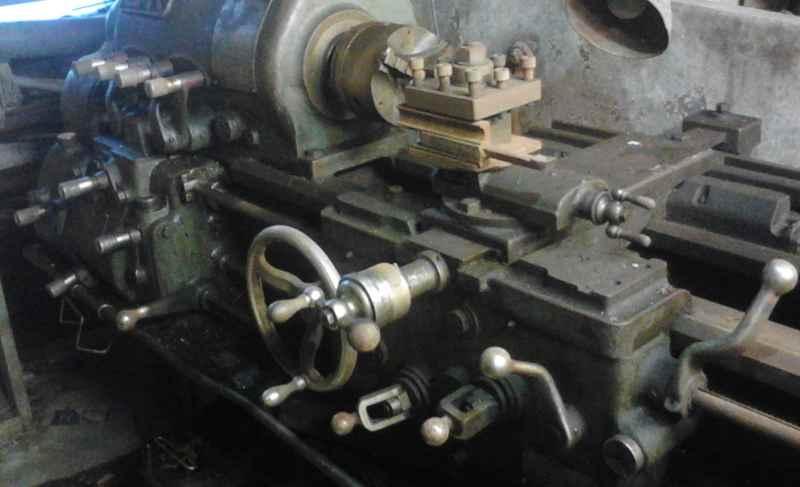

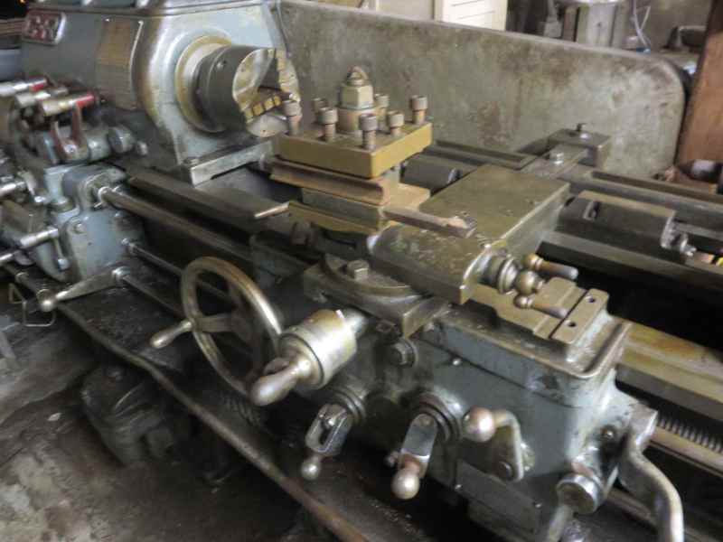

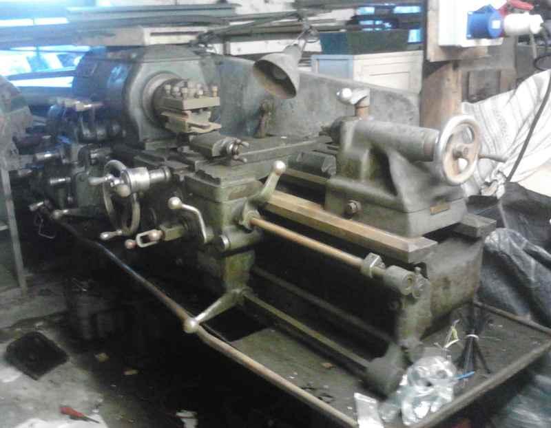

I've included a couple of pictures of the lathe for those who were interested.  It's a Churchill CR 12".

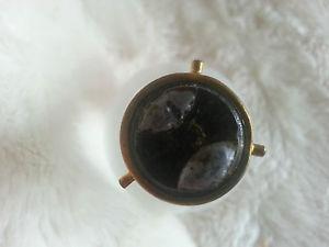

The bulb could be a 12v or 24v one running from what was known as a Lovolight machine light transformer, which is a 3 phase primary with a single phase secondary, so if two phases were present you would get a voltage of sorts at the output. Keep at it, you are making good progress!

We finally got the lathe cutting metal this week for the first time since 1991.  Not for very long and the finish wasn't very good but that was probably something to do with the bar being the first bit of scrap we could find and the tool having sat in the toolpost since 1991.
There are still a few bits to sort out, one of the gear levers is loose, the tailstock ram is seized and the belts need tensioning.  There doesn't appear to be any way of telling how much oil there is in the headstock either - although there's a hole in the filler that looks about the right size for a dipstick.  I couldn't work out what the lever on the back of the cross slide dial is for - some sort of stop I think.  It all needs a good clean too.

Lo Vo lamps I've seen used on various lathes had either
2 pin 50V  B22 baynet cap bulb ( like the 240V bulb) or
3 pin 25V B22 baynet cap bulb
you should have the option of selecting 25V or 50V for lighting

We had another go at getting the Churchill lathe and Bridgeport mill going properly.
Thanks John for the voltage info. :thumbup:  The multimeter confirmed 48V which I had deduced from your bayonet cap diagrams.
Does anybody know whether modern LED bulbs will run on 48V - they have to have a power supply to convert from 240 to whatever needed for the LED.  Will that also work with 48V?

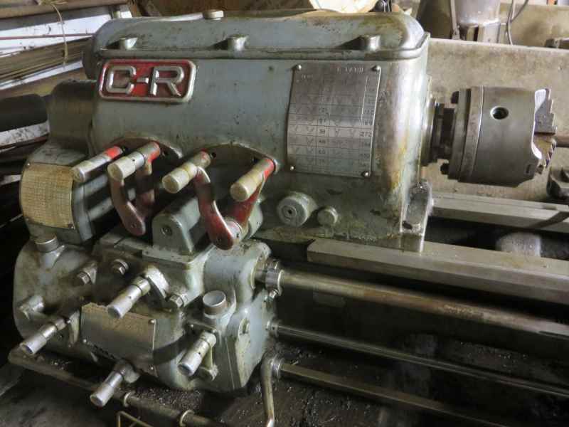

I remembered to take a camera so here are a couple of photos of the lathe.
The two issues on the lathe are the tailstock ram is seized and one of the gear levers doesn't engage properly.  We took the top off the gearbox to see what was going on.  I thought it might be as simple as a loose gear lever as the lever had a grub screw in the side.  No such luck. :( :(  The outer gear lever was held on with a taper pin, and the inner gear lever was keyed to the shaft - the grub screw was to hold it in position on the shaft.

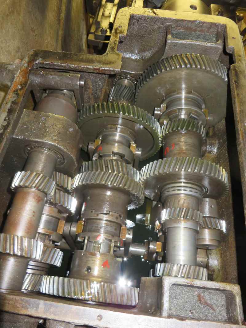

Here's a couple of pictures of the inside of the headstock.  The input is on the bottom left and output on the top right.  Can you spot the difference?  It will be revealed after the second picture.
The difference is that the dog clutch on the second intermediate shaft (bottom centre of picture) has been moved.  The problem with that is that in the first picture the lever engages with the hole on the face of the headstock and in the second picture the lever is pushed beyond the other hole on the face of the headstock.  Engaging the lever with the hole is not sufficient to engage the clutch.
After poking about for a bit we're not much wiser about what the problem is.  The paint marks suggest that someone has dismantled this before - possibly to try and solve this problem.  It seemed to me that the solution was to move the gear along the shaft toward the bottom of the picture so that the dogs didn't have to move as far - but that would mean it didn't line up properly with the gear on the previous shaft.
Does anyone have any useful suggestions.  At the moment I do have a bodge in mind to stop it jumping out of gear but a proper solution would be nice.

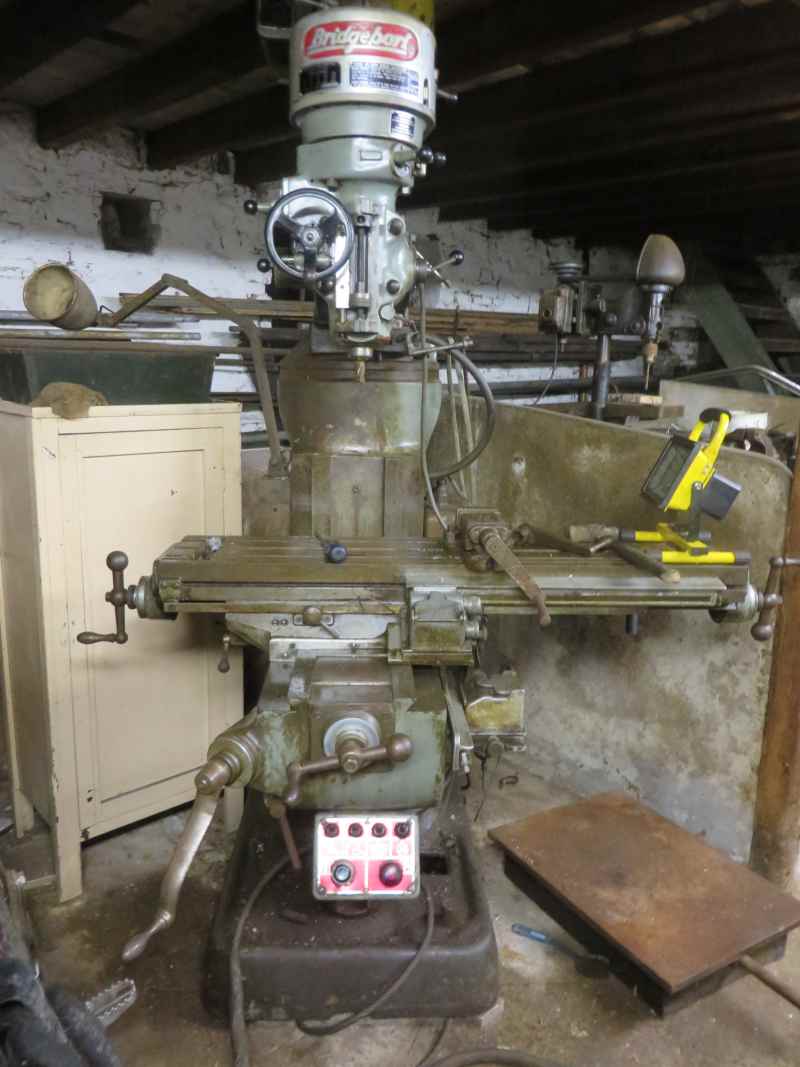

We also had a look at the milling machine.
Even with the help of a diagram we couldn't work out how to disengage the hand wheel to use the quill feed lever.  After much headscratching  :scratch: :scratch: :scratch: :scratch: :scratch: :scratch: :scratch: we realised where the lever was missing from.  Once we'd worked that out it was relatively easy.  Does anyone have the dimensions for that lever?  Most of them are quite easy to measure but it would be helpful to know the distance from the pivot to the centre of the ball.
We couldn't release the high/low speed clutch at the top of the machine.  It seems to be quite well stuck.  Does anyone have any tips for that?

Like the lathe, nice! the milling machine is a god one too! It is odd about the lathe gearbox, and on the face of it, if you are pushing the lever past the detent position to make it engage properly, something is loose. Just a thought, would a partially sheared key on the change shaft mean that the dog was going too far one way and not far enough the other? It certainly is a conundrum, Next question is can you get the selection mechanism out without taking the shafts out? If you can, all well and good. So what is going on here? are you resurrecting a disused machine shop, are you going in to business or is it just a hobby. Some general pics of the workshop would be interesting, how long did you say it was since it was last used?

I've stood wiggling the gear lever to see how much lost motion there is and there's nowhere near enough to make up for the distance it has to be pushed passed the correct position, so I'm forced to the conclusion that there must be something wrong with the position of the gears on the shaft but I can't see what.  The most likely option at the moment is to get it all working and make a suitable wedge for the gear lever - then if the problem gets worse maybe it'll be easier to see what's wrong.
