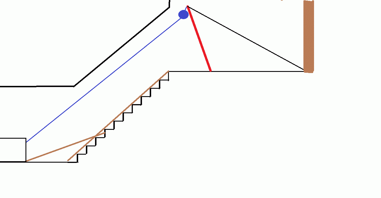

up the stairs :-  short 2 legged A frame at the top, leaning towards the slope. a chain coming from the apex and anchored to a heavy vehicle as a third "leg"  to stop it falling over. then just simply chain block the items up the stairs and onto flat ground.
go slowly and don't skimp on the lifting gear, you can never have to many ropes, chains shackles etc
Not too short,  they need to be high enough, and far enough back from the edge, that when the machine reaches the top it is past the point of balance so that relaxing the line will lower it onto the horizontal position.

I'll sketch up something when I get home, but I was suggesting using the frame to drag things up the stairs, not as a straight lift. I didforget to mention scaffold planks on the stairs will be required though.
It will be a lot easier winching from a frame as you'll be part lifting/part dragging rather then purely dragging things with a winch on its own, but either will work
Tarmac can be rather soft once you put point loads on it so spread any loads with a nice big foot

« Reply #13 on: March 10, 2015, 12:59:36 PM »
as promised one pic of proposed set up :)
as long as everything is sturdy with no chance of breaking or moving then there shouldn't be any problems

A 2 legged frame is good but you must consider what happens when you get that heavy machine to the top!   Of course you also have to allow for the space required for the winch/chain block/pulley wheel.  You need to be able to get the load past the point of balance across the threshold so that it can be lowered into a horizontal position  (yes, I did mention that before didnt ! ! :med:)
Sounds good, it will protect the tarmac, except that if the angle / coefficient of friction is wrong the bottom of the A-frame is likely to suddenly accelerate towards the winch; mayhem ensues. The bottom of the A-frame legs need to be properly anchored like the other parts of the lifting system - not put on skids!

A few days ago I was asked if I could lift and move a large stone, so I have been thinking about these things. Your sketch for winching up stairs will work, but pay good regard to all the safety issues. You need a second rope/ chain as a safety on the stair lift, anchor it well back behind the bipod and take up slack , keep it taught. I would go for it but it needs planning and good ropes and chains.
