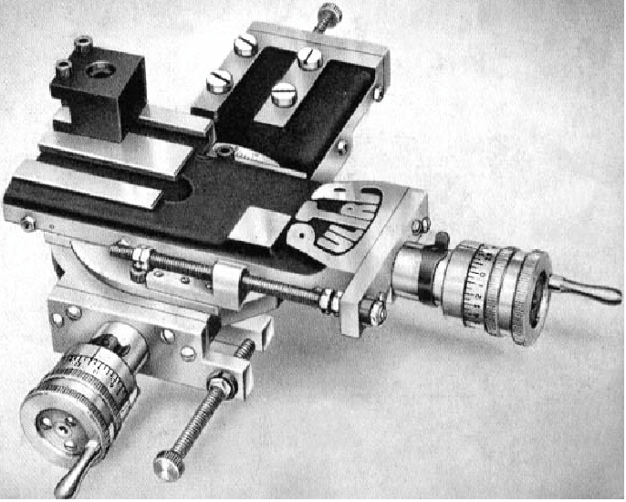

That is a nice lathe! I've got a bookmarks folder of various tiny lathes i'd say I look at once every couple weeks, and that's one of them.
My personal favorite are the Pultra lathes. I keep forgetting they're English made. Something about them feels French to me. The French are good at being just that little bit weird, but in a very appealing way.
http://www.lathes.co.uk/pultra1750photoessay/
http://www.lathes.co.uk/pultra/img52.gif
