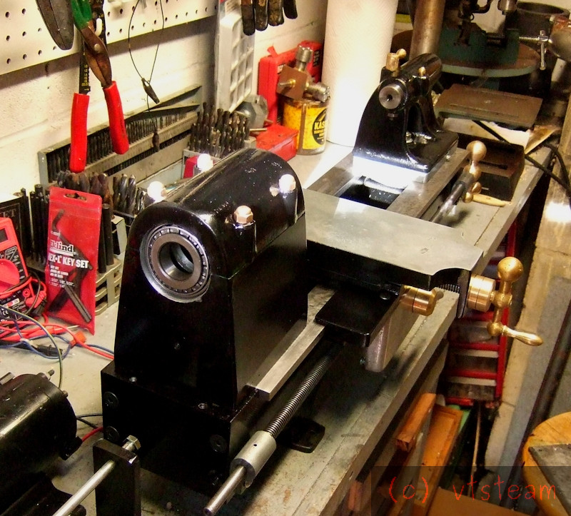

Well Finally! I got it done.   :med:   Bearing fit test:

« Reply #509 on: June 20, 2018, 06:52:30 PM »
Bravo!!  With the paint, it looks like a professional job!
I am curious though; do you plan for any bearing covers to keep swarf out?
Sent from my SM-G950U using Tapatalk
  • Posts: 6856
Re: Building a New Lathe
« Reply #510 on: June 20, 2018, 06:57:47 PM »
Yup, bearing covers, BUT I'M NOT BORING THEIR RECESSES ON THE LATHE WITH A 24" LONG BORING BAR AND HSS TOOLS!! :bang:  :bang:  :bang:
I'm going to use my mill, and a brand new genuine carbide tipped boring head I received in the mail!  :med: .
 :ddb: :ddb: :ddb:

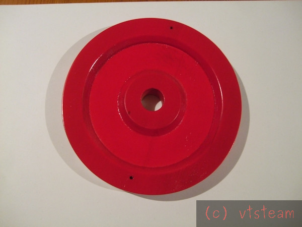

I'm going to try casting today between rains, if I can. This morning I found an older driver pulley pattern and turned up a new steel core for the driven pulley. These will stay in the mold. The tapered ends allow easier positioning.

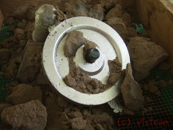

The sun came out for a bit, so I quickly rammed up a mold a melted a pot full of aluminum. It took a false cope and smoking the core piece over a candle, but otherwise a pretty simple job. Here's the shake out:

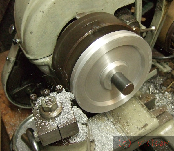

After cleaning up both sides, boring for an arbor and adding a setscrew, turning the blank down to the needed 5.684" on the Craftsman lathe.

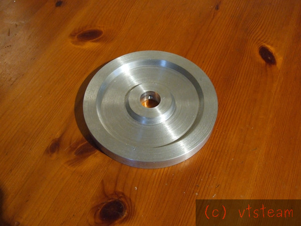

The finsihed pulley blank, ready for toothing, and then final boring to fit the spindle.
