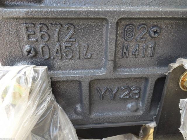

Incidentally, talking of loose bits in patterns, how do you like this Perkins 2 cylinder digger engine casting where they have obviously screwed a plate on the pattern for variable information, giving perfect impressions of the screw heads  :lol:
