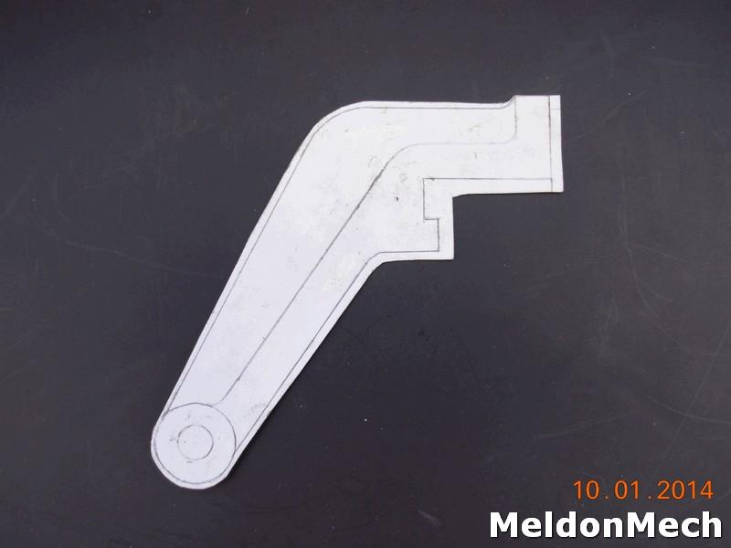

                I had previously fabricated a saddle stop for my Raglan 5inch Lathe, which performed perfectly, however every time I looked at it didn't fit in with the rest of the lathe. It reminded me of that piece of wallpaper where the pattern didn't match up properly. No one notices it, but you know its there and every time you sit down your eyes are drawn to it.
      Decided to cast a new one that was as near as possible to the original. Out came the drawing board and a sketch was prepared.

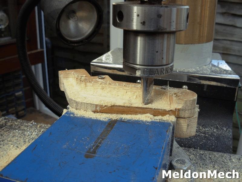

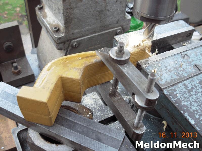

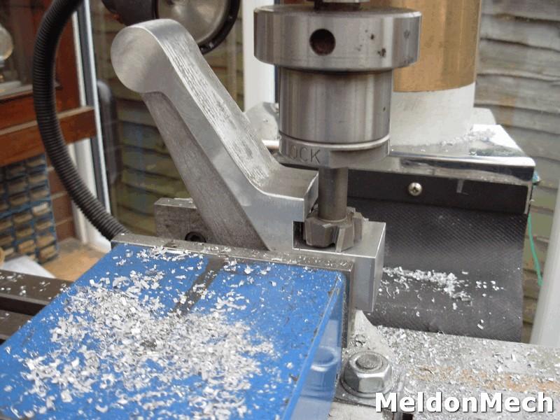

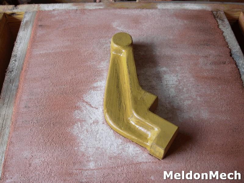

  A pattern was then required. In the past I swore I would in future only use hardwood for pattern making, so it was off to the garage to select the hard wood. I found every size possible that I didn't want, and came away with a piece of old pine, and realized I was in for a struggle. I milled out the rough shape, sanded and shellaced the pattern, unfortunately this raised the grain, and required several more treatments.
           Next I went on the net to view pics. of the stop, and discovered the item was tapered from top to bottom viewed from the front. Back to the mill to apply taper to the pattern.
« Last Edit: March 09, 2015, 06:27:18 AM by Meldonmech »

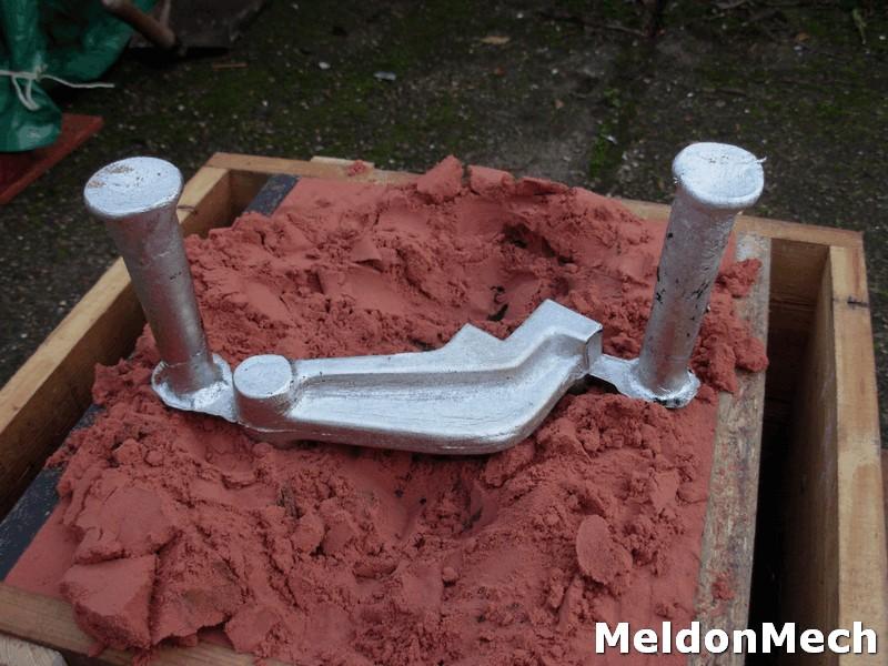

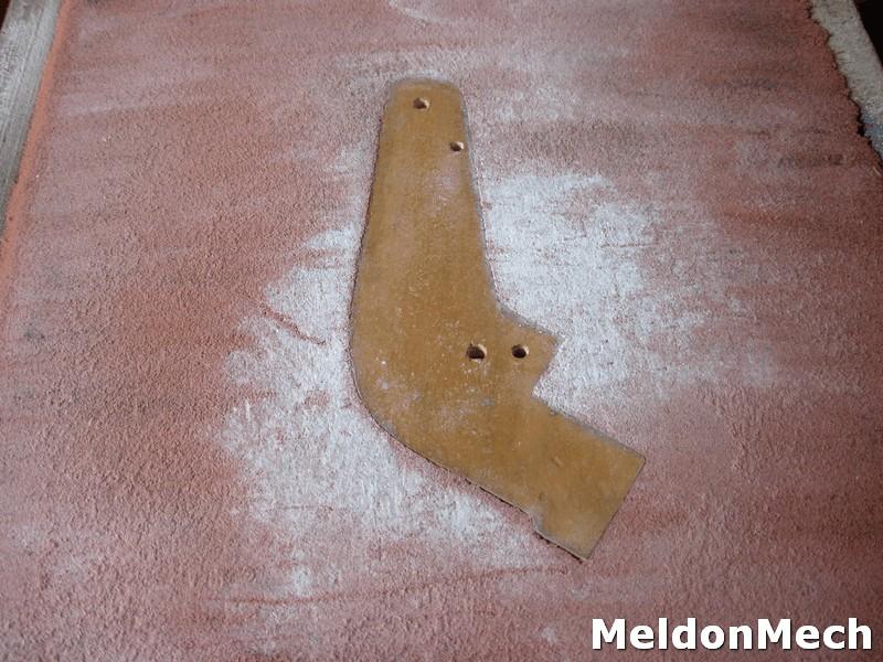

The pattern was parted, and pegs and holes made to locate the top and bottom halves together.  The mould was made up using new facing sand, and the casting poured.
Re: Casting a Saddle Stop
« Reply #3 on: March 09, 2015, 05:12:09 AM »
    The casting turned out well with no surface blemishes.

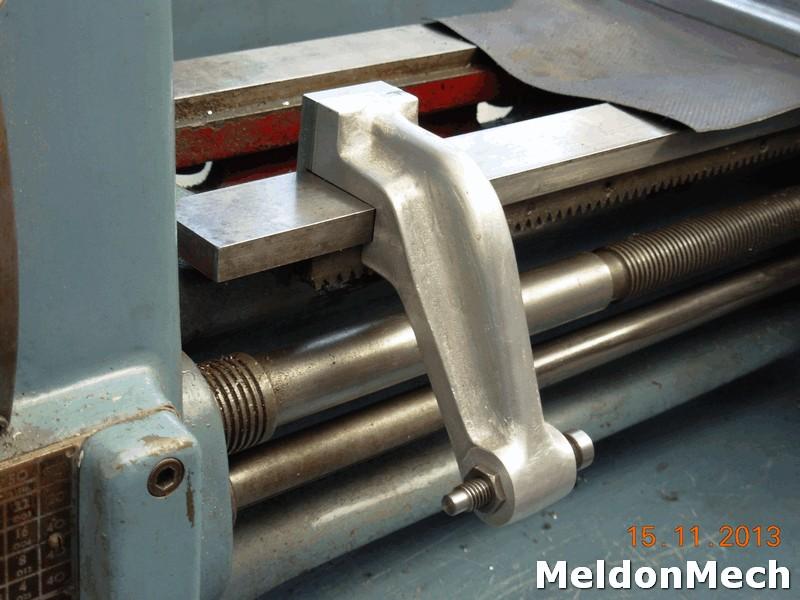

« Reply #4 on: March 09, 2015, 05:15:04 AM »
  The casting was fettled and then machined

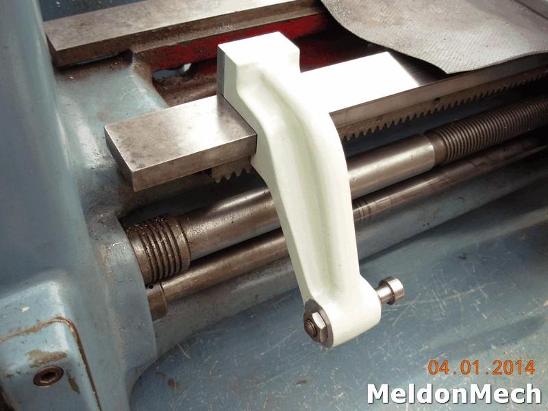

« Reply #5 on: March 09, 2015, 05:21:14 AM »

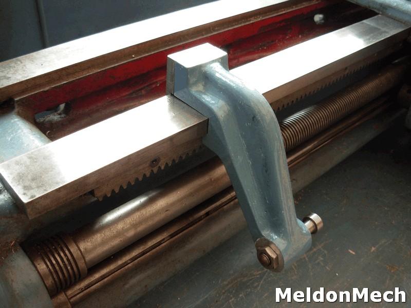

    The stop was then given two undercoats and a top coat of paint to match the lathe. I was quite pleased with the results and can now look at the lathe with satisfaction.

Does the screw knock the automatic feed off?
Cheers.
« Reply #8 on: March 09, 2015, 06:23:50 AM »
  Phil, yes the screw does knock off the automatic feed, and is very positive.
                                                           Cheers David

« Reply #16 on: March 09, 2015, 12:49:06 PM »
 Hi Pekka, there is a push rod in the apron, which engages with the bolt in the saddle stop. When this rod is depressed it releases the apron feed mechanism, and the saddle stops.
