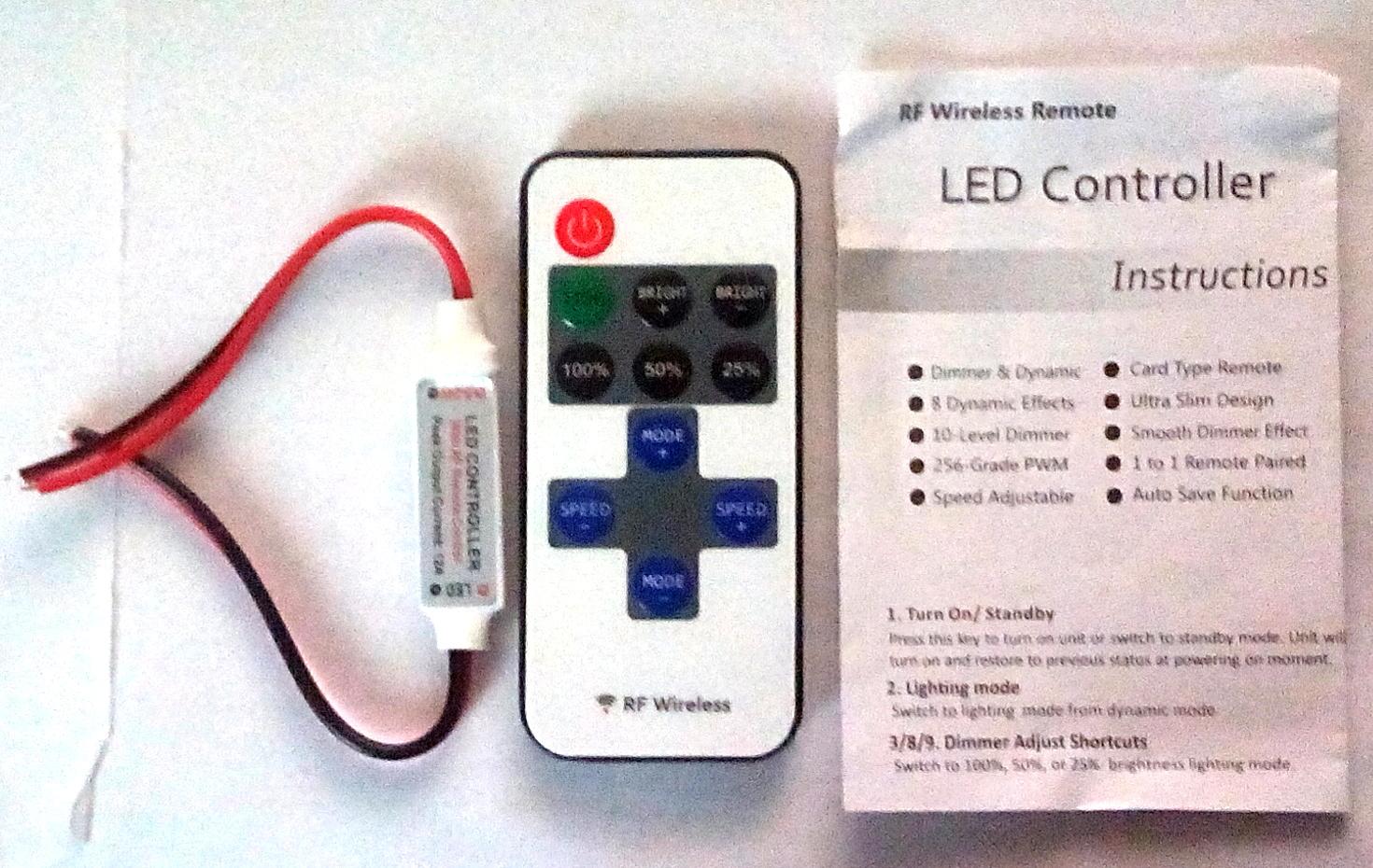

hi
The first and most frivolous part of the lighting parts has arrived - A wireless on/off remote dimmer - for the princely sum of £1.69 delivered. Its rated at 12A so I can control two strips together. Will likely buy more remotes and control them with just one controller. Operates at 433.92 MHz.
Best Regards
picclock

« Reply #25 on: April 29, 2015, 09:36:44 AM »
That would be the first thing I'd lose in my 6 x 8 foot shop!  :Doh: :lol:

« Reply #26 on: May 04, 2015, 02:18:11 AM »
Planning on Velcro ing it to the wall - I'd like to stick a magnet to it and attach it anywhere but it would quickly disappear.
Picclock
