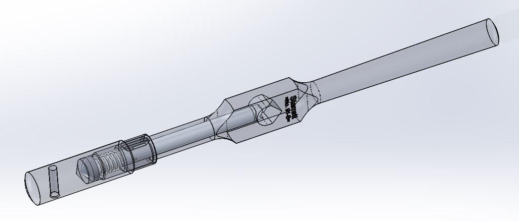

Well go figure... turns out Starrett has solid models and 2D dimensional drawings of many/most/all of their tools available online for download.
I downloaded this one and it even shows the internals of the tool.  It's similar to the mechanism I figured they'd use but they do it a bit different than I imagined.
