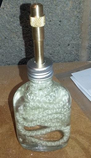

I had read somewhere not to use meths because it produces more moisture and does not burn so hot.
I had not seen the bio-ethanol before. Would this be better than Isopropanol 99.9%?
Isopropanol would have other uses in addition to being a fuel (Cleaning PCBs etc).
I had not thought of using stove rope.
Thanks.
Ian.
See above.......
Isopropanol/ bio-ethanol....... I dunno!
All I can suggest, is to buy a bottle of one of them. To establish a benchmark.
Then, over time, you can try others. To decide, what suits you, and your engines........
Stove rope, is made of glass fibre. It doesn't burn away, but it is loosely woven, and unravels at it's cut end.
I use a smaller diameter, with the cut ends bound with a couple of turns of copper wire.
Then  install it as a loop, with the ends inside the tank......

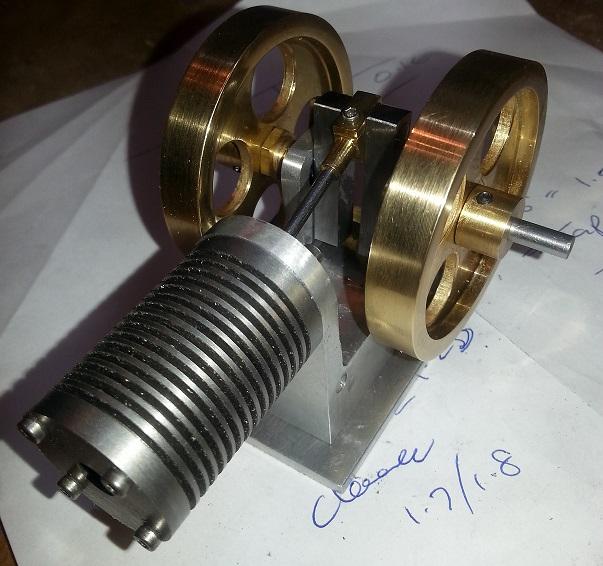

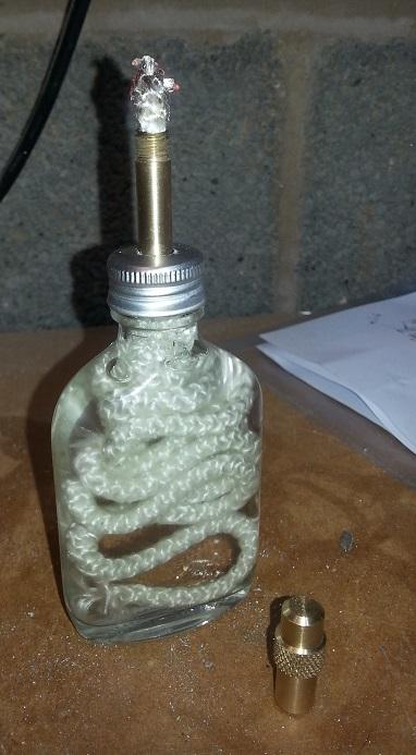

« Reply #58 on: January 25, 2015, 03:32:23 PM »
A bit more work with a saw and a file on the standard.
If the engine runs I will polish it up, but for now I need to move on.
Put together the parts so far.
If I spin the flywheels they will turn for 15 seconds before stopping.
Is this acceptable of should I be expecting better?
Unfortunately there the crank now looks to be a little off true, causing one flywheel to wobble a bit.
I will continue with it for now
I also made up a temporary burner for trial purposes.
Re: Poppin Engine build.
« Reply #59 on: January 25, 2015, 05:43:39 PM »
Ian.
I guess, you haven't made the valve mechanism, as yet.
Even without it. A 15 seconds spin, is fantastic!  :bugeye:
With, the valve mech in place. 15 turns would be good......
I think, you're a bit enthusiastic with the spare wick!
Only need sufficient, to loop once, around the base of the tank. Save some for another day.......  :thumbup:
Looking good. Shaping up well!  :clap: :clap:

« Reply #64 on: February 21, 2015, 02:35:38 PM »
Disaster looming!
Not much done the last couple of weeks as it has been too cold in the garage.
Had a look at it today and noticed the threads tapped into the cylinder to attach it to the standard appear to be breaking up. The bolts that were originally all a good tight fit are now very lose.
I have been very careful not to overtighten the bolts so am not sure the cause.
The plans call for an imperial thread, but I used metric. Maybe the thread is too fine to hold in cast iron?
It is happening on all 4 tapped holes.
I can not drill out and go up a thread size as there is not enough metal, so need another solution.
I thought maybe rather than using bolts, I threadlock some studs in, but suspect that threadlock may not withstand the heat.
Anyone else with any suggestions as to why this has happened, and the best way I could overcome it? I really do not want to have to build the cylinder and piston again, especially as I do not know how to avoid the same thing happening again.
« Reply #65 on: February 21, 2015, 04:07:51 PM »
Oh bugga, Ian.  :palm:
I would go with the stud and threadlock idea, to stabilise the remaining threads.
I have used Loctite 270, for many years.
Even for steam engine (exhaust) pipe joints, and hot air engine displacers. Never had a failure........  :thumbup:

Offline ian_in_the_midlands
  • Posts: 65
« Reply #69 on: February 21, 2015, 05:31:07 PM »
What sort of temperatures is the cylinder likely to reach?
« Reply #70 on: February 21, 2015, 05:33:24 PM »
Relevant graphs are on page 2
http://www.farnell.com/datasheets/22660.pdf
They quote 250 deg C as the temperature to raise it to to break the joint
You are quite correct, Andrew!  :thumbup:
But, I would be happy to use, what I have always used. In this small, lightly stressed application........
« Reply #71 on: February 21, 2015, 05:35:20 PM »
At the standard end. Not much, above the temp of boiling water. If at all.......
