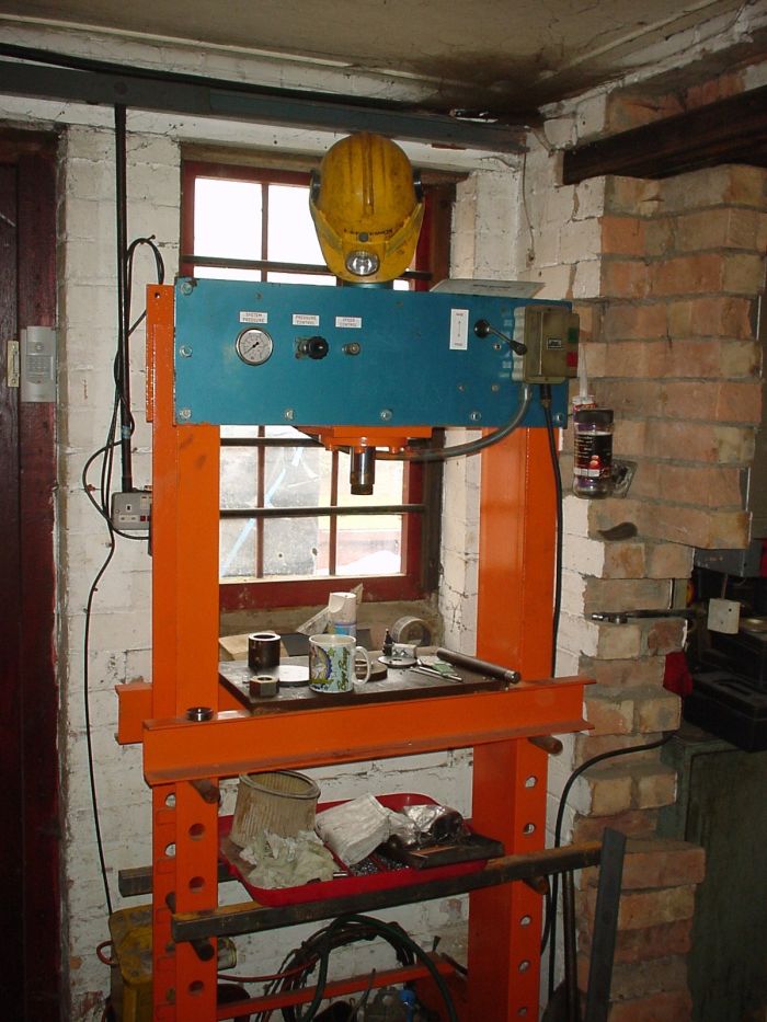

This is my hydraulic broaching press.
It has 18" of travel and rated for 10 tonnes but never used anywhere near this pressure. If the gauge jumps above 3,00 you have problems, usually the broach has tipped and is trying to take too deeper cut. When broaching you always need to back off every couple of inches and let the work and broach come free of the ram to stop this tipping. Nice press but slow, it takes as long to return for the next pass as it does to push thru. I tend to use this on 12mm and above broaches.

I'll have a look to see if I have any old photo's of the press with both types fitted but I don't think I will be lucky.
Basically it was a normal hydraulic press like many people build but had a rack to one side of the cylinder with the pinion behind it so you were pulling towards you. The operation was a simple capstan with 4 holes in it and you just kept moving the lever from hole to hole.
A ratchet would have been better but it sufficed at the time.

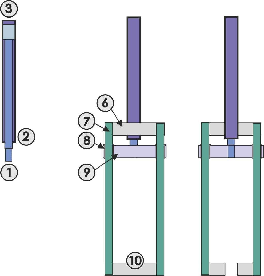

I have been doodling some stuff and basic layout is coming out on these lines:
Standard 25/40/400 mm double acting hydraulic cylinder, bought without any mounts/clevises
1) Rod end: Straight (to be pinned) or boss/thread or internal M12 thread
2) Split clamping at front end, cylinder "plain" without any provisions.
3) No clevis or mount on cylinder body.
part (9) is a slide that hopefully prevents the cylinder from bucling. It runs on plastic bushes (8) on drawn steel rods (7). Looks like 25 mm dia is plenty, even with threaded ends.
Re: Small (broach) press. Hydraulic or mechanical?
« Reply #21 on: March 05, 2015, 05:21:29 AM »
Split clamp is not going to work.
For every force there is an opposite so if you are pressing 10 tonnes then 10 tonnes is trying to push your cylinder out of the clamp.
« Reply #22 on: March 05, 2015, 06:22:40 AM »
Jep, it's going to be 2-3 tones and there will we a little feature (I don't have a foggiest idea how it is called....sort of part of a flange) that will take the force. Clamp will just keep it there. I was thinkking a thread but realized that my steady is not big enough for it and and it won't fit trough the spindle.

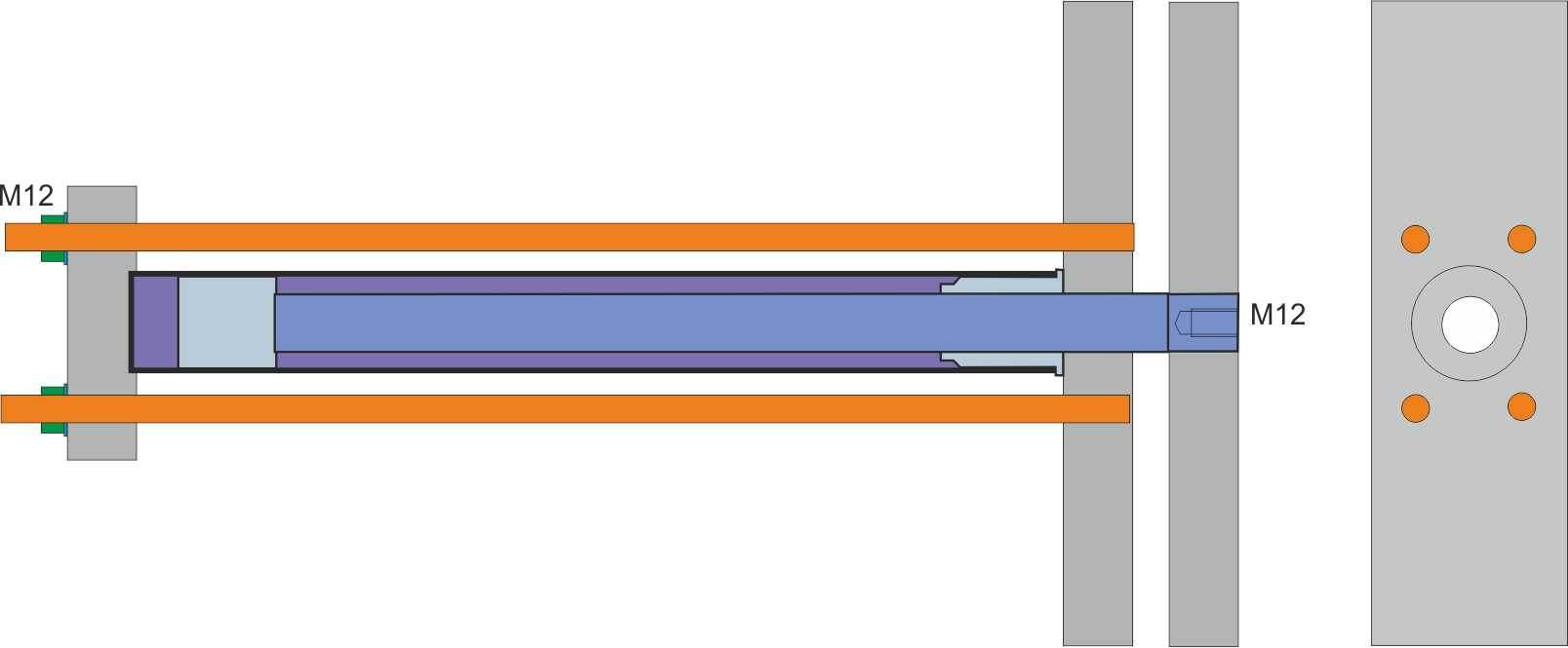

My initial idea was to make a boss between cylinder tube and cylinder head. My friend calculated that 5 mm thick piece would do, but it needs more depth just outside of the tube to keep it rigid. MFG guy did not like, I should machine that "thickness" of the cylinder head to make the O-rings work between the cylinder tube and head.
Plan B: use all thread as a tie bars and put the whole cylinder on compression. See doodle.
« Reply #24 on: March 10, 2015, 08:48:46 AM »
Plan B looks good.

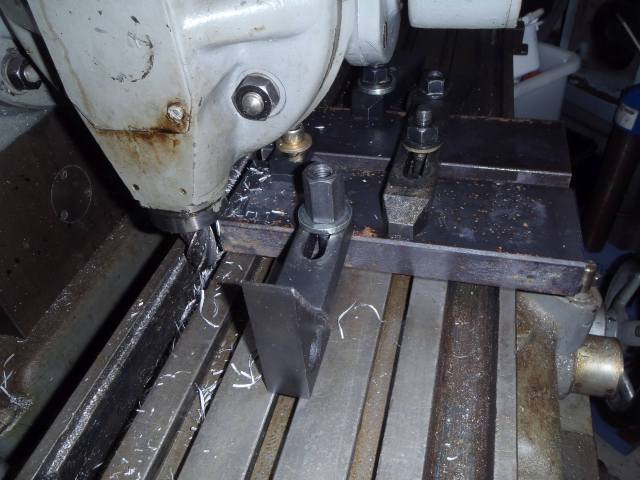

Little progress here. I have been bying every nut and bolt only as I need and not rushed oout all that I think I might need :D
Good news: Less money spent.
Bad news: Everytime I start working on it I figure that I need one extra dimension on part I don't have and tools I though I had or have capacity falling just 1-2mm short...therefore, most of stuff is being made with plan B!
80*20 mm HRS does to fit into 80 mm vise.

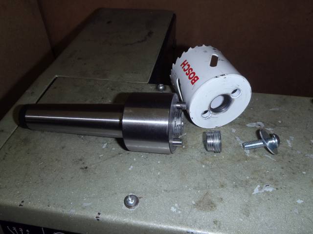

My trusty russian boring head stops to 47 mm, just short of 50+ needed, I'll try holesaw to it, because not that good accuracy is needed, just clearance.
I have idea how to put three holes (each part) on same line on four parts. Only two parts are same size, other two are unique. I'm thinkking of using the largest piece as a jig and finishing it last.

Hi Pekka,
I don't know about Finland, but here in the U.S. it is usually less expensive to buy a box of 100 screws, dowel pins, etc. than it is to buy 10-20 a piece at a time.  Then you have the extras the next time you want some...
You could make an boring bar insert that is (say) 2mm broader than the ones that came with your boring head.  ???
As to the last, you can line bore the two that are the same size and then use them to dial in hole locations on your other two odd parts.  The other way to accomplish this is with tooling buttons that are positioned using parallels and gauge blocks to assure accuracy of position.  In essence, a tooling button is a piece of round steel that is drilled out to be somewhat larger than a (relatively) small screw.  You then drill and tap for the screw, insert it through the (now tubular) round bar, and adjust the position using parallels and gauge blocks before the final tightening of the screw.  [Button Head Socket Cap Screws tend to work the best.]  You then dial in on each button in turn.
Hopefully, some of this will help you...

I considered line boring, but these will not fit into my small lathe and my big lathe (old junk revolver missing the capstan assy and tail stock) would need some little additions. Two pieces are 240*80*30 mm, one 25,00 hole in the middle and two 16H7 holes on both sides. All on on the central line. I'll give some more consideration to your text. Buttons....maybe this is the time to make some, so far I have used bearing rings. I think I don't actually need that accurate here, but it might be a good excercise.
I was thinking of drilling them individually way undersize, drill central hole tight for a dowel that will align them all centrally. Stack three critical ones together, dowel pin on the centre should keep them aligned. Mark orientation on each piece. Drill the whole stack a little undersize and then use hand reamer on critical holes (on the sides). Then take that stack apart, use two holes to align the pieces and bore the central hole clearance.
Would this work?
The Boring bar has enclosed cylindrical slide and boring bar moves in a slot milled to boring head. This slot limits the movement and should make a cranked boring bar to it....I rather build or buy different design for another boring head, but that will "some day" project.
