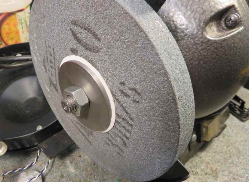

Here's the second one that I was working on.  I went about this a different way after realizing that the rods aren't hardened in the middle.  I marked as before and then took it to the band saw.  That got me within 0.020", and then I carefully took more and more off on my bench grinder (checking regularly) until I had only 0.004" left to grind in the precision setup.
I decided to harden the ends of my modified rods as well.  I'm not quite done the whole process yet, but I anticipate complete success, despite my limited equipment.

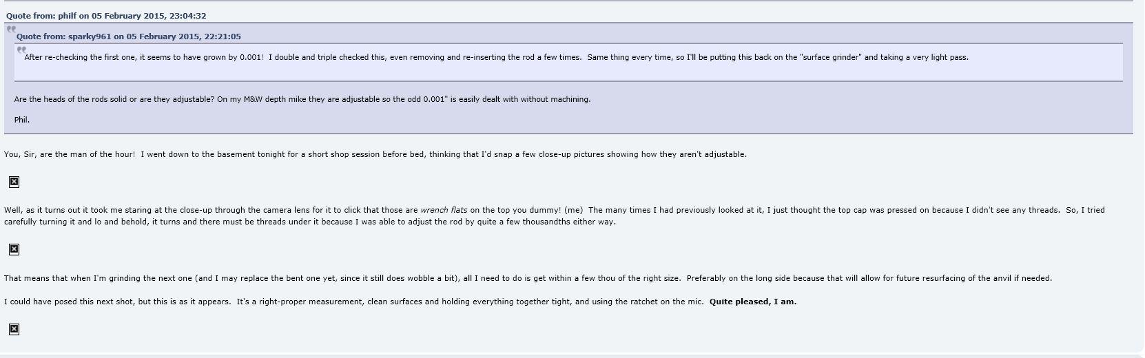

After re-checking the first one, it seems to have grown by 0.001!  I double and triple checked this, even removing and re-inserting the rod a few times.  Same thing every time, so I'll be putting this back on the "surface grinder" and taking a very light pass.
Are the heads of the rods solid or are they adjustable? On my M&W depth mike they are adjustable so the odd 0.001" is easily dealt with without machining.

You, Sir, are the man of the hour!  I went down to the basement tonight for a short shop session before bed, thinking that I'd snap a few close-up pictures showing how they aren't adjustable.
Well, as it turns out it took me staring at the close-up through the camera lens for it to click that those are wrench flats on the top you dummy! (me)  The many times I had previously looked at it, I just thought the top cap was pressed on because I didn't see any threads.  So, I tried carefully turning it and lo and behold, it turns and there must be threads under it because I was able to adjust the rod by quite a few thousandths either way.
That means that when I'm grinding the next one (and I may replace the bent one yet, since it still does wobble a bit), all I need to do is get within a few thou of the right size.  Preferably on the long side because that will allow for future resurfacing of the anvil if needed.
I could have posed this next shot, but this is as it appears.  It's a right-proper measurement, clean surfaces and holding everything together tight, and using the ratchet on the mic.  Quite pleased, I am.

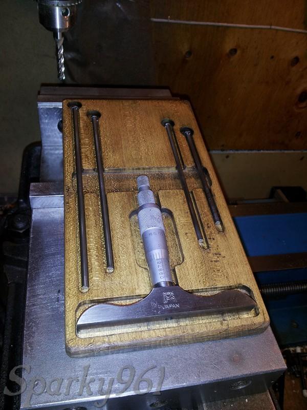

One final post to finish things off here.

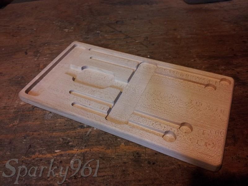

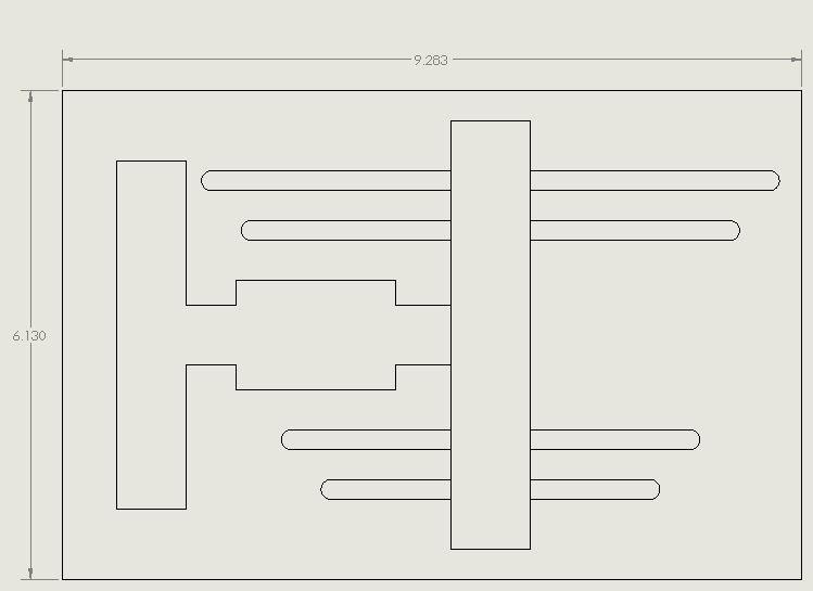

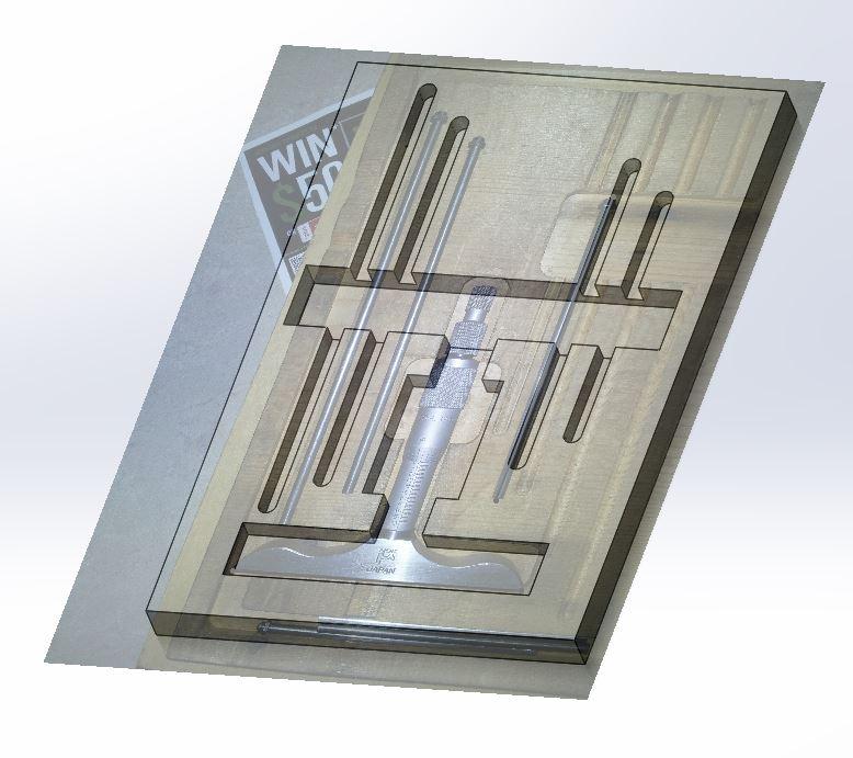

I had completed doing all the rods a while back, maybe last week sometime.  The piece of wood that came with the set was pretty sad looking, and cupped pretty extremely.  I planned from the beginning to make something a bit more appropriate for this piece of precision equipment.
I thought about doing a box but when I open a drawer to reach for a tool, it's annoying to have to open another box too.
No big write up for this, but basically I designed it in SolidWorks using a picture as a background to make sure everything would fit.  I then printed it out 1:1 and glued it to a piece of wood that wasn't quite as big as I had originally planned.  While holding it in the milling vice, it was a pretty simple matter of "driving" the mill around and cutting it out following the pattern - that is, until the glue let loose.... but I got 'er done and am quite happy with the results.  The sequence of pictures shows design, milling, before staining, and a nice final glamour shot.
