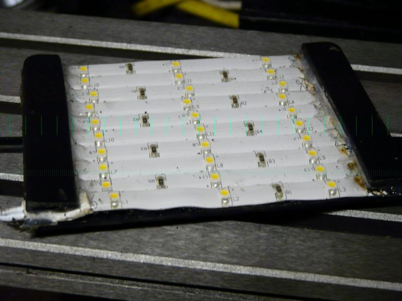

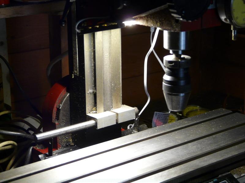

I finally got around to fitting some of those LED lights to the mill ,,and I have to say I'm well pleased with how they work,,and they were very easy to do... I'm sure i've told you all previously that electrickery makes me bum squeak sumfing awful :zap:
but this was really straight forward to do,, i just read up on ebay about different strengths of lights and what power connector i'd need.. even after i'd ordered the stuff i decided to put an on/off switch somewhere along the power feed cable and even that came ready made,, i just had to plug it inbetween the leds and the power adaptor,The correct male/female jack plugs were already on it..
I used a idea I got from S/D David but instead of using a dog bowl for a shade like he did, i used the lid from a ss tea/coffee storage tin,, luckily the one I had happened to have a perspex centre which made it simple to cut on the lathe,,here's some photo's...
so thats me done the spindle rev counter mod, then the gas strut mod- and now the built-in lighting mod, and it's all thanks to you guys for passing on your knowledge and dishing out encouragement when it's needed..... thanks gents...
 I just have to suss out some way  to kit it out now with a reasonable DRO system and i'll finally have a decent mill,,,
Oh no!!! if I do that  I'll then have to finally start to build the Wyvern or Centuar castings that are living under my bench... it'll be a shame when i screw them up... :( :palm: :doh:,, but that disaster can keep until some point in the future...
...Mike...

Very nice. Good idea that. Puts the light right where it's needed.

Nicely done Mike!  :clap: :clap:
The lights...... Are they a strip length, not an angel eyes circle?  :scratch:
Never thought of that!  :thumbup:
Re: ed lights for mill,,
« Reply #3 on: February 13, 2015, 04:07:32 AM »
same idea different way cut into short lenths and wired at joines , stuck onto a piece of plastic held on with cable ties .

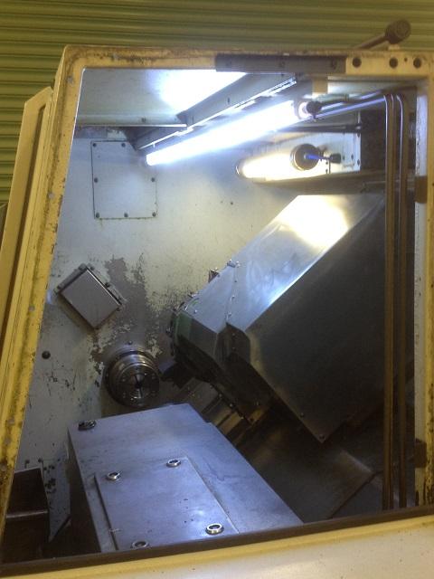

This is my, 3yr old version.........
I feel a Modderfication, coming on........  :mmr:

I did try wrapping a lenght round a piece of plastic water pipe but it took up to mutch room .

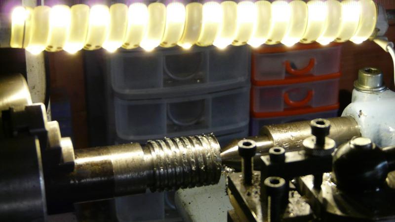

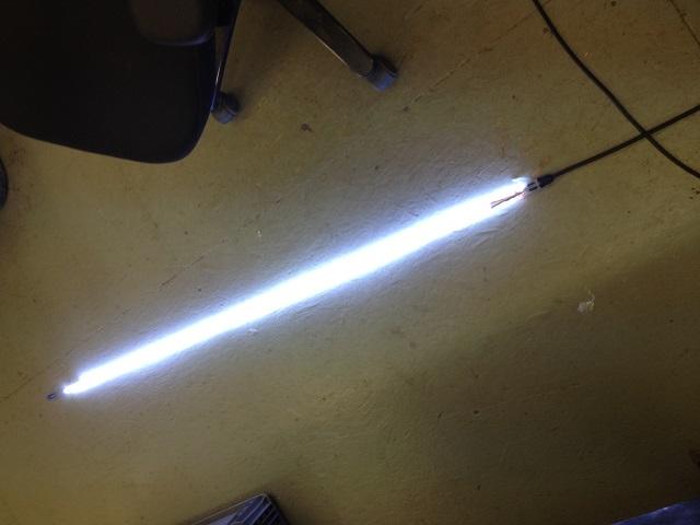

Same stuff wrapped around a 6mm rod and pushed into a 20mm o/d polycarbonate tube with end plugs to make coolant proof:

  David,, its just a strip the same as Jeff has used, mostly sold in 5m lengths but i found someone on ebay selling a 1m length,,,it was much the same price as the 5m but i've enough junk lying around thats supposed to ''come in handy one day'' they come in 3  sizes from what I could see, so i went for the middle ones,,...cheap as chips though,,  The strip, the power adaptor and an on/off switch for well under £10,, it involved 2 screws 2 jack plugs then plug it in.... job done...if only all electrical bamboozallry was that easy.. :scratch:

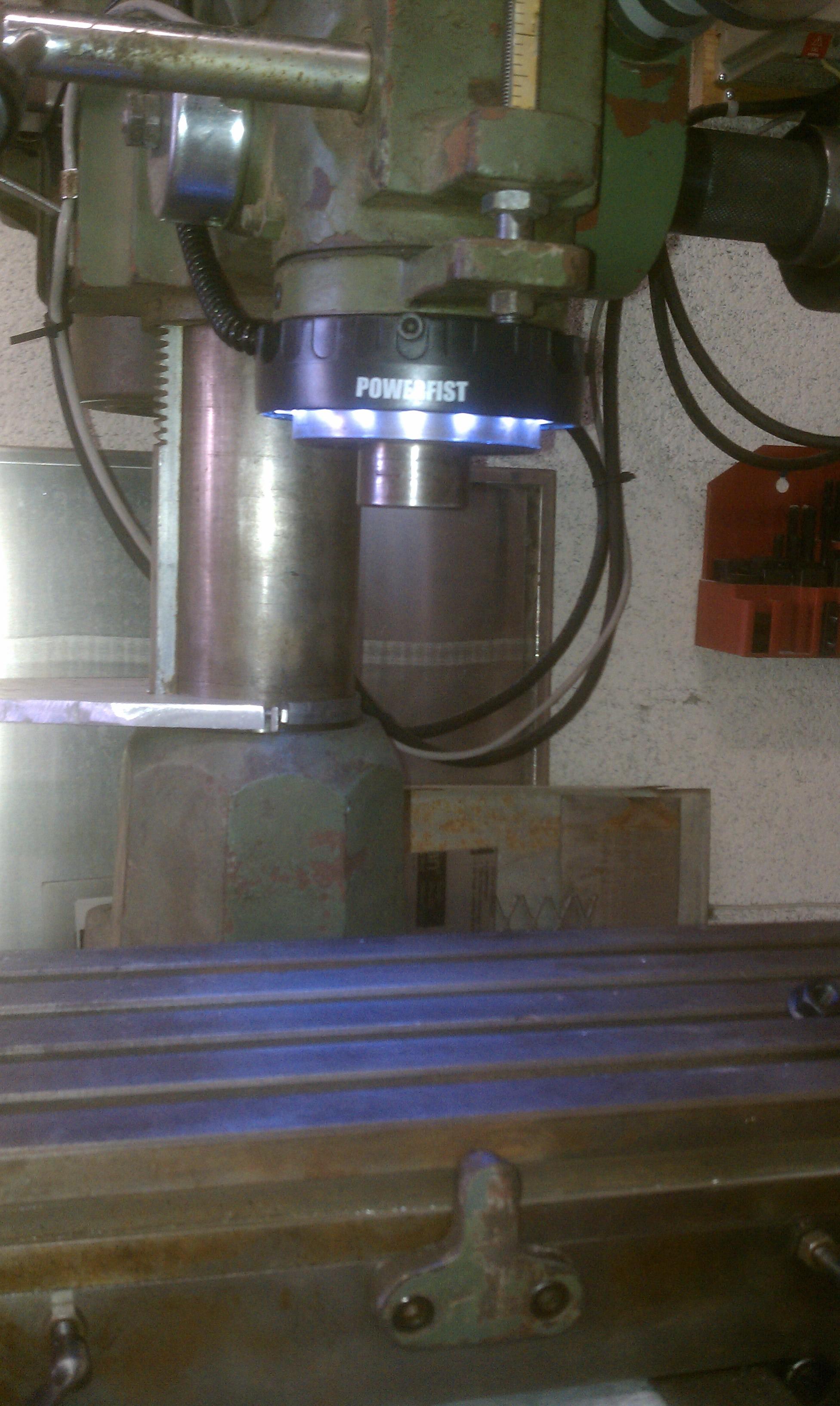

I used a round "angel eye" ring.  Sold for customizing car headlights.  Bought 2 for a couple bucks, shipped.  They are 12 volt, so require a separate power supply.  for that I bought a wall wart adapter; one that's 110v in, 12v out.  That was also a couple of bucks shipped.  Both items were purchased on ebay.
The ring is the perfect size to fit around the spindle of the mill.

I copied Stilldrilin'  method with the angel eyes lights, I am pleased with the results & I am planning to try the gas strut as well.
since I installed the belt conversion and fitted the larger hand wheel on the fine feed & fitted the light it has transformed my little miller, so thanks for the ideas :nrocks:
