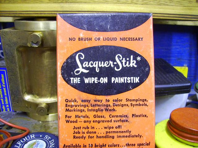

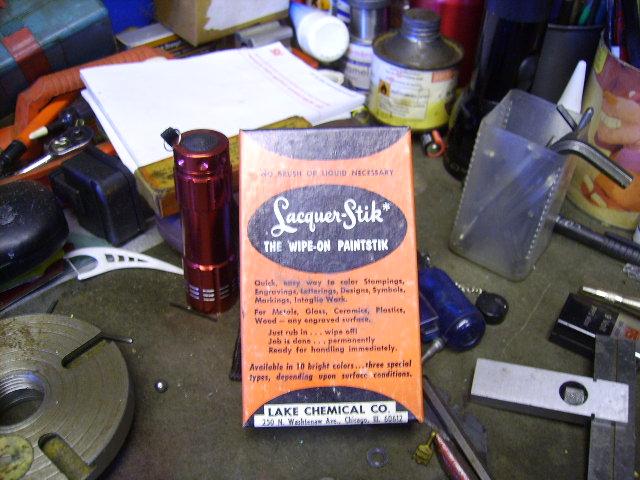

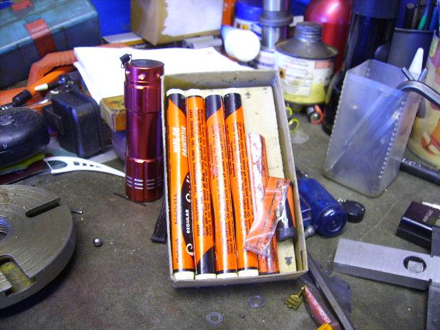

hi all when i have stampt numbers in a plate i pant over the number let it go hard IE left on the shelf for a week or two but was given a box of sum laquer stiks at work they once mad name plats for the press tools once made they used thes to fill in the letering i have had a look on the net and ther still avalibel at a resnebel price the ones i got from work have dride up a bit but still work will post a pic of sum numbers that i have filld in with them any way sum pics of the paint stiks

I've used paint sticks to fill in engraved lettering. Works well in most cases. RS used to sell them as I remember.

As you say -available at a reasonable price. I've just ordered a red and a black one. £5.43 inc postage.
https://www.paint-markers.co.uk/product-category/speciality-markers/speciality-markers-lacquer-stik/
