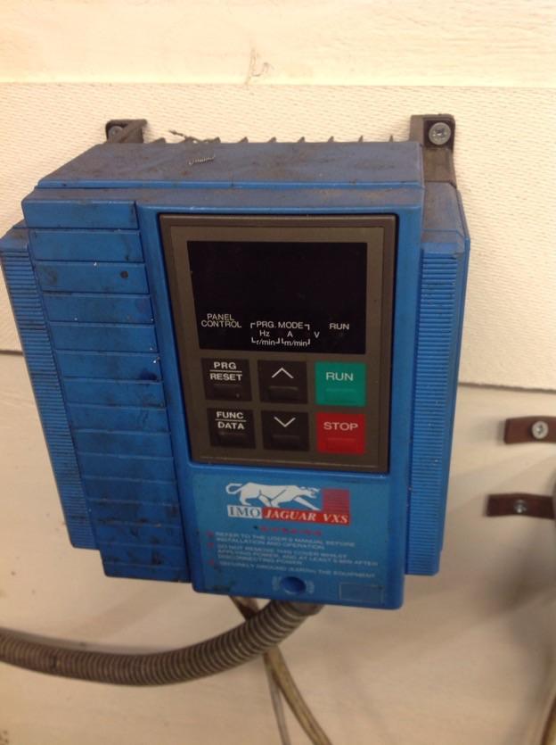

Hoping for some info guys. I'm using a Jaguar VXS inverter to run my lathe motor and the pendant isn't right. The variable speed pot does not change the speed in a linear fashion, from stopped to full speed in a touch, incredibly sensitive to get it to the right speed and then when set at a speed, the speed can often creep up.
Has anyone experience with this inverter and can describe the best way to make a new remote pendant and also suitable settings for the inverter. On my old pc many years back I had manual but I struggled to make head nor tail of it. I need to fully rebuild the pendant as it clearly is t correct either.
Any help appreciated. Photo attached.

Gutted, awful feeling of two wasted hours before bed - my first efforts produce an OH2 external trip alarm input!!
I've attached the circuit I am using, only mine is 24v internal and therefore a 24v relay. I've also attached the error flow diagram. I'm not clear about the THR issue... There Is a wire collecting THR to 24v. When it was manual it was hard wired 24v to THR to FWD - is that right, it suggestions so in the flow diagram.
The inverter boots up ok, as soon as I hit RUN on the new controller I hear the relay switch but then the inverter immediately errors with the trip OH2.

OH2 error indicates open circuit between P24 and THR - see control circuit section of the manual that I previously linked to.
Re: Lathe Jaguar VXS inverter - remote pendant
« Reply #30 on: November 01, 2015, 08:53:09 AM »
I concur with David,
The THR input is normally closed, and is a Stop function.
Chris, connect the Fwd and Rev wires from the sketch to those inouts on your inverter.....then connect what was the 12v wire to the P24 terminal, CM is common and should have the black wire connected to it...forming the 0v connection....it should all work then  :zap:
  • Posts: 2913
« Reply #31 on: November 02, 2015, 07:32:44 PM »
 :ddb: it is working!!! Pictures to follow over the next days but speed, start, stop, forward and reverse are all good!! Whoop
