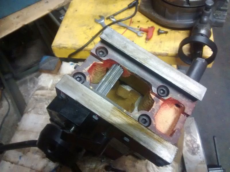

So lets start by degreasing and cleaning the two slides. I separated out the little bits: Gib screws, clamp bolts and the other bolts and dunked in white spirit. Gave them a shake or 3 whipped them out to drain (with a magnet) and then used said magnet on the bottom of the yoghurt pot:
As you can see from a VERY small selection there is a bit of CI dust in there.
So what about the Big bits? As it was a sunny but cold day half an hour in the back yard and I had scrubbed the castings clean. I wonder what would be in the bottom? Recall that the castings had already been wipped down with paper towels and WD40 (Ok Quickly).
This is what I recovered:
We don't want that around our slides.
The lead screws were scrubbed and then mounted in the lathe and tooth picks/paper towels were used to clean the threads (Sorry -no pic). When the paper was clean I stopped :thumbup:
So first in went the cross-slide: adjusting things up just right. Note: End float is of the order of 0.12mm. I will be discussing end float on this machine in more detail. At the moment I am just trying to get smooth slides/gibs.

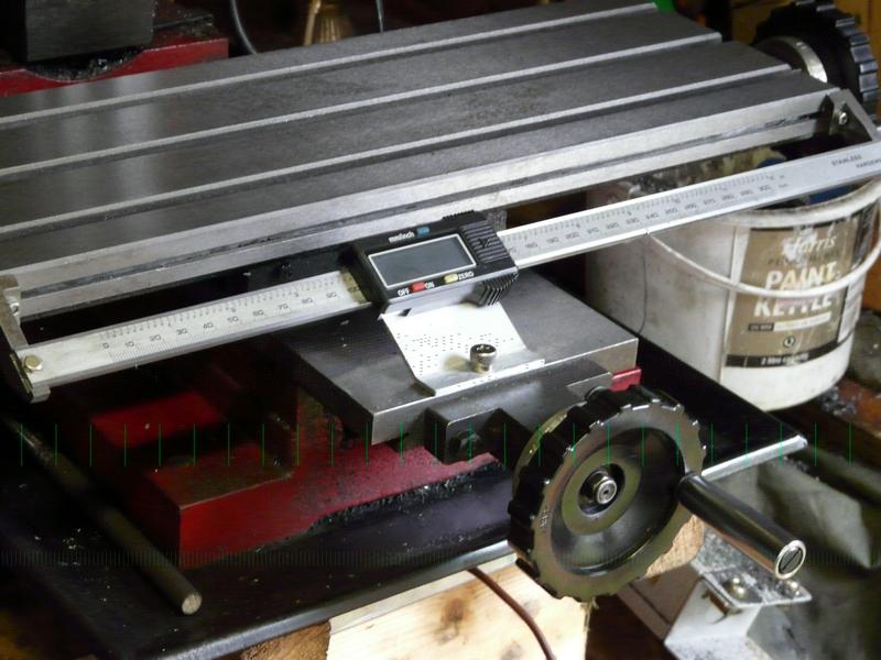

Hears my set up milled a 3mm T slot by clamping a spindle to the base , it's a 300mm DRO and is about 15mm short of full travel , I was going to make some stops but not needed them , the X is on a single bracket at the rear whith a remote readout .

Nice job..    :thumbup:   a bit confused tho'  ....  'the X is on a single bracket at the rear whith a remote readout '...   your pic shows you have the 'X' axis already fitted  with single bracket on front, do you mean either the 'Y' axis (should be on the side ) or the 'Z' axis is fitted at the rear...   :scratch: ?
