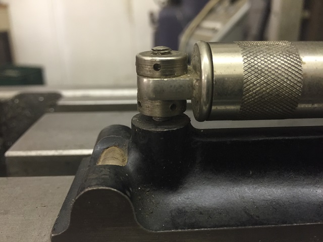

« Reply #11 on: January 10, 2015, 03:55:43 PM »
Peter, you could just have springs or compressible pads under your assembly that are squashed by a knurled hold down screw. I'll try and photograph mine in the morning for you
Re: PeterE makes a small Engineers Level
« Reply #12 on: January 12, 2015, 10:25:34 AM »
Pictures of my Rabone Chesterman as promised

« Reply #13 on: January 12, 2015, 05:17:58 PM »
Thank you for the pictures Andrew, very informative!  :thumbup:
I will think a bit and evaluate some good ideas that came up here.
