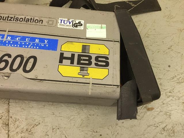

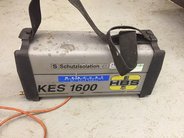

Years back I had a project that would have been SO much easier if I had a 'Stud Welder' ie a specialised welder that welds a threaded stud onto a piece of structure, so not only giving you a solid fixing, but a fixing that hasn't pierced the structure, not damaged the surface finish on the 'other side', and is still therefore watertight.
(Not to be confused with the lighter duty Stud Welder used in car bodywork repairs for pulling out dents)
So I've had a 'search' set up on ebay telling me when they are listed - and they fetch HUGE amounts of cash. Well this one popped up as a 'buy it now' and was at a VERY modest price  :ddb: In fairness the seller couldn't be sure it worked - it had come in in a job lot of kit and he hadn't dared try it. Well there's a challenge if ever there was one  :lol:

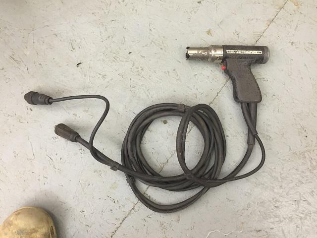

A deal was struck, and when the holidays were over transport arranged. This is what arrived:

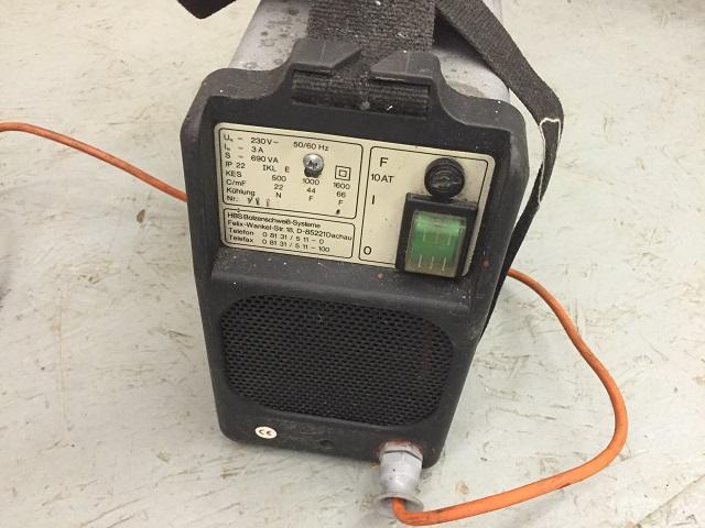

Now in anticipation of managing to get it going (how hard can it be ......... :scratch:) I also bought a job lot of 8.5 kG's of suitable welding studs ranging from M4 up to M8. So really no excuse not to jump in at the deep end  :lol:
Well an inspection showed that it was by no means perfect but just a little neglected. The rear case was hanging off exposing the large bank of capacitors.
As I understand the operations of these things - the box of tricks charges up a bank of capacitors, then when the stud is in physical contact with the structure they are discharged, presumably using a solid state switch, melting the end of the stud and where it is pressing. As the stud gun holds the stud 'spring loaded' the two fuse together

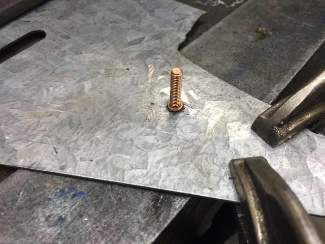

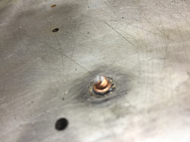

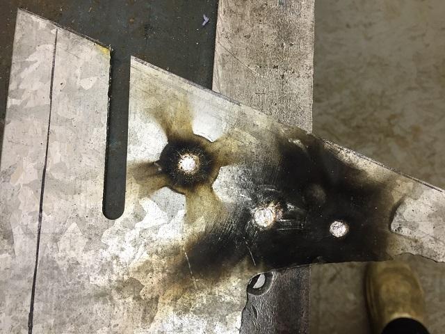

So lets give it a go! There happened to be a 6mm stud in the gun when it arrived. I found a bit of 1.5 mm galvanised steel, set the tweaker to about 3/4 and pulled the trigger. Result, a HUGE bang and flash from the work piece and a stud not attached at all.
Two thoughts went through my mind. Firstly possibly the galvanising is causing a problem, and secondly perhaps too low a setting for this size of stud.
Here is the result

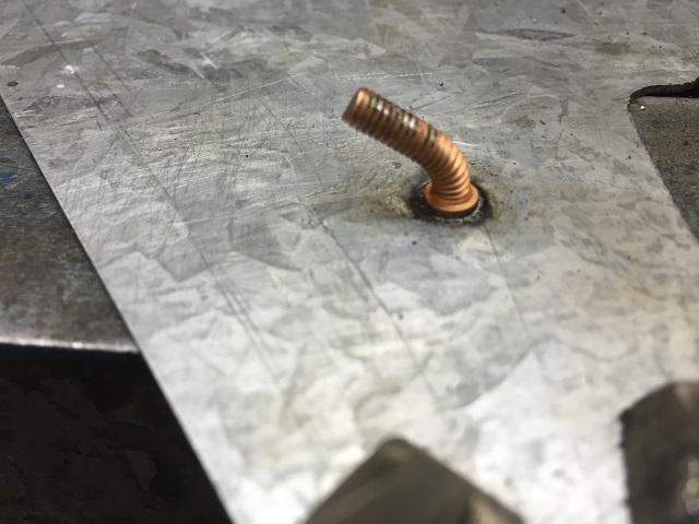

Well a bit of experimenting showed I was wrong - the setting was too high, and the melted metal instead of fusing together was being blasted to kingdom come out of the joint.
Reducing the setting produced some excellent welds that are not only well fixed, they are strong enough to be able to bend the stud without breaking. Picture is of M5 stud on 1.5 mm galvanised

Now I assume that the tweaker on the front panel (setting dial) is adjusting the voltage that the capacitors are charged up to.
Then I tried it on some 4 mm plate just to prove the mass of the metal didn't draw the heat too much for fusion, and also that it would be tough enough to try breaking the stud. Sure enough the weld is easily strong enough, and the stud breaks before the weld

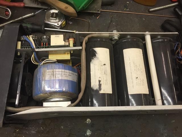

I've not pulled it apart, but as far as I can see there are three of those capacitors, all the same physical size. The thing is quite light so no 50 hz transformer though probably some form of chopper / inverter arrangement for charging them.
Don't know for sure, but I suspect the discharge is direct from the capacitors through whatever switches it, and I expect that they will be special high current low internal resistance types.

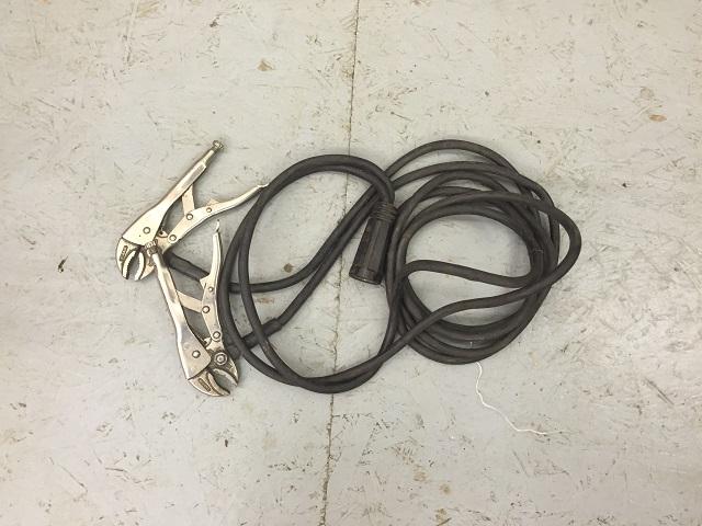

Oh, I just noticed two leads going to the gun -- maybe things are more complicated ???
  • Posts: 6941
Re: KES-1600 / HBS Stud Welder
« Reply #14 on: January 08, 2015, 09:18:27 AM »
Well maybe one is a local gun shield ground....maybe those vise-grip ground clamps only partially supply the ground -- or maybe they are for a different job situation.
  • Posts: 9137
« Reply #15 on: January 08, 2015, 09:19:36 AM »
There is a welding style lead to the gun via a 'dinze' plug, then also a multi-pin plug / socket. The gun has a trigger that is obviously just a switch. The main box lights up a lamp when the spring loaded gun is pressed against the work, so that's just detecting an earth on the shroud.
So again just assumptions, but the only active thing coming back from the gun is 'trigger pressed'. There is a light over the setting dial that goes green when ready, but if you move the dial up or down it takes a few seconds to go back to green from the red it shows as you move. So I assume it is measuring the volts on the capacitor bank and comparing with the 'set point' from the dial.

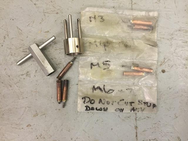

Steve, that's not really a manual, more a guide written by some firm that are using one for only two sizes of studs. I think it'll actually do 8 mm.
Stud is just mild steel, as you say copper plated and with a pip on the end. It is held in a simple four fingered collet made from copper, and the fingers are held together with an O ring. Up the back of the collet is an adjustable 'depth stop' to adjust for different lengths of studs. If I get a chance I'll pull the back off and measure the voltage on those capacitors - I suspect it's not going to be that low - 150v is my guess but time will tell. My guess is based on them being 200 v rated. To last they need to be under rated, but no manufacturer is going to pay for higher voltage caps than they need as I bet that they are rather special and pricey.

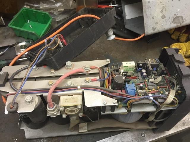

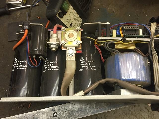

« Reply #32 on: January 10, 2015, 08:31:09 AM »

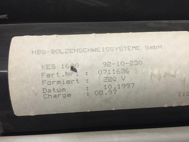

So you can't really have a bit of kit like this without pulling it apart and having a look inside  :ddb:
No real surprises - three capacitors totaling 66,000 uF rated at 200v. One side of the bank direct to the earth terminal - the other to the gun via a humungeous power semiconductor and equally impressive clamping power diode. And some circuitry to arrange for triggering the semiconductor power switch, and charging those capacitors.
(I strongly suspect that the circuit is identical to the one in the Lynx manual I uploaded a few posts up this thread with the exception of the voltage indication)

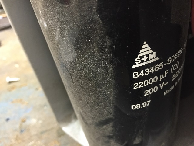

Thanks Steve ..... but VINTAGE ... :scratch:
Those capacitors are dated 1997 ..... that's MODERN   :lol:
I love the heavy braid straps leading all those electrons from the capacitor to the outside world, and that big switching (probably) Thyristor  :ddb:
