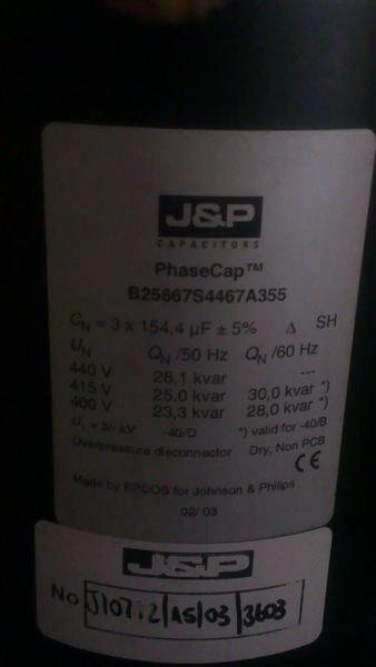

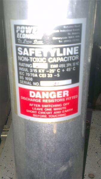

I've got some large 3 phase capacitors which came out of a switch cabinet and I'm wondering what they might be good for before I decide what to do with them. The black ones are about 5" diameter and about 8" tall and 154uf. Silver one is taller and thinner and I think it's a relacement for one of the black ones since one cabinet had three black and the other has two black and a silver.

Power factor correction, or making a static single to 3 phase converter

Or making a highly efficient generator head out of a 3 phase motor (power factor correction, again)
There's a REALLY good book about doing this, that I have somewhere -- I forget the title -- but I'll put it up tonight as soon as I find it..........
(Back a few minutes later...)
Ahhhh yes, here it is, "The Home Power Producer's Guide to Electrical Reality" by Bill Rogers.
One of those small masterpieces that tells it like it is, and provides truly USEFUL information backed by engineering theory and experiment.
