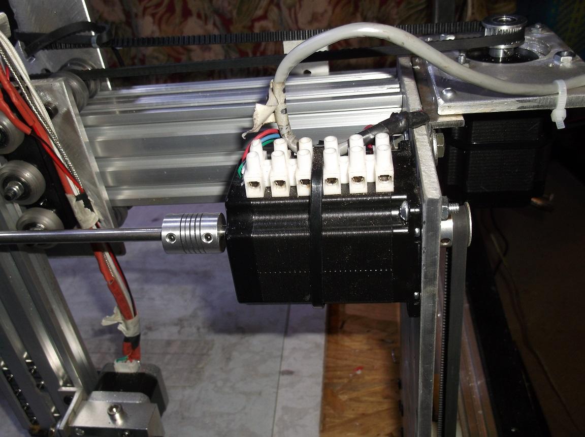

My 3d printer, been keeping me busy working out issues, bugs, changes. It is getting closer, The Leveling bed,  the temp controller for the 23x24" floor-concrete backer board nichrome wire sandwich hotbed is to be wired next. Not the screw adjustable Z home limit for varying print height. Note the single X axis motor with dual shaft-belt drives??

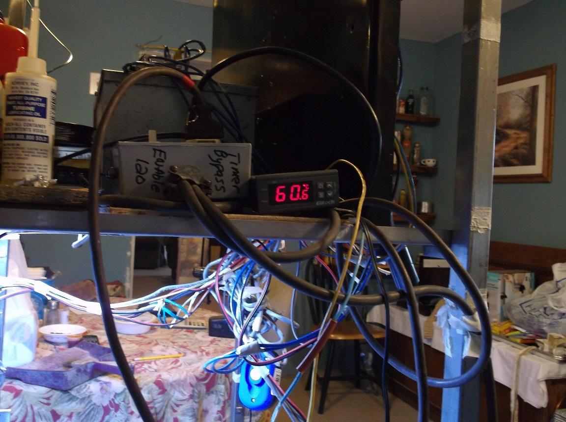

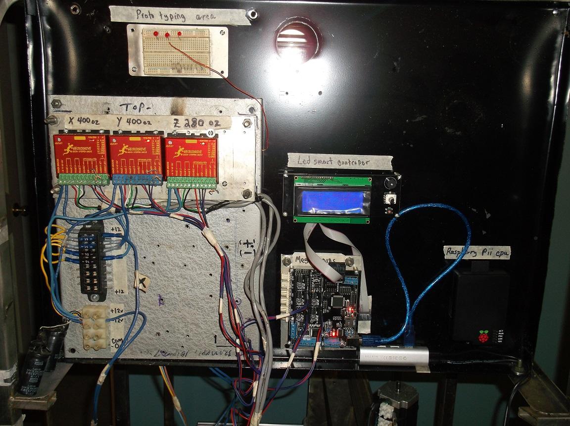

I have a STC1000 temp controller, fixing to wire that up to the hotbed I think.  Not real impressed with the accuracy I am getting through the Chinese electronics tied to the megatronics-arduino, hotbed or extruder.  It is a K thermocouple.. so it may get replaced with a spare PID like I put on my beer brewer.

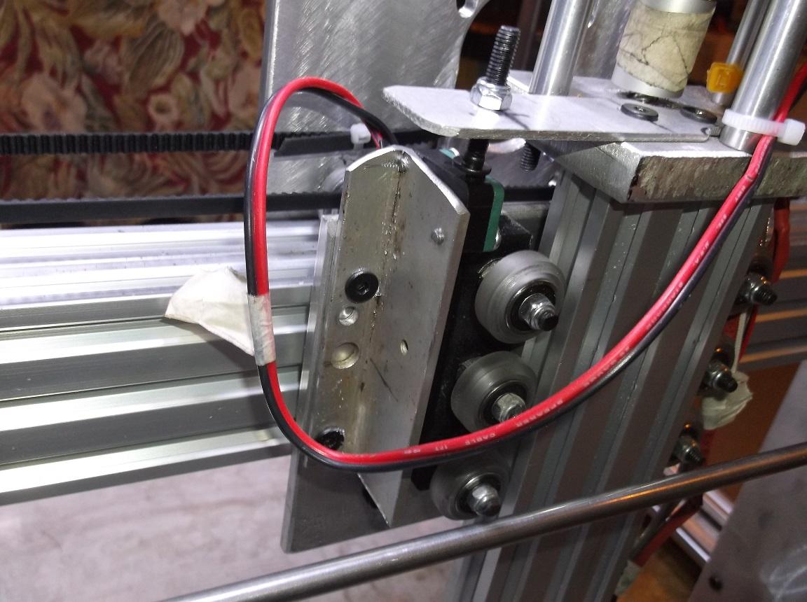

Still happy with the V-slot & extreme rollers from openbuilds.  You could build a real nice Delta bot using that in half the time I have messed with this gantry.

My extruder temp sensor on the Chinese megatronics board died.. I am so frustrated.  Chinese electrical products are crap, or they sell us the crap and keep the good stuff.  I lost a 12vdc power supply on the solar-lights here.. and the heat sensor on the megatronics board yesterday.  The pile of junk stuff smoked is growing. All surface mount stuff a old near-blind guy can't fix.
This whole system is going back onto the Mach3 drive and control.  You can slicr the 3d files, and run them on a computer. I'll run the heat on the two pid controllers. If that don't work, I got 1980s opto22 analog boards that talk on a serial link, done worked out Mach3-serial communication.

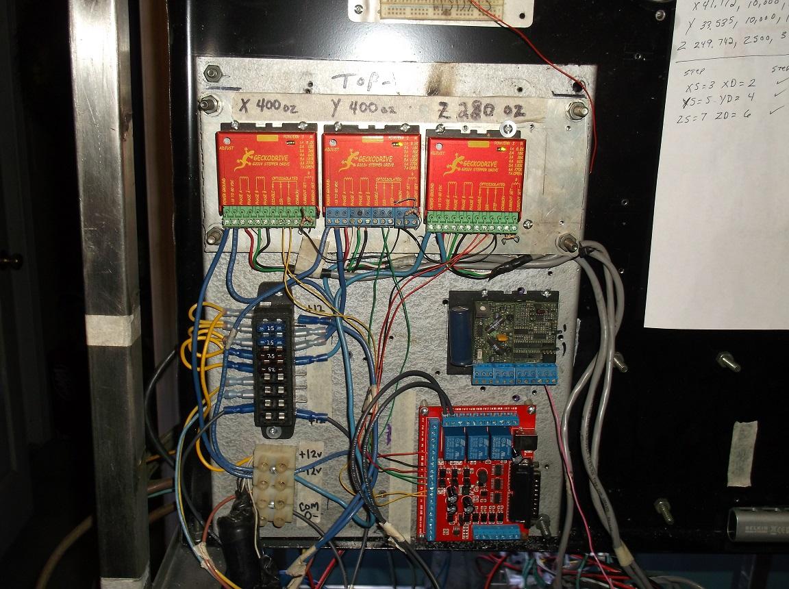

Some success, some failure.. the megatronics is back in a box, it lost the reference in the thermocouple circuit.. the Cheapie parallel port Mach3 breakout board is half hooked up and tested operating the drives. (extruder drive is not connected yet)  It currently has only home switches and I have not hooked them up yet.. they normally series on a mach3 system.  I want to use this high speed system to scan-probe 3d objects also..

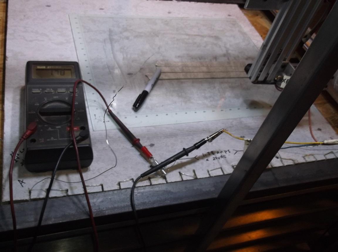

THE hotbed, 24 passes at 24" each made 24 ohms (TemCo RW0063 20 ga nichrome wire).. I tried it on 3 sets of 24 volts windings.. it only got to 40C.. I hooked it up on 120 ac (more dangerous) and it got to 60c.. I'll have to rig in a ground fault circuit to be safer.. and be aware.  I can of course use a hot water heater thermostat and put the digital one back in the box.. or use it for a temp indicator?? or??  THE hotbed from what I understand it just to help adhere the first layer..
Looking, the cnc protoneer Arduino CNC shield looks like it can be used stand alone, pump 5 volts in, the drive power in, and use the small poulu drives for small motors.. At $12 this is the cheapest way to drive small motors with a computer..

Yes, I'm not much help, the jumpers on the board, no documentation. "A932A" is the board "silk screen" and you can find some stuff if you can wade past all the "gotcha" redirection links to ebay sales pages. Jumpers sometimes do not matter, okay in the default position, but I did smoke a new vfd about twenty years ago and I never forget a mistake.
You have the usb providing 5volt signal power? you have the additional external power connected to the terminals below the relays??  Also, how to provide "pin labels" for Mach3 for the output relays>>>? all the 12 output pins on a parallel port are used? the 4 inputs, there are some questions not answered yet..   (edit after thought).. and there was four bits of bi directional pins that input and output... on a parallel port interface.. I see no "cpu" to read the usb and create logic.. so??  Normally Pin 1 is the "strobe" port pin used for vfd pwm... that is also used for a 0-10/5 volt signal..  but pin 1 was on the ttl step terminal strip.. so???
I bought this board cause it had both connections for sink, or source logic stepper drives, I have both now, and I have some servo drives I bought over ten years ago I plan on using also.
(10:22 edit)...  Mach3, OKAY.. use Pin 1 for PWM output, abandon it on the terminal strip.. set it up in Spindle configuration, set it up in Pins Outputs spindle control.    THIS board is a either or configuration.. use the pins for 6 axis, or less axis and use those pins for relay control..Removing jumpers disable the terminal strip,  If I am wrong, please let me know..
