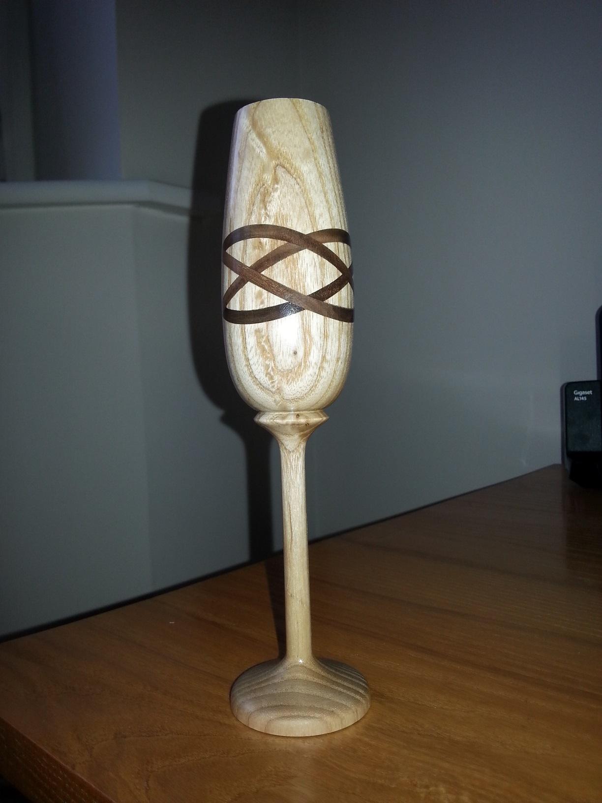

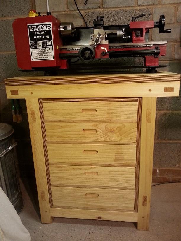

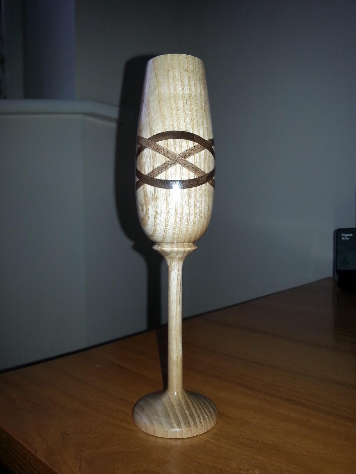

As my main hobby is woodwork, I thought I could post a few pictures of stuff I have made.
First a couple of a turned goblet with a celtic knot pattern, then the cabinet I made for my mini lathe.

Nice joinery and turning, Ian! :thumbup: :clap:
Would they be mostly made of ash?

Beautiful work with the tree wood. I bet there is more work in those goblets than would first appear.

The goblet is ash with walnut.

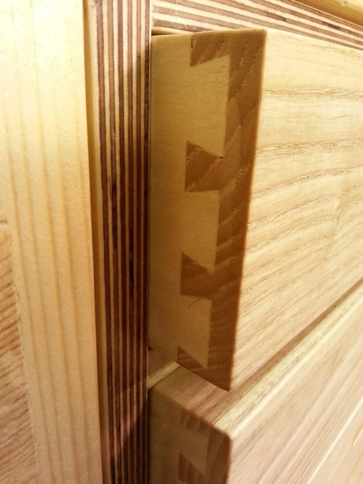

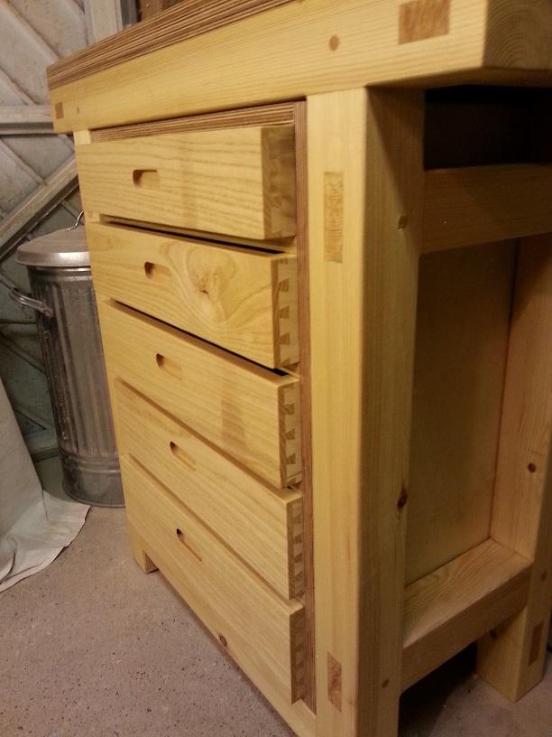

The drawer fronts are ash but the sides and back are poplar. The frame is a softwood.
I tend to often use ash as it is not too badly priced and nice to work with.

Thanks Spurry.
The goblet uses a fairly simple technique that I think looks good.
Rather than me trying to describe it and making it sound too complicated, do a search on 'celtic knot turning'.

Very nice lookkng drawer! I like it a lot when materilas look themselves (I hate much modern flloring materilas tiles made to look wood, plastic made to look tiles....). I also enjoy seeng good honest joinery. I don't care if joinery is machine or hand made, both needs skill and there is a learning curve.
Thanks for showing them. You don't happen to have any pictures of joinery when you were making them?

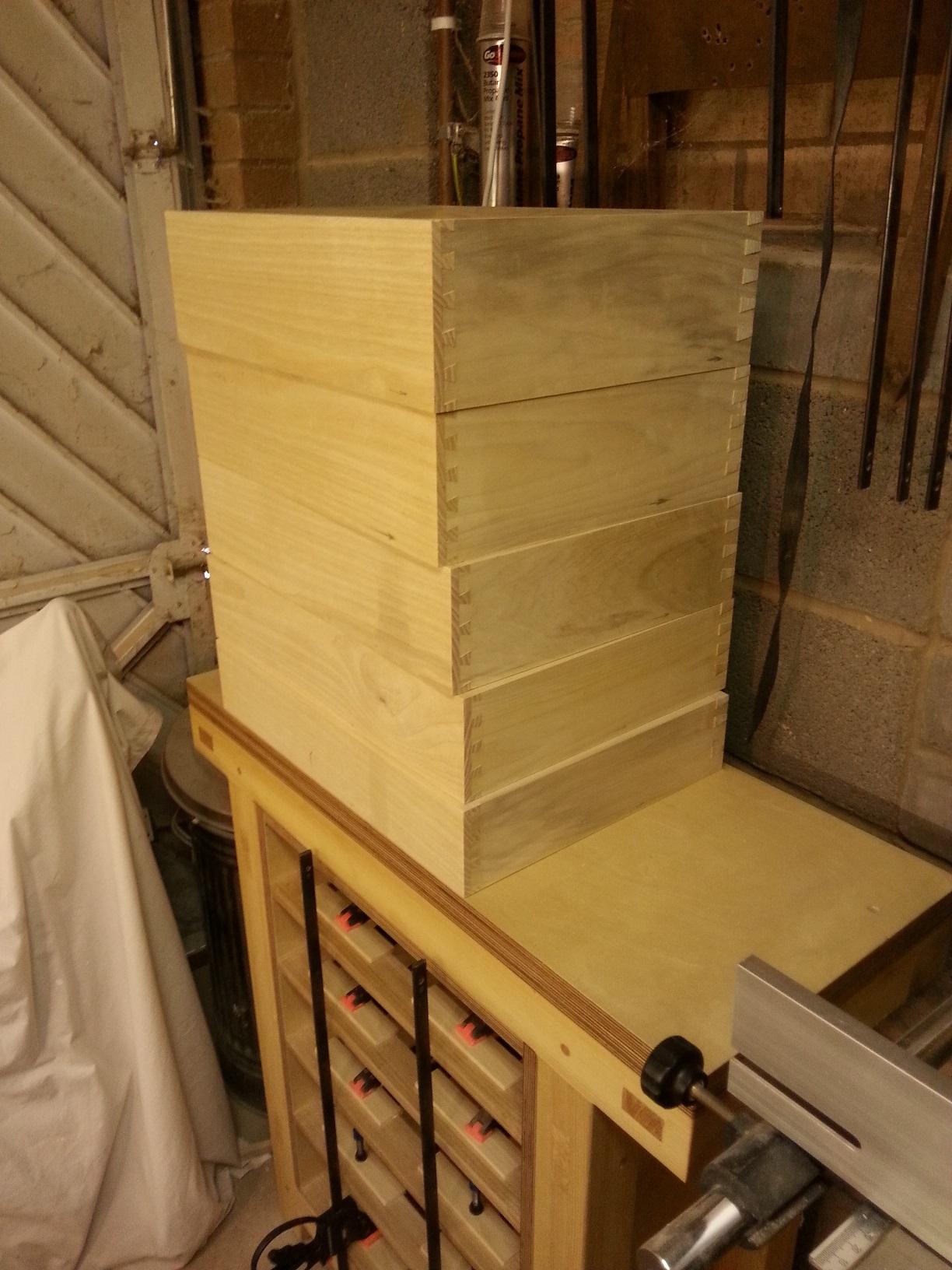

I admit the dovetails were cut with a router and not by hand.
I can just about do it the traditional way, but with that many drawers to make I was bound to make a mistake somewhere.
I have only got a couple of pictures of progress, but if I can work out how to squeeze a milling machine into the garage I will be making another one.

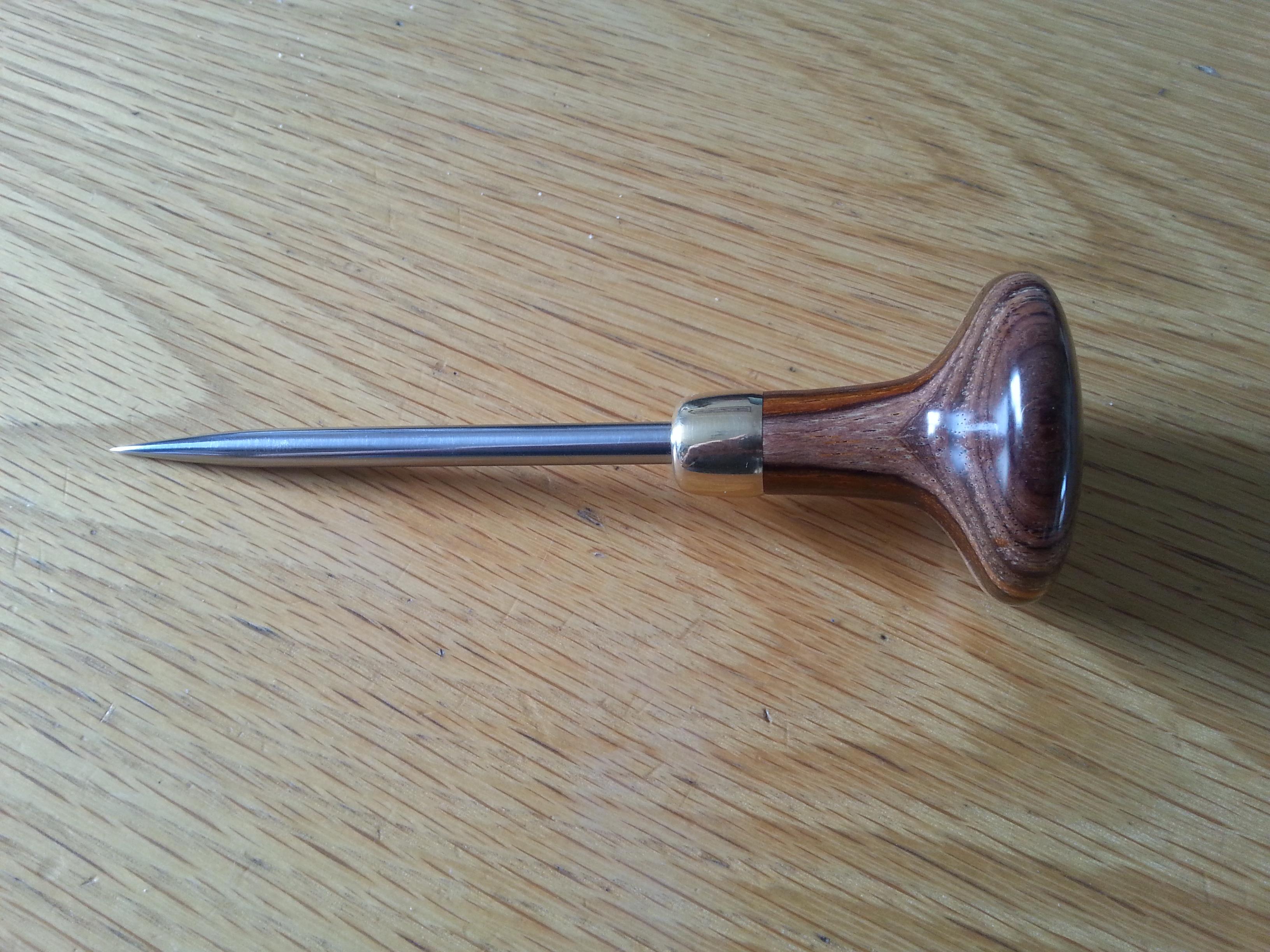

I have also put up a picture of an awl I have made. The brass ferrule was actually turned on the wood lathe by hand, and was the start of me wanting to get a metal working lathe. The wood is cocobolo. It has no finish on it, and was simply buffed to that shine. A beautiful tropical hardwood, but horrendously expensive and it does come with a health warning.

Nothing wring of using the machines. I use routet much of the joinery, but never used router to make dovetails. Just too much hardware to do limited size and spacing.....but I have considered buying something simple. On the line of Leigh R9, only "problem" is that they are imperial - some consepts are foreign to me.

I use the leigh superjig, as it allows some variation in joint layout, and does not fix the board with.
It also works for both through and blind dovetails.
They have shot up in price though since I bought mine.

A lovely cabinet - forget the garage the place for it is in the living room! (And here's me looking around for second-hand kitchen units - so embarrassing).
