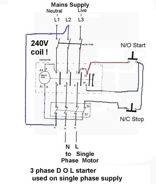

I made my own NVR for my lathe using a normally open start switch, a normally closed stop switch and a relay to latch the supply. It's simple to wire and the plug-in relay is easy to replace if necessary.

When I've built my own machines, or re-built industrial stuff without some form of NVR I've done like Phil and used an appropriate Red & Green pair of buttons and a contactor with a latching n/o contact. All a bit more robust.

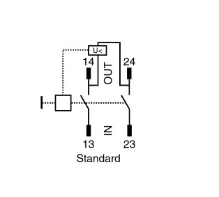

the budget no volt release switches are nothing like the direct on line starters we think of
if  I have interpreted  the diagram correctly the coil is wired across the output  of a 2 pole switch
the green start button pushes the  switch  closed and the solenoid then holds it closed until
you force it open by pushing the red stop button  :bugeye:
thinking of the early  demise of the switch
 if the mains is too low at the end of the 40 meters of cable
the solenoid may not hold the contacts closed with enough pressure to ensure they make a good low resistance connection
