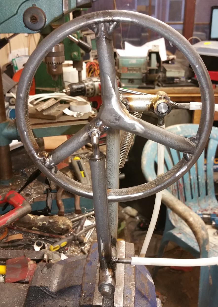

I have a running engine  :ddb:
And here it is, there is a pause mid video where I turn the air pressure up a little.
Changed the plan *again* for the valve and moutned it to the side of the flywheel shaft also changed the cam.
just need to strip it down and paint it then I will call it done too I think. May make it self supporting if I have time tomorrow.

I love the valve action! A really cool engne to watch in action Also, man that is a mighty true rim, for a bent pipe flywheel! I'm watching the rim and it's running damn straight. I know If I tried bending one (and welding on spokes, too) it would be out a lot more than that.

I had to go back and watch the video a second time to see the excelent job that you made of bending that pipe into a round flywheel. I have to agree with Steve that you have done a mighty fine job of it.  :D :D

Spent the day today making mine stand on its own feet (which required a bit of balancing to stop it throwing itself around) and painting. Only had a limited choice of colours black, white and red oxide so used all 3  :lol:
I will leave it until tomorrow then put it back together and call it done. Just thought I would mention that this is my first ever engine too however I feel it shows in mine unlike Russell who seems to have taken to it like a duck to water.
Steve I have to agree its been great fun following what you and Russell have been doing and its got my creative juices flowing. Even at this late stage I am thinking of other ways I could have done things and I think I will go ahead and make another without the restrictions of this challenge.
Finally thank you for setting the challenge in the first place however I hate to think what the next ones gonna be  :coffee:

 :thumbup: :thumbup: :thumbup: :thumbup: :thumbup: :clap: Gee I knda hope your kids will play with it/hook something up to it!  :dremel:  I still love the cam, nail and spring valve action. Dwayne I can see how your inlet valve operates, how does your exhaust valve work?

  :Doh: I forgot to retake the picture of the valve, did take one but it was all out of focus. basically the valve in the up position opens the airway to allow it into the cylinder then as it drops to the down position it shuts off the air and a channel allows air inside the piston to vent out.
done a crude closeup the vent channel is tiny but just about visible. The hole in the top is how I did the ?rebate? to sit the rubber "o" ring to seal the airway.
