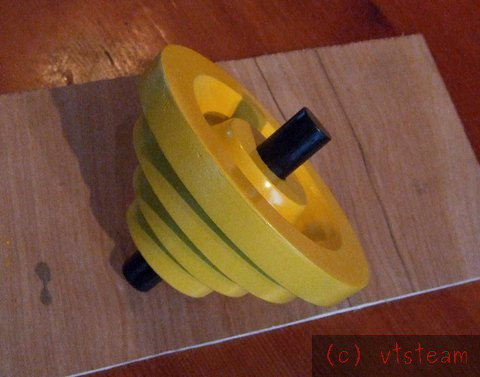

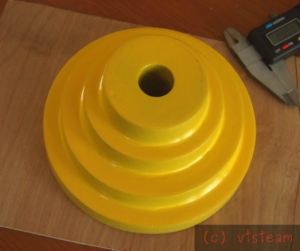

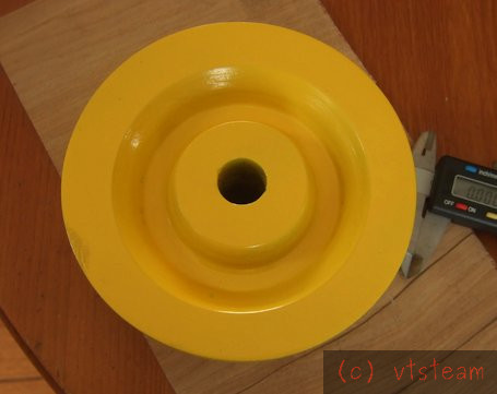

I worked a little on the pulley pattern -- mainly just relieved the back some so the casting wouldn't be as heavy there. The core prints are removable so I can core for different shaft bores. Also so I won't have to put a hole in the molding board.
« Last Edit: January 15, 2018, 11:41:42 PM by vtsteam »
Re: Working on a new tiny shop
« Reply #164 on: February 26, 2015, 02:44:01 PM »
A good bit of forward thinking there Steve  :thumbup:   What grade of brown stuff did you turn the pattern from ?
Rob  :wave:
« Reply #165 on: February 26, 2015, 03:36:34 PM »
Just plain old eastern white pine, Rob, cut here on the property on my mill. It works easy and I know what the weight proportion is to aluminum from practice, so I can just weigh the pattern to know how much metal to melt.

With core prints in place:
