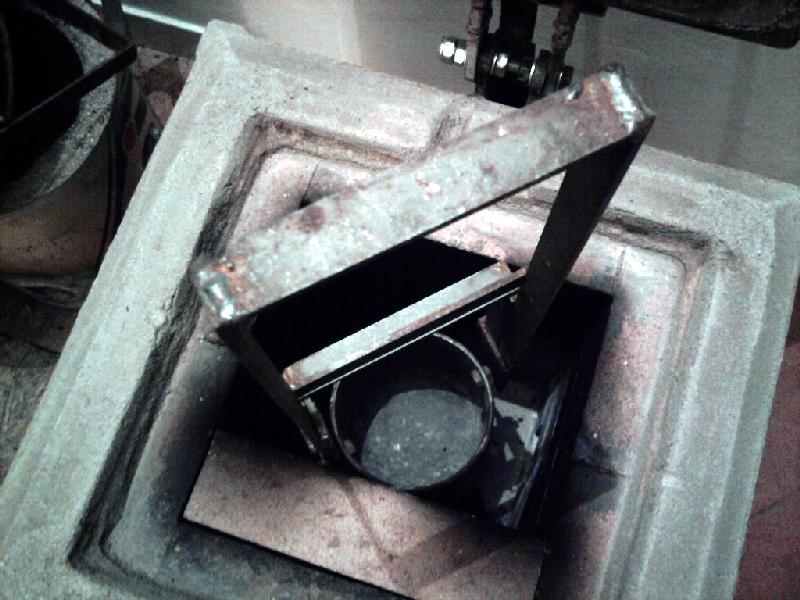

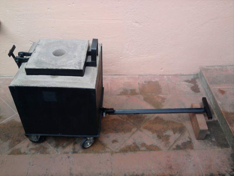

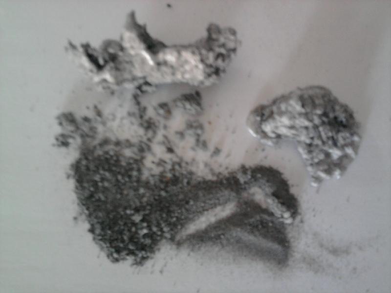

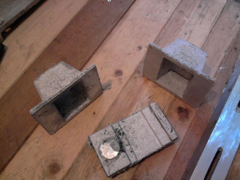

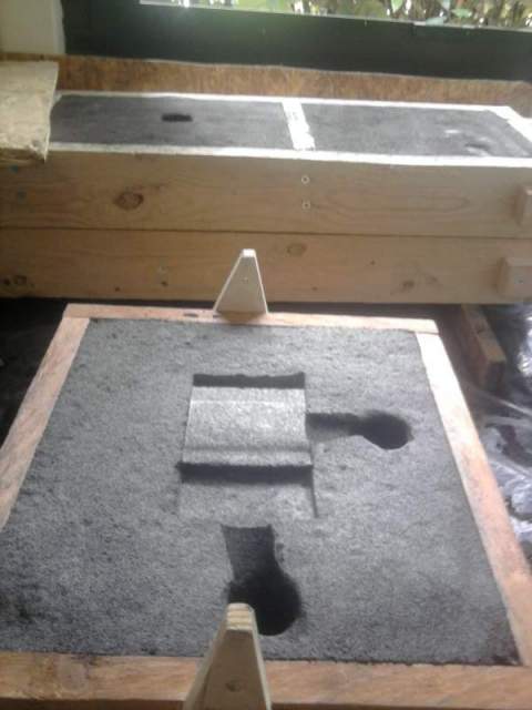

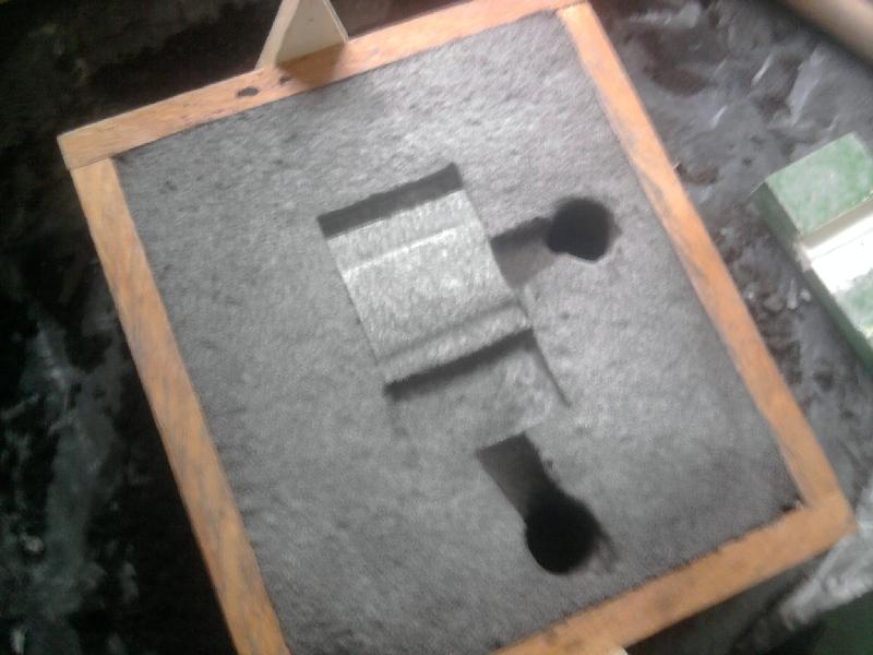

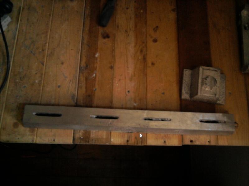

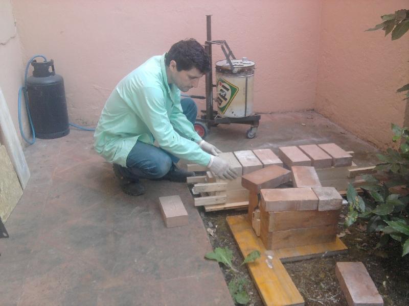

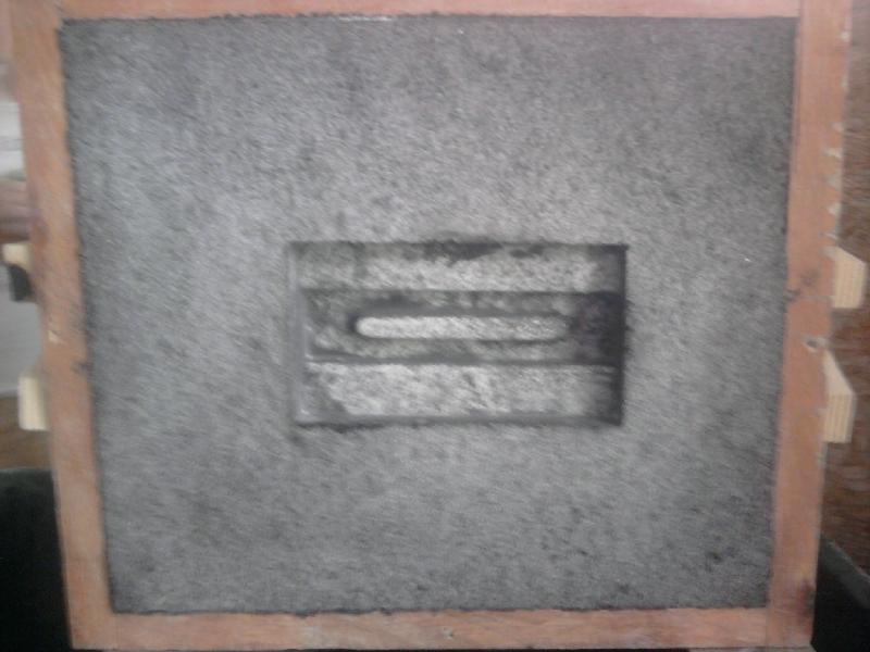

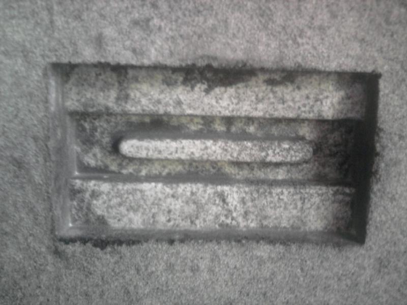

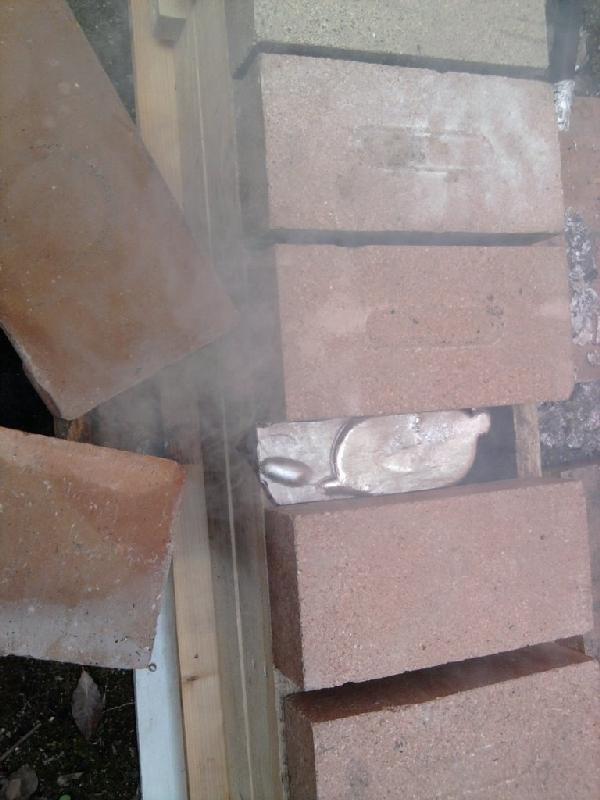

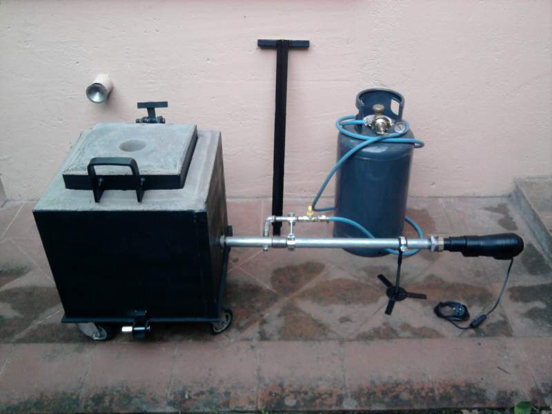

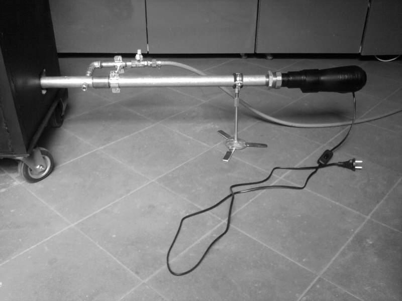

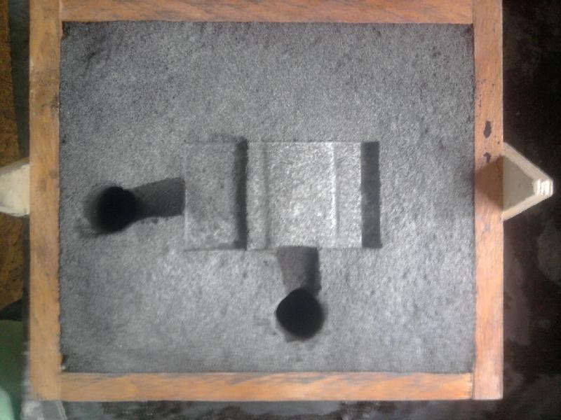

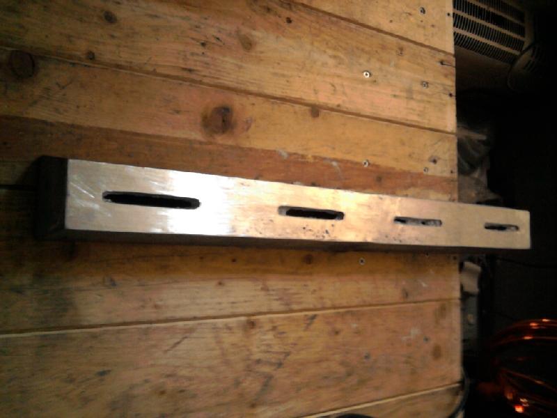

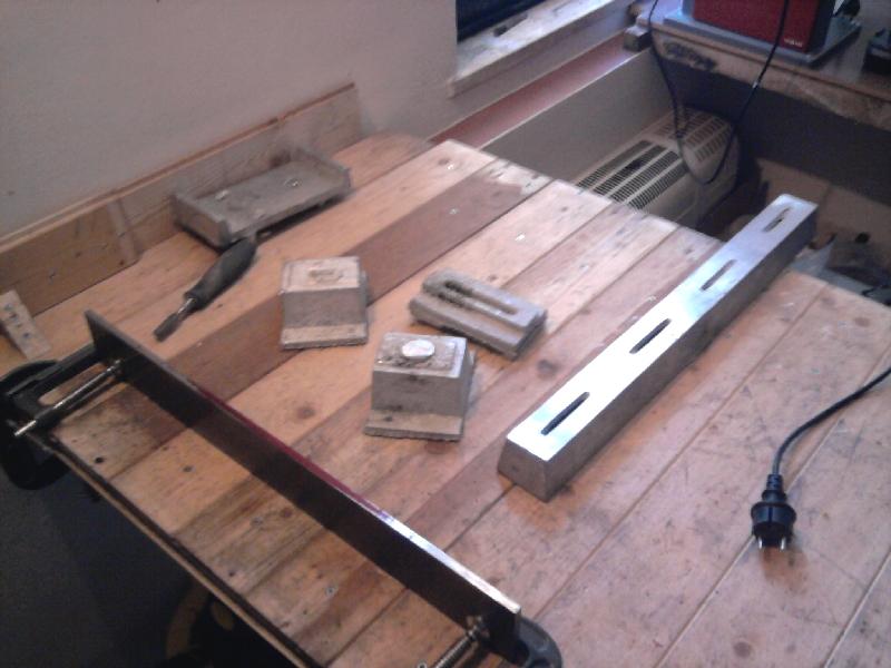

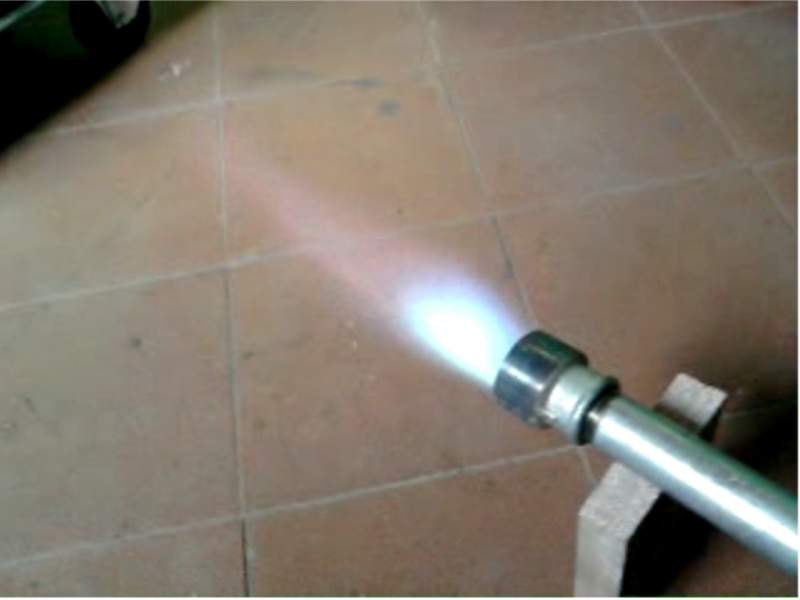

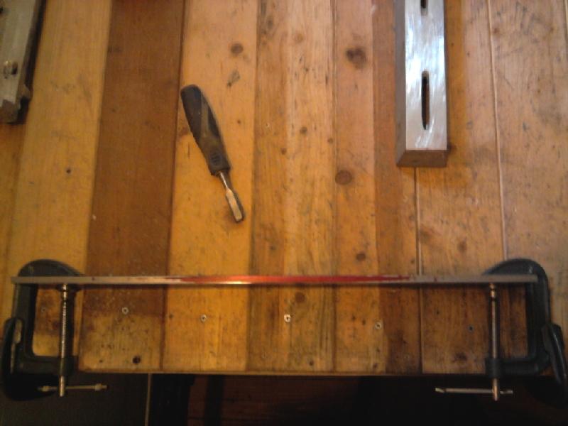

Hi everyone,
My name is Eugenio and my passion are into the foundry and machining shop type's Gingery Work's for self constructions.
In this post I can attach some pictures for recreation your eyes.
If you have any comments, feel free to let me know

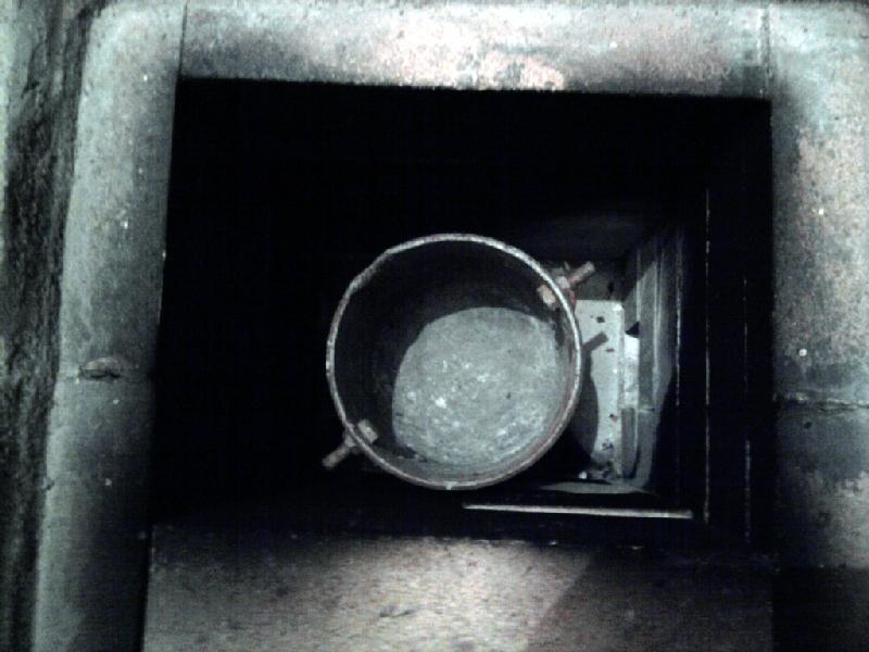

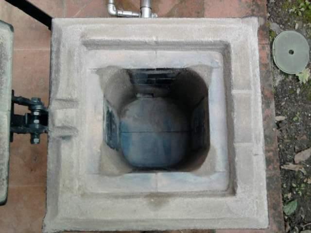

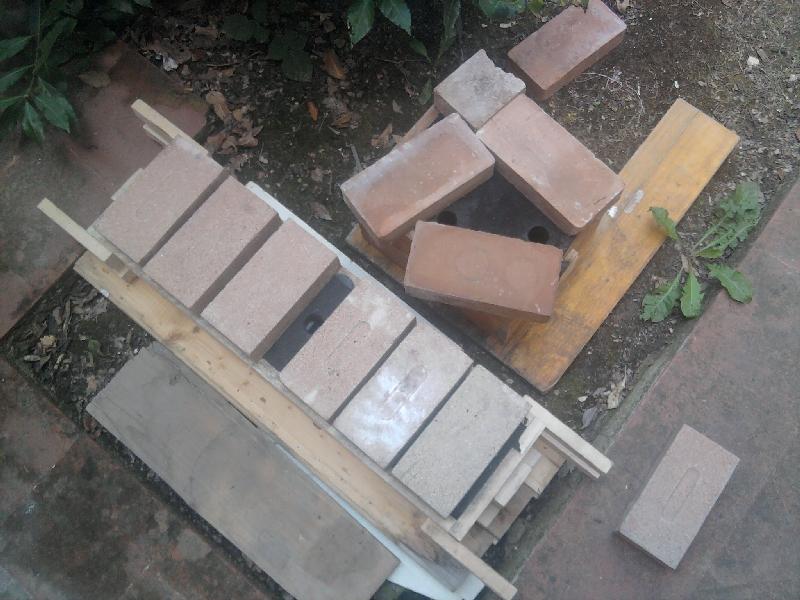

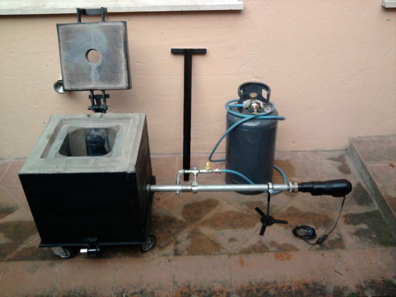

Hi Eugenio,
Nice to see you have found us.  Pretty neat furnace you have there.
What is the home foundry scene like in Italy ?
Hope to see more of you here.

Thanks DavidA for your nice comments, In Italy the Foundry  Backyerards isn't much diffused.
Thanks to passion Anglo American to promote this kind job through the internet, I and many other Italians can learn a work that in the past there was widespread in Italy, but unfortunately the big industry to made sure it vanishes. That's one of the reasons why I want to take this ancient knowledge and spread it as much as possible in my City : Perugia - Region : Umbria - Country : Italiy.

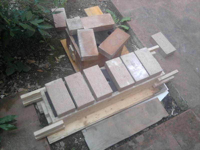

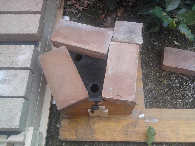

The furnace I built entirely alone, using refractory bricks, and a refractory clay mixed with silica sand that I left to mature for some months, for the fixing of refractory bricks.

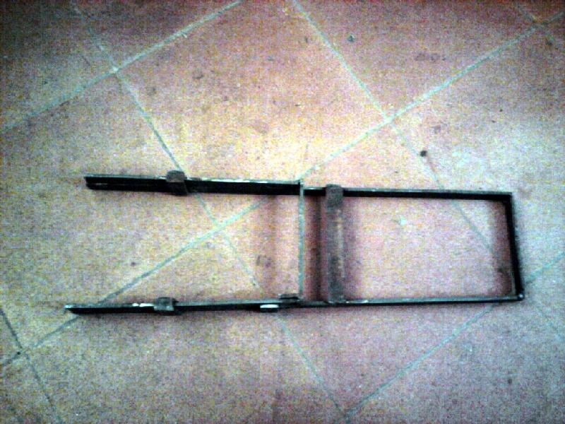

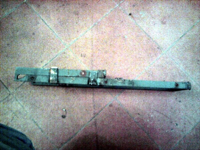

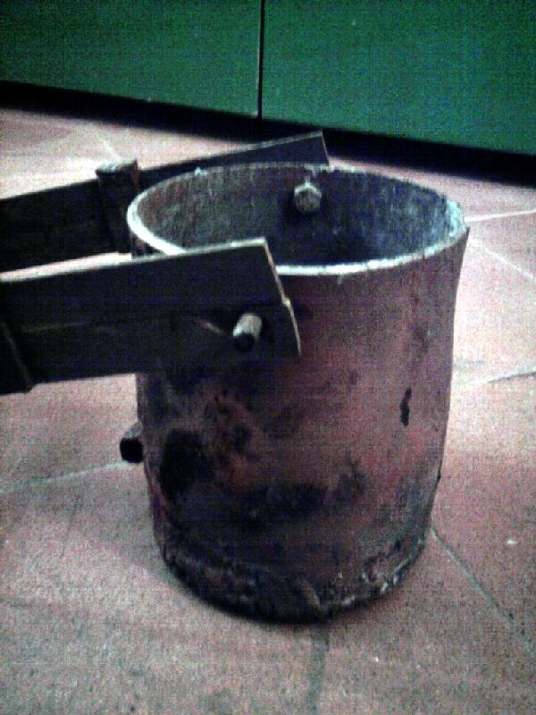

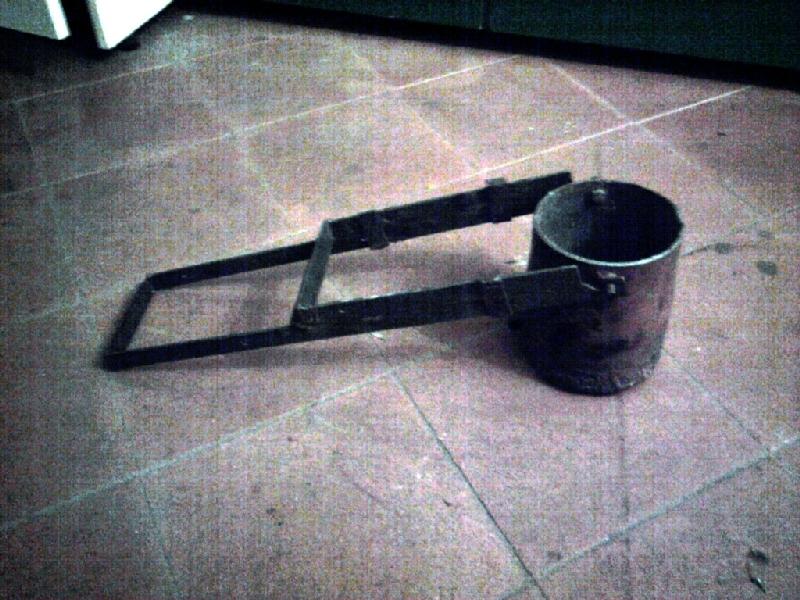

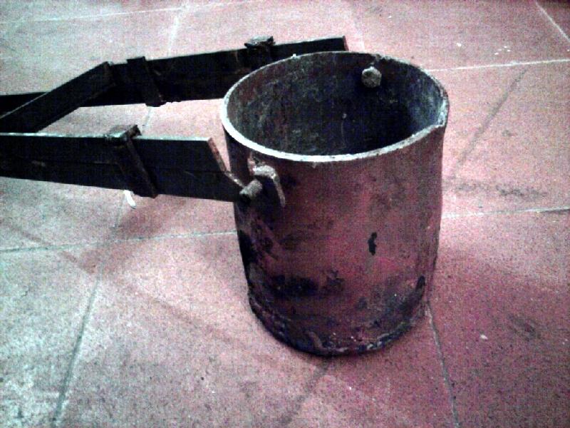

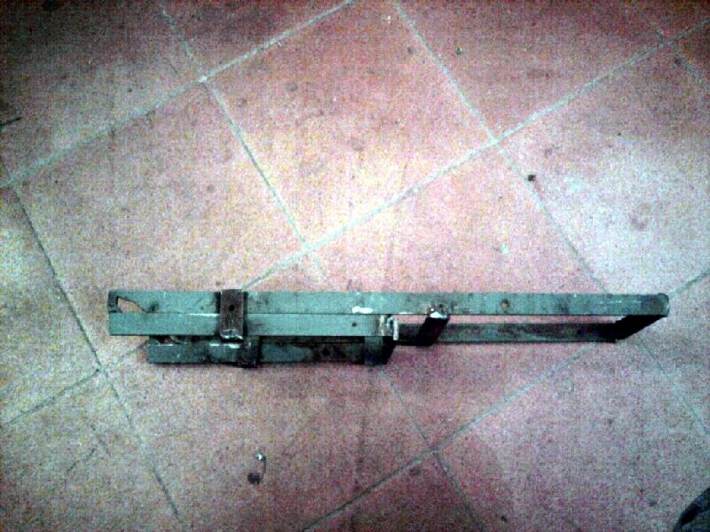

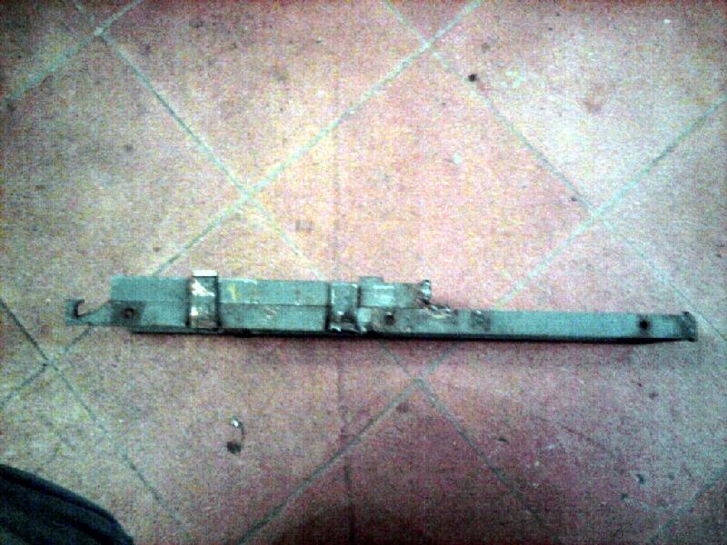

« Reply #5 on: November 26, 2014, 11:30:16 AM »

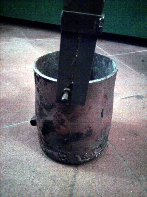

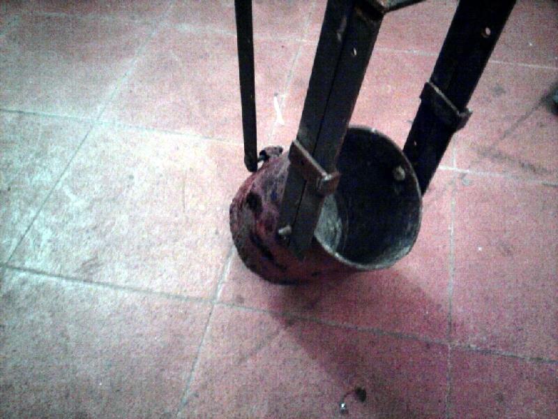

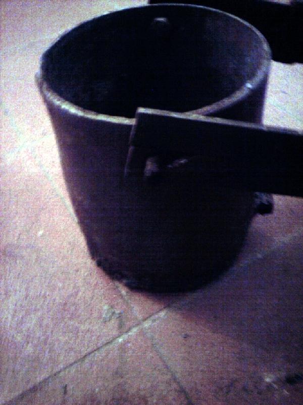

other images crucible .....

Nice to see some casting pictures
