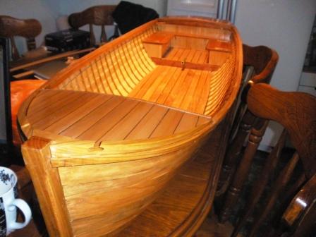

« Reply #19 on: August 30, 2009, 05:25:40 PM »
This is the progress on the launch to take my engine

bogstandard
Re: First project
« Reply #21 on: August 30, 2009, 11:40:06 PM »
Mark,
You've done a lovely job of that hull. To me it doesn't matter whether it is carvel or clinker, just being an open framed hull does it for me, but of the two, I think clinker always looks the best.
It is a shame you are going to be sticking a filthy running engine into it.
I used to sail on a sunday afternoon and then spend a couple of days cleaning the thing up again, so it looked nice for the next outing.
I would suggest make a very good insulated bed tray so the whole plant can be lifted out, so you can give it a good clean.
It isn't scale like, but it will save heartache in the end.
I found the heat from the boiler scorched all the deck planking underneath it, and the varnish disintegrated.
I eventually cured it by giving the whole engine bay a coat of epoxycote and had the tray lifted about 1/4" off the decking to allow air to circulate underneath.
Bogs

That launch is awesome.  Can you give us some more details?  Was it scratchbuilt?  Plans purchased or homebrew?  More pics, too!
Offline mcr
  • Posts: 61
Re: First project
« Reply #24 on: September 01, 2009, 05:41:30 AM »
The hull is based on the Wideawake a plan published a good few years ago in the model boats magazine.
I have modified a good bit, using the hull cross sections of the Wideawake I have changed the deck etc.
I will post one or two more detailed shots as I go along.

That Clinker is just beautiful lovely work -  clever putting the dining table in for scale. :lol:
Gerhard
