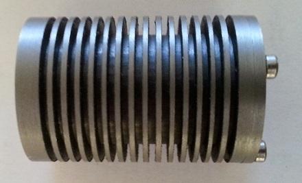

I think it must be some good stuff. First time I have used it. Managed to cut 15 thin fins on cylinder without any problems.

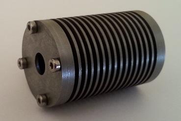

Offline ian_in_the_midlands
  • Posts: 65
Re: Tapping cast iron for poppin engine.
« Reply #16 on: November 09, 2014, 08:01:18 AM »
As you predicted, it tapped surprising easily.
Fairly pleased with progress so far.
Off now to make the piston.
« Reply #19 on: November 10, 2014, 07:58:54 AM »
So you should be! That looks spot on. :thumbup:
I've never made a finned cylinder. We're all beginners, in some aspects........  :wave:
