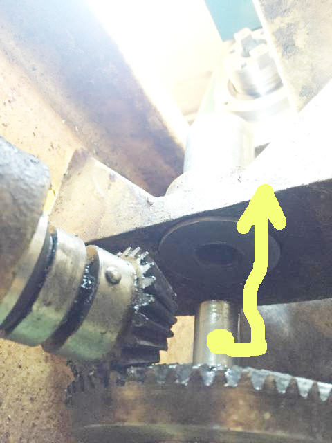

Got most of the mill painted and staring to assemble it again. Hit a small issue though.
Now I don't know an awful lot about milling machine construction but there seems to be something amiss with the knee mechanism.
The knee lead-screw is driven by a crown wheel an pinion arrangement but there is a second mechanism that operates a gear that pushes the top support bearing down.
All good so far apart from the fact that this support bearing isn't really taking any weight. The whole load is on the pinion drive shaft. Here's some pic to explain.
That's the top support and its drive.
and that's a shot from underneath.
Now this was how it was when I got it but it's obviously not right. I had a thought about machining up a spacer with a thrust bearing incorporated which would work but interested if anyone else has any ideas :)
Lee.
  • Posts: 1183
Re: Renovating the Ajax mill
« Reply #10 on: November 19, 2014, 09:18:58 AM »
It looks to me like the bearing has been forced up away from where it should be : ATM the shaft does not appear to be in the bearing at all.
I think the bearing (ringed) should be down against the crown wheel.  maybe something should push it down from above ?
[edit]
Oh hang on. What /why is the bearing part driven by a gear (rack & pinion?)
Does it have a rapid lift action for drilling ?
In which case the problem may be that the shaft has to go up into the bearing block (so look at its bottom end to see if it has been push through something that should be taking the thrust)

  • Posts: 252
« Reply #11 on: November 19, 2014, 10:18:44 AM »
I thought it may be a rapid lift mechanism but with it down the rack and pinion part don't engage so there is still no load bearing on it. The only way I can see that it may work is with the crown wheel the other way up so it sits on the top of the pinion but then I can't see how the rapid lift would work du to the pinion being in the way
Lee.
  • Posts: 1183
« Reply #12 on: November 19, 2014, 03:20:48 PM »
The more i look at it, the more i think the shaft is not all the way up,where it should be.
I think you need to strip it out and inspect it for witness marks.
Offline dawesy
  • Posts: 252
« Reply #13 on: November 19, 2014, 04:31:58 PM »
The crown wheel is butt up to the step in the leadscrew. It won't go any further down :(
Going to turn it over tomorrow and see how it fits that way round
Lee.
Offline dawesy
  • Posts: 252
« Reply #14 on: November 20, 2014, 08:48:44 AM »
Ok so I've flipped the crown wheel and low and behold it now sits fully in the support. It looks however as if there used to be a brass bushing on the bottom of the support as the crown where no longer engages with the pinion. I've ordered a thrust bearing and I'll get that installed which should work fine.
