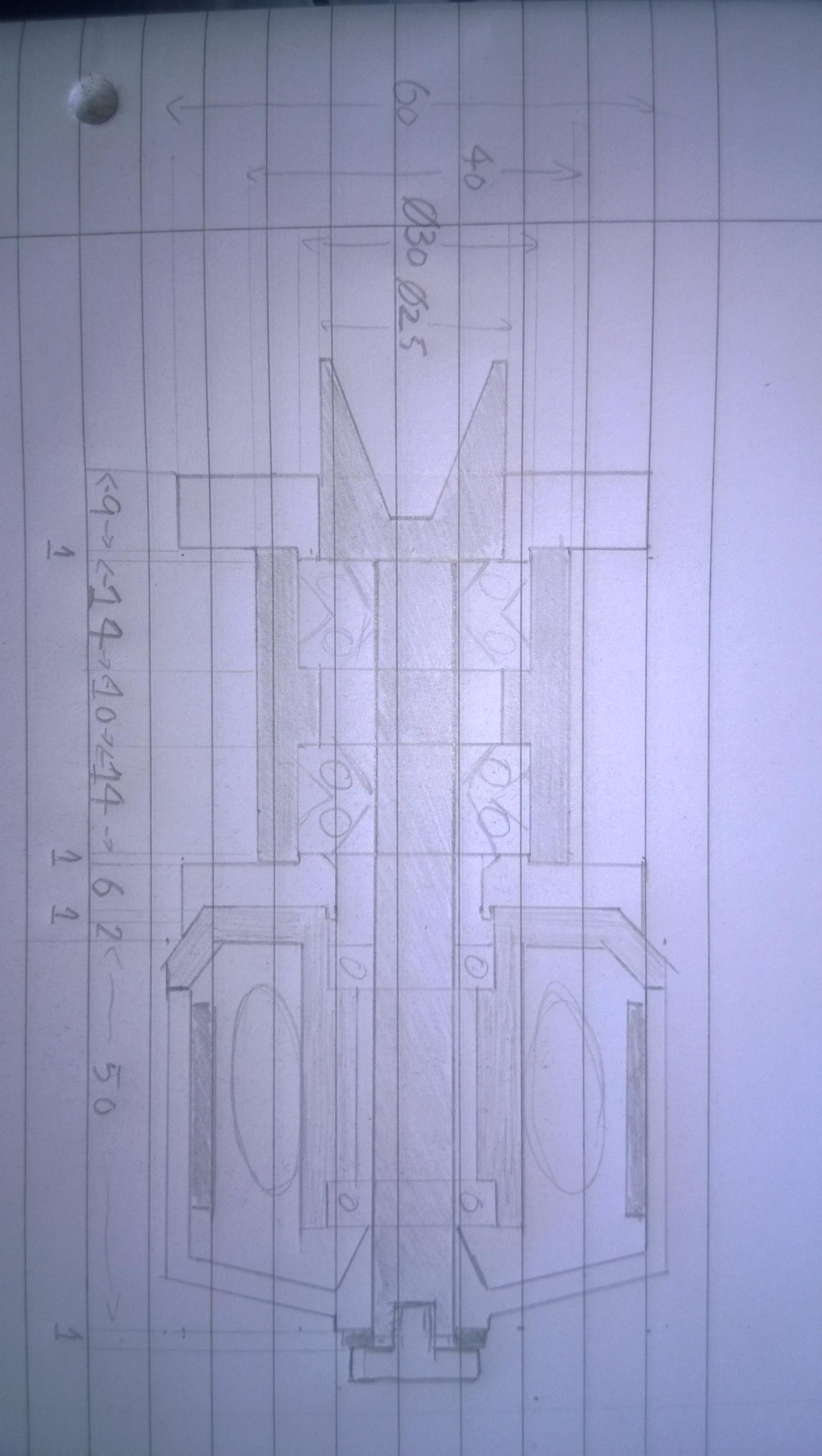

well i got a bit of time to draw things up properly and have to say im quite pleased  with my efforts
http://
blue end will be an ER20 collet red bit is the motor
planned to make it mostly out of 40x10mm flat stock, witht the spindle being made from 40x40. height isnt yet set as ill have to do a few more measurments on the actual lathe and work out what is practicable.

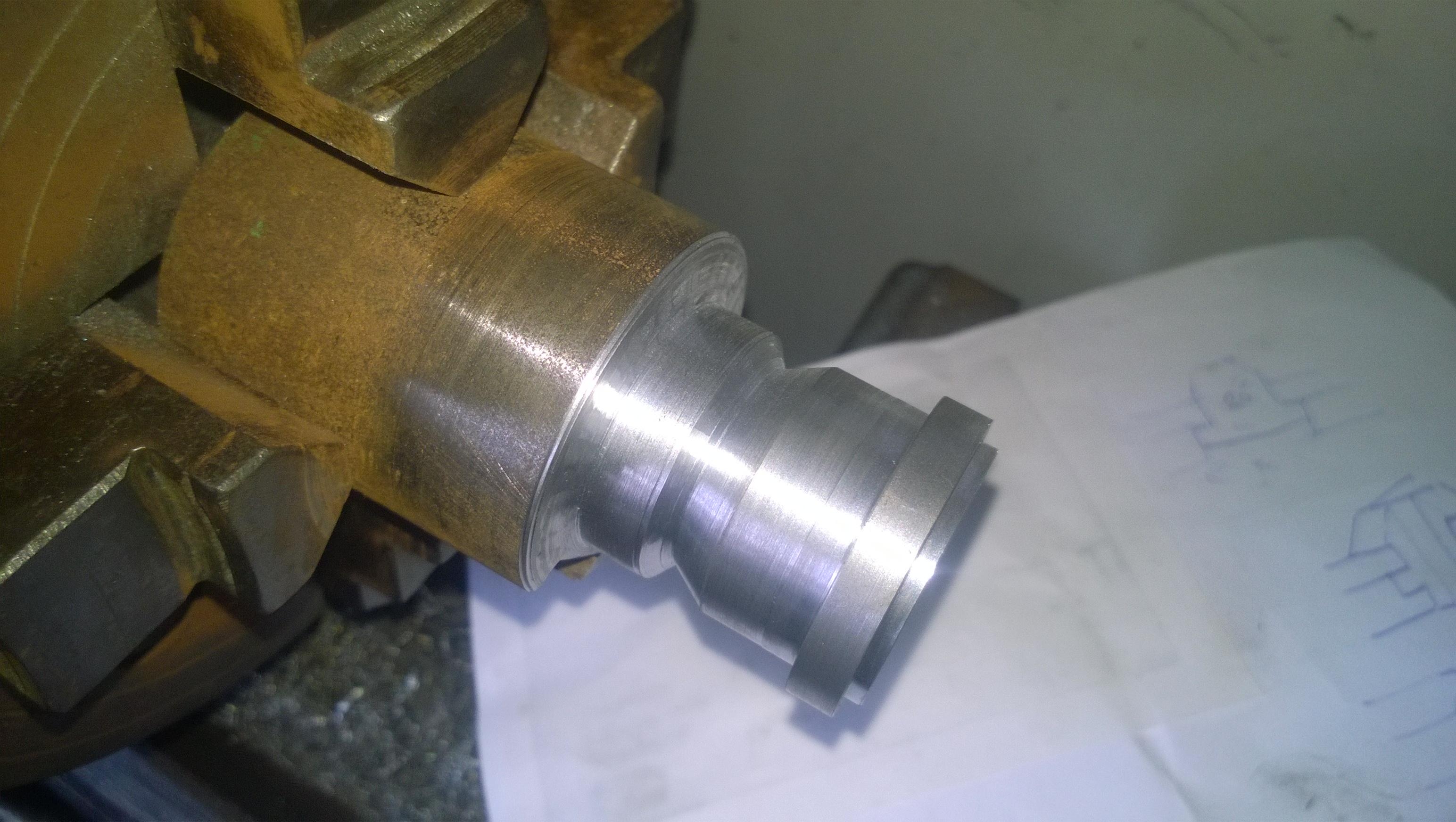

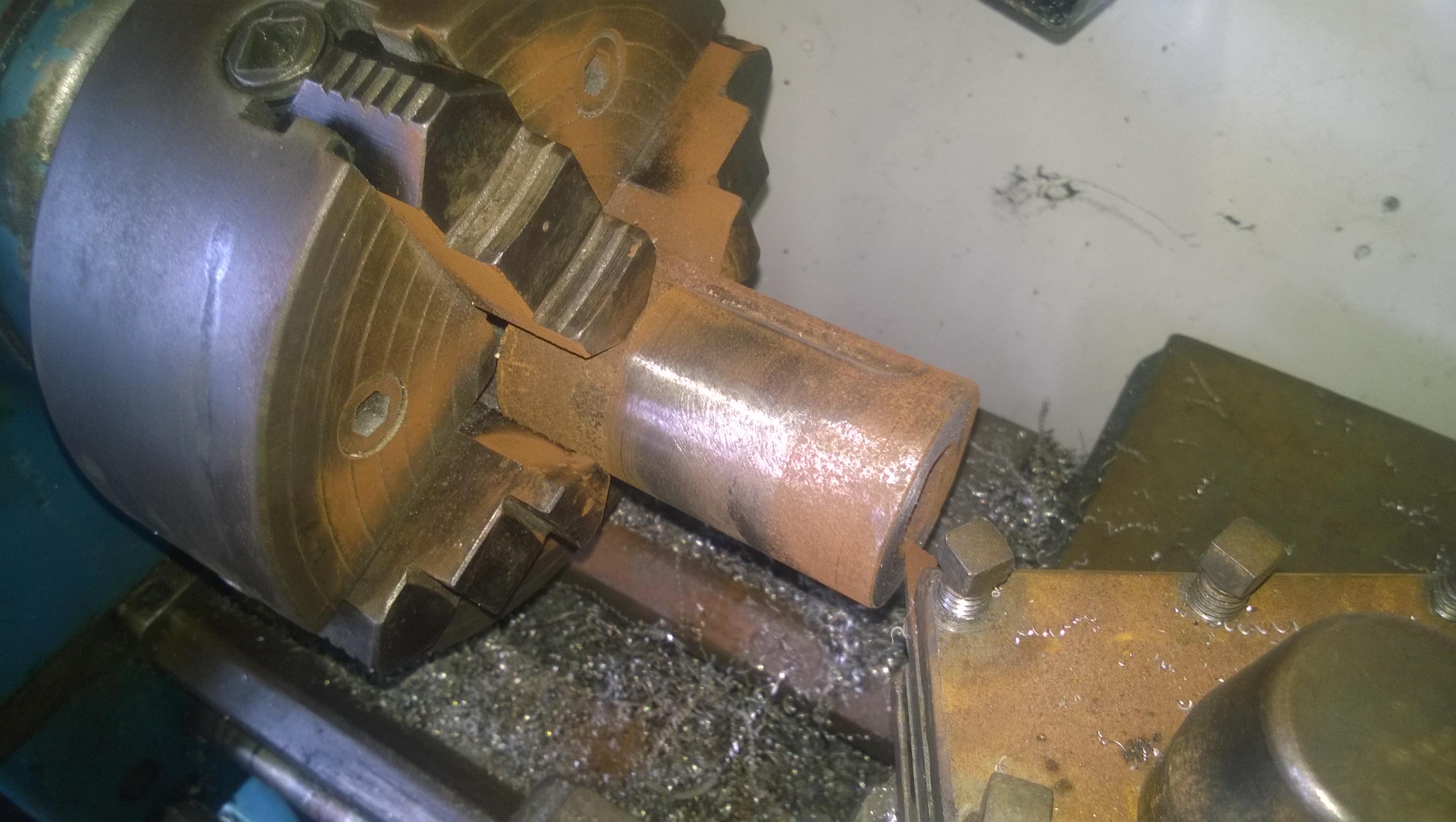

Well I started making swarf a couple of days ago, had to modify the design slightly to get the bearings and motor to fit on the shaft length. Also added some registration between the parts to aid getting everything lined up. Now just waiting on some M4x 60  bolts to hold it all together.
Iv not actually measured the shaft but it slides easily into the bearings, so ill have to use some bearing fit anyway. I'll have to see how soft/ hard it is as I could do with tapping the end for a locking bolt. Surprisingly the shaft is also hollow so wont be as strong as it could be .

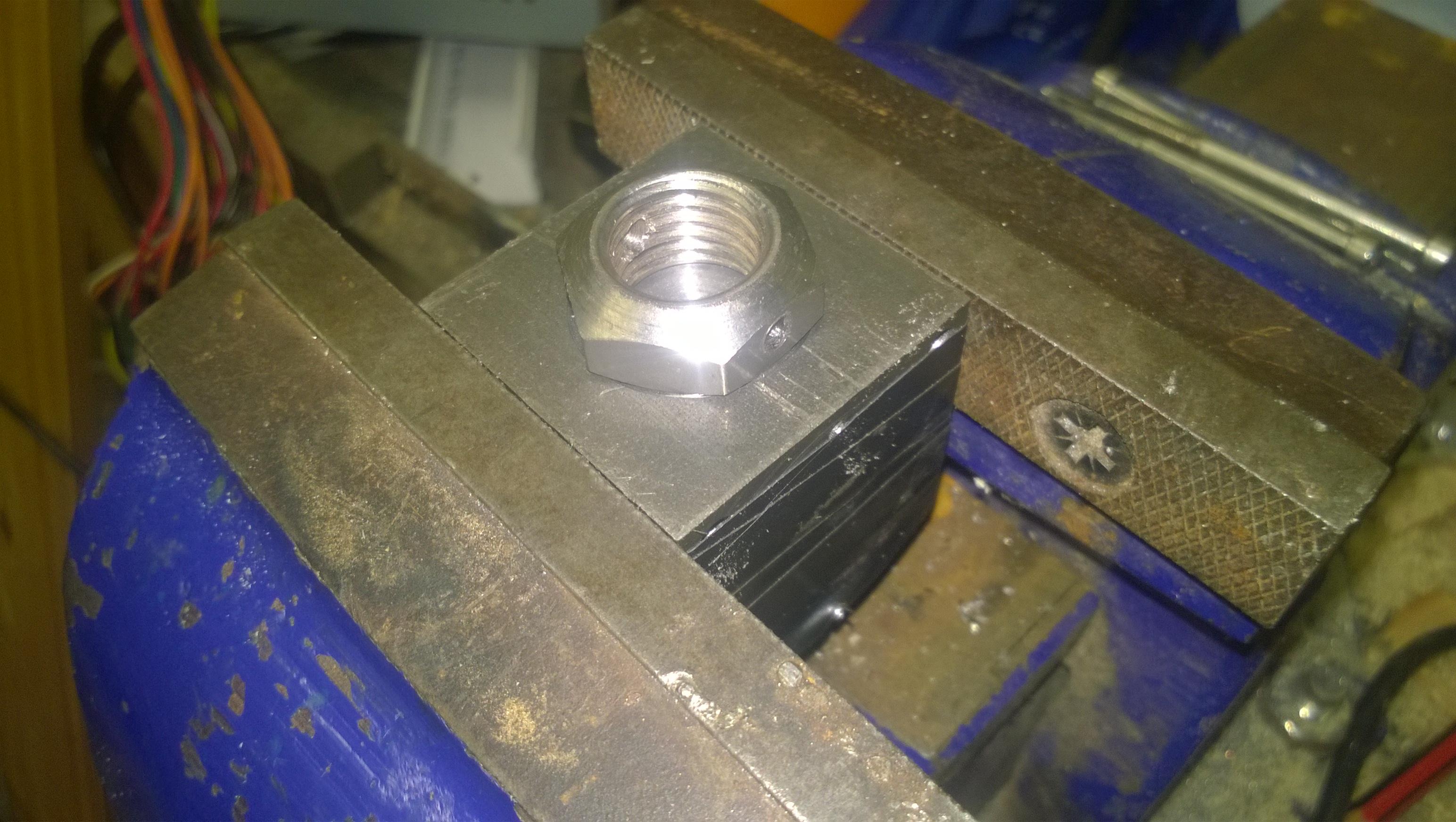

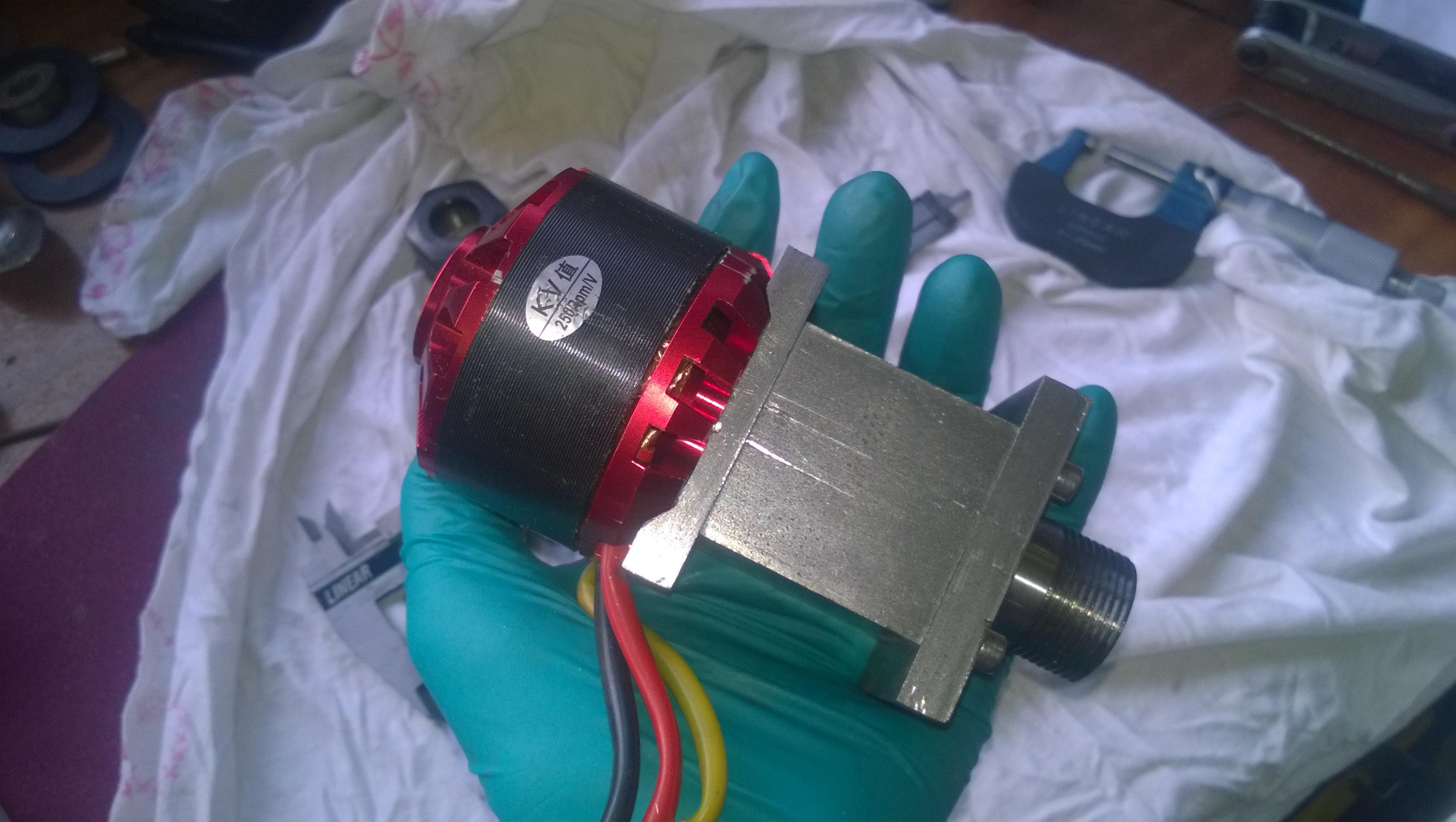

bolts arrived today so managed to get everything bolted together and ended up with this!

well managed to get a bit more time to play with things tonight and knocked up a 12v supply for a test run
didn't run it long as it needs stripping down and fettling, but all in all a good result I think.
seem to be running low on metal though so the actual frame may take a while longer to sort out.

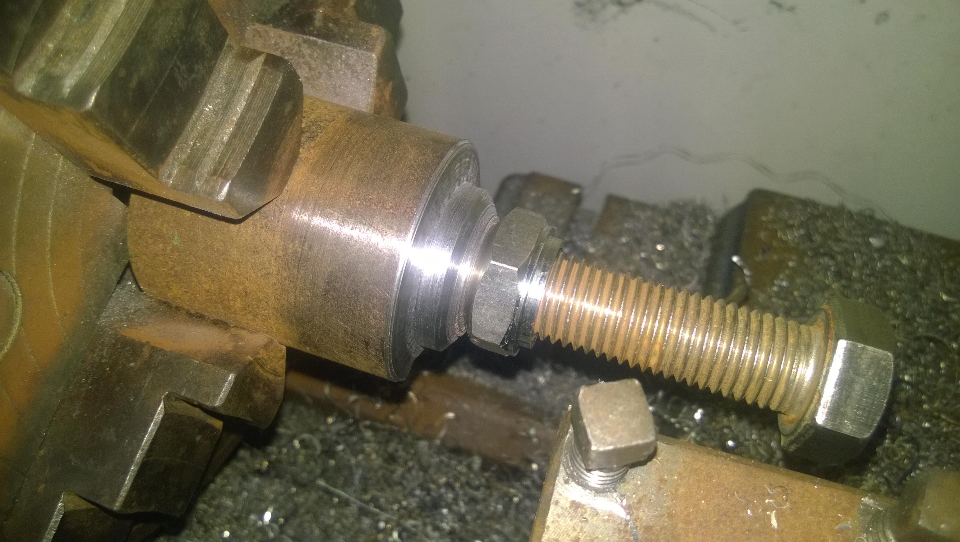

iv managed to tap a short 6mm thread in the end of mine so can use a bolt and washer to add a little pre-load against the end of the bell housing, that should give the motor bearings some pre load to stop them skidding. I may add a small fan to the end as well to aid cooling
ran it for bout an hour this morning, was nice and smooth and only got warm to touch so I think its good to go as is. just need to finish up the z axis screw and fabricate the actual body.

Had a spare couple of hours today waiting to pick someone up so decided to make use of my time and have drawn up a scale drawing of what iv made, shows most of the important measurements a d details

im sure iv seen at least one person not bother with extra bearings, or even collets, just outing a milling bit directly into the motor!
iv also seen other with plain ball bearings used to take up sideloading. In my case I couldn't see a reason not to use the double row AC bearings so that's what I went with.
for your motor size I think skate bearings may be the easiest option?
you do need some sort of bearing housing, even if its just to hold onto the thing! got to remember the outside spins round!
as far as I can make out the usual application for these motors is for the rotating bell to be the front end, with a prop shaft bolted to it. the original motor shaft seems only to be there for the bell to rotate on ( why it sticks out the back end iv no idea though)
in our case I think we are actually using the motor backwards ?
a lot of the designs out there are for home made cnc machines where they seem to be striving for perfection when it comes to stiffness and runout. personally I think its overkill for hobby use. if it spins and cuts without shaking itself to bits id say its good!

Bertie,
So my two separate angular contact bearing may be an easier solution. I'd like to keep the flats accessible. Just a thought, the chuck is not hardened, you could drill holes for a "c" spanner a little closer to the thread.
Post some pics so that we can see the progress!

It wasn't. So much the bearing size that dictated the length of my bearing housing.  Its purly down to the fact I based the design around 40mm stock. If id stick with my original plan the housing would have been 40mm plus the 2 end pieces making a total of 60mm  thus only 40 for the motor. The beari gs are still where I originally wanted them with 10mm spare between then so I could have made it all smaller, but then I don't think it would have been as sturdy.
I may have asked befor but what thickness are the bearings your planning on?
Not really done any more progress tbh apart from locktighting  the bearings inn place ( big mistake  as I still needed to dismantle to weld a nut on  :bang:  )

« Reply #37 on: March 24, 2015, 08:15:27 AM »
Bertie,
Single row angular contact 10 x 28 x 8. I'm going to make the body from home cast Al with a standard electric drill 43mm to mount on. I haven't drawn it up yet!
Regards, Matthew.

Made some progress lately, turned up a screw nut from a lump of old motor shaft which happened to have the right thread in it. And turned up a nut to be welded to the spindle body.
Welds look ugly but they will hold I'm sure
Have ordered the rest of the metal up for the slide and base. Just waiting on delivery befor I can make any more progress.

thought id pick this project back up while im waiting for bits for the new mill.
first I cut up some more stock and bored it out to fit the screw nut id previously made
left the bore a bit shallow so I can use a bit of gasket to get the clearance done to a minimum and hopefully avoid to much play in things
iv not got anything to make the round base out of so for now iv decide to make it fit onto the compound topslide. With a 6mm base plate the center of the milling spindle should be on center height with the lathe :)
 so cut and filed some 6mm plate to fabricate a big t-nut and cut a base plate then sat the spindle on top to see what thing would look like, and found a small issue :doh:
id forgotten the motor was bigger then the body :Doh:
also with the spindle where the tool post should be I can only go 18mm past center before I run out of screw  :Doh:
so after a few choice words I started weighing up my options
1: raise things up another 6 mm, motor now clears but spindle is 6mm above center height
2: rotate the spindle and compound 90 degrees  so that motor has clearance, get me back on center height, plus can use the topslide to give extra reach. lose the fine infeed though
3: go back to original plan and remove compound, still lose fine infeed + limited reach beyond center
4: find a smaller motor? took me long enough to find this one
5 : drill and bolt the new spindle to the back of the main slide - lots of hassle but would gain height and reach
6: anything iv not yet thought up
currently thinking of No2, as it give the most advantage with little disadvantage- can feed with the apron instead
iv also decided on a height of 200mm for the vertical slide as this is a 5 1/2'' lathe so 200 will clear the biggest part ill ever turn
