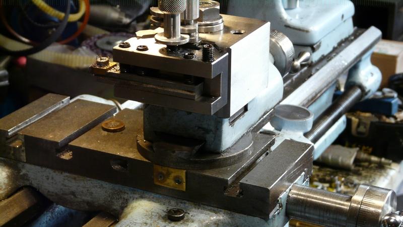

One thing I forgot to mention is the current tool post has a 2  1/2" circular boss that it sits and spins on ( I'll get some pictures to show this) would this have any effect on tool post choice? Or would it need milling down to give a flat top to the compound slide top?
Lee.

« Reply #7 on: October 27, 2014, 04:40:27 PM »
Post a picky up.
Whether top slide or tool post is cylindrical wouldn't matter as long as flat. Probably will have to change the thread for tightening up, worst case mod the base to a T slot.
Modified my M300 to same fitting as Harrison 140 that does have a T slot. That way can just slacken off 1/4 rev and pull whole toolpost out and load another in. Downside Is no 90 degree indexing. The piston type Chinese QR toolposts come with this T fitting.

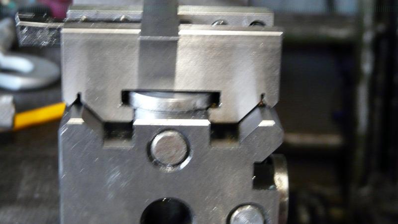

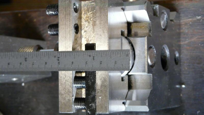

Offline dawesy
  • Posts: 252
Re: How to size up a quick change tool post
« Reply #9 on: October 30, 2014, 10:15:41 AM »
Ok so  I've took a couple of photos.
That's the raised boss I was talking about.  The two sunken cap heads you can see attack to the lead screw nut.
That is the distance from the top of the compound slide to the top of the tool bit. The tool but is in centre hight.
Lee.
« Reply #15 on: November 14, 2014, 11:01:45 AM »
As RDG where out of stock I bought one from Chronos Boxford size made by Soba , the tool holders are 73x32x30 and take 16mm tools , the heighest the holder will go is 25.5mm from the base to the bottom of the tool , on my lathe a 1\4" tool leaves a small pip , the largest that the base can be bored out to fit your boss is 1 1\2" , hope this helps .
