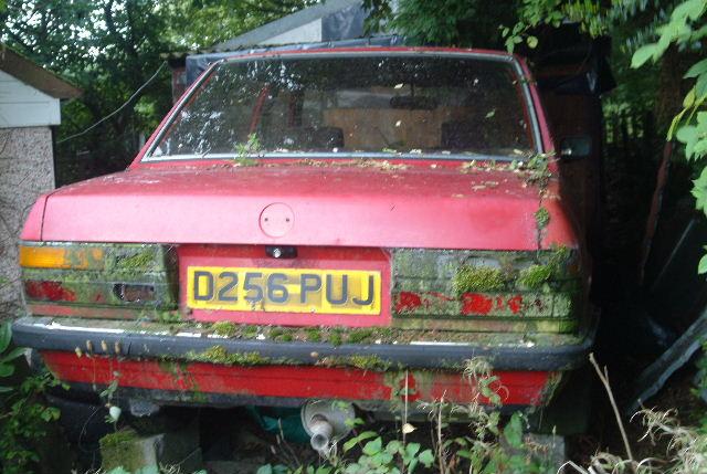

This car looked very good on the forecourt. No obvious rust.  It drove well and , apart from a whine in bottom gear,  seemed reasonable.  I parted with £999 and drove it home. My daughters thought it the best thing since sliced bread and even my wife liked it.
Next morning it wouldn't start.
And this is where I made my big mistake.  Any sensible person would have got the vendor to take it back and return the money,  But as I was a mechanic,  I fixed the fault (no power to the fuel pump) and kept it.
It ran ok for the first three month.  Then I started getting problems with the engine not responding to the  accelerator properly. It turned out to be a sticky Mass Air Flow valve.  But by now I was getting fed up with the deteriorating reliability.  So I bought another Citroen, This time a ZX Diesel,  and we lived happily for years together. The BMW was put out to graze on the end of the drive closest to the shed and left to rust in peace. This turned out to be a move that had mixed blessings,  as you will find out.
I recently looked at the old tax disk and it read 0602.  So this 28 year old car had sat there for about 12 years.  But then (in August 2014) I bought my latest toy,  The Denford Viceroy. And that is the real start of the story.

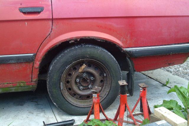

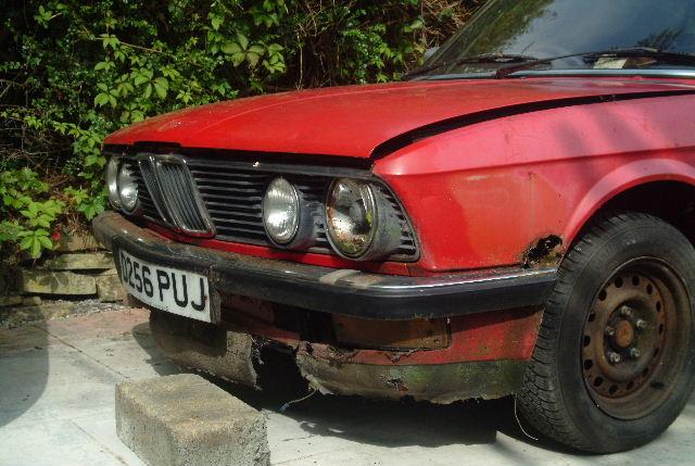

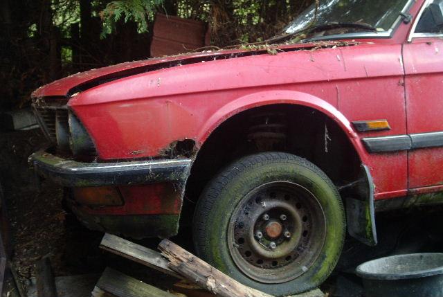

After giving the car a serious coat of looking-at, I decided to give it a go.
The floor pan and most of the body work is not too bad.  But where it is bad it is rotten.  There is a lot of surface corrosion on the sub frames and rear suspension parts.  But nothing that copious amounts of elbow grease can't deal with.
I ordered up a new front of-side wing,  both sills,  both rear wheel arches and a front apron.  Total cost about £240 . There is a very good company who import this bodywork from Denmark.
So,  where to start ? Start at the back and work forward.
First job,  remove all the rear suspension etc.  This will allow easy access when replacing the fuel lines and fitting new brake lines.

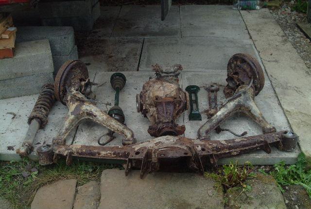

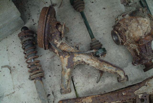

Succeeded in removing all (with the exception of one shock absorber) of the rear suspension.
Surprisingly all the bolts came free with very little effort. Good German steel.
With the suspension out of the way I can now replace the fuel lines and make a start on fixing the bodywork.
Fist though, the suspension needs to be de-rusted and painted.
Below are a few pics of the suspension as it is now. The last picture is a before and after comparison of the tie bars.

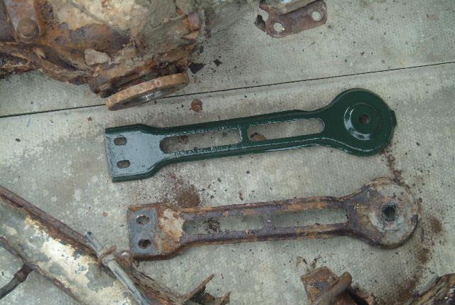

So what did you do to the tie bars to restore them? Looks pretty nice...
Re: BMW E28
« Reply #12 on: October 03, 2014, 05:16:31 AM »
Eric,
I scraped off all the loose rust with an old chisel and the edge of a file.  Then used course abrasive tape to get right down to the surface.
After having removed as much as I could this way I painted the whole thing with Lock-tite Rust Remedy, a phosphoric acid rust neutraliser.,  scrubbing it in with wire wool.
Left it to work it's magic for 48 hours then went over the whole thing with 120 grade abrasive and finally gave it two coats of the green outdoor paint that you get from Aldi.  This paint has a rust preventative in it and seems to work very well.  Also it is tough.
With the bigger items I will use my power tools to de rust.
One thing I will mention.  When I did the propeller shaft I discovered that someone had lathered it with wax oil at some time in the distant past.  They had done a pretty hit or miss job of this and the result was that where the wax oil had been applied, the paint underneath was in almost new condition.  The rest was lightly corroded.
But removing the dried out wax oil was a real pain. It just kept coming back.
I finished up scraping it all away.  Then used panel wipe to remove the remaining coating.  And it still kept re appearing. It took ages to get it all away.
In future I think I will burn it off with a blow lamp.
Oh what fun we have.

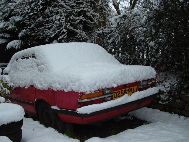

Well, got all the rear suspension bits off the car and in the shed.  Found a broken coil on the near side shock absorber. more expense.
But now paying the price of a bad decision.
I was stood out by the car,  wrapped up in overalls and fleece, thinking 'my but it's cold'.  I really aught to have re jigged the shed to allow me to do all this inside. Nice warm stove in there, coffee,  radio etc.  And it is still November, most of winter yet to come.  And there is the BMW,  immovable with no rear suspension.
So,  big change of plan.
An annex to be built onto the side of the shed (quick and nasty,  just to hold 'stuff') and the machine tools to be moved to one end out of the way so I can get the car inside.
Hell,  I'm seventy,  why did I even consider doing it outside. Idiot.

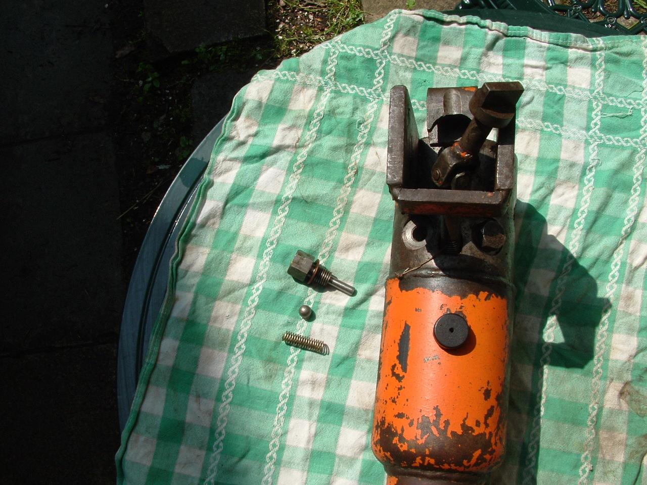

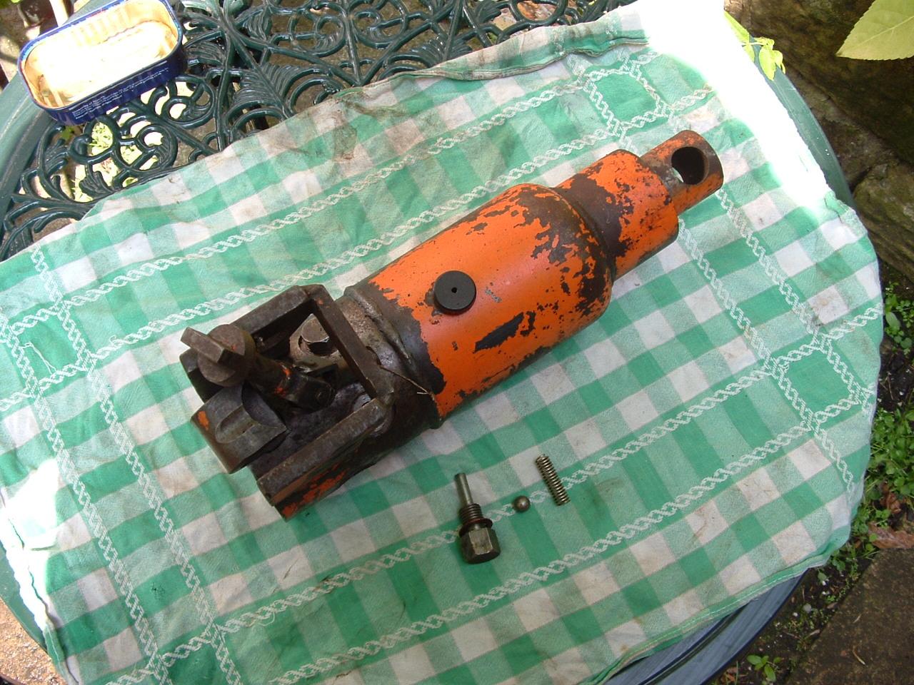

« Reply #24 on: June 09, 2016, 08:01:01 AM »
...My big problem area is procrastination.  I tend to spend more time thinking about a job than doing it.
I wrote that line some time back. but as my Citroen is due for test soon, and it will fail unless I do a lot to it, it is time to get on with the BMW.
But I have a problem.
I have a big trolley jack One with about a 24" lift. Very useful for this kind of work.  However it stopped working a while ago and my son decided to strip it and fix the problem.  He then left to work away and didn't reassemble it.
And I can't get it to work. It should be simple enough, but as he took it apart, I don't know how the ball valve assembly works.
Does anyone have any idea how it goes back together ?
I don't know if the spring in the picture is part of the thing or not. It doesn't look like an original part.
Any advice welcome.
