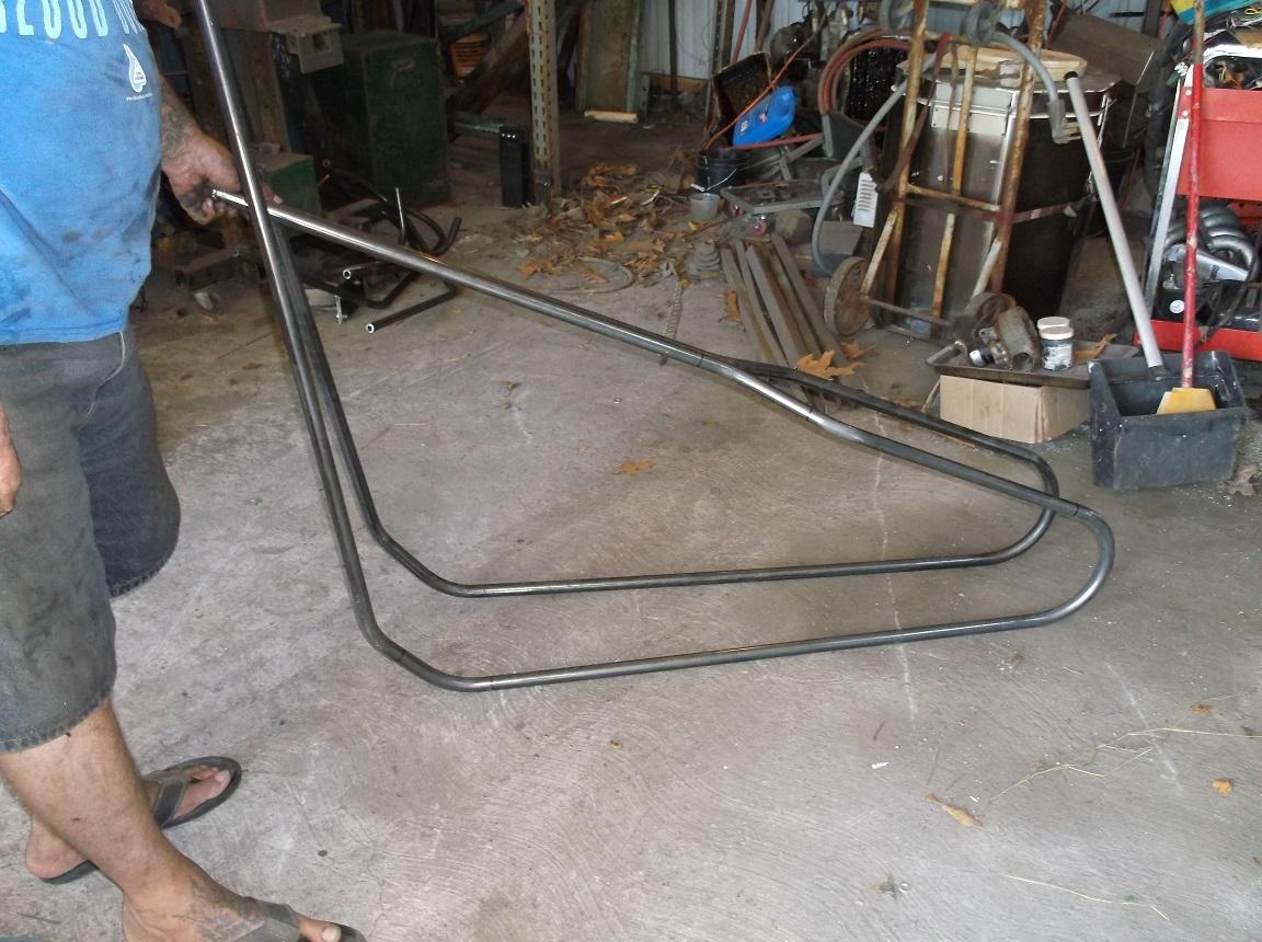

A local buddy wanted me to make him a cushman eagle frame. I found one in a museum and copied the bends and turns. ORdered the tubing from a local supply @ $21 a 20 foot length.. It takes 12 feet to make the main loops of a Cushman frame. I got the 3 axis tube bender out of retirement, hung it up in the ceiling. NOW manual, since my Canuck buddy took the PLC off it back to Moose-land.
I can share the measurements if anyone wants them to do it themselves. This is the Eagle fabrication tips video I made, it leaves a lot out I guess.

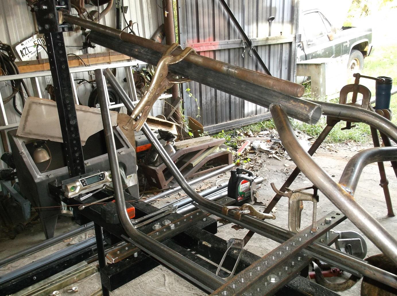

Hey, Check out this bobber frame, note that the turns, go all the way around the bike..
THE rear end has no immediate welding, just put a lap plate in the curve. (saw a drag bike like that once) it reinforces the rear end.  BUT then it turns up to the seat mount, turns inside narrow to go under the gas tank.. all two pieces of tubing. Does away with all the jigging, just clamp it together there under the tank and tig weld.
Simple. But it had no bids on ebay. None.. too unconventional. I may put a harley front end, wheels, and a 150cc engine on it to just mess with people. Or that Quad4 Pontiac engine for a inline Indian clone?? tubing is kinda small for several hundred hp thou.

Can you see to tig weld?? I can't anymore.. I tried this morning, then got out the mig-splatter gun.. FOR structure I hate mig, the first one of them I got way back then. I built a bike trailer, then took a hammer and broke half the welds. it was a simple transformer type.. this one sets up the same.. click to change coils inside the mig for different power.. the CC CV ones  are much better.(and more expensive) the big wire feeder that goes on a tig, much better.
Anyways.. if you can see and weld.. get into your car, let me know when, rent a motel locally and show up at daylight after we coordinate the tubing arrives at the same time.. YOUR COST = Actual Expenses. Leave with a frame made on my frame jig.. which I am still modifying daily.. am fixing to put a plumb bob top rail on it I think..

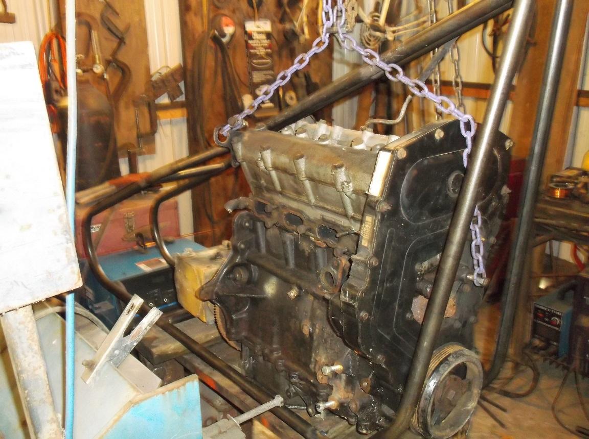

Well, the wife did say she did not want me to have a Hayabusa after one smoked my drawers going down the interstate.
That's a early Quad4 bought years ago and stored under a bench. all forged internals, the newer ones are cast crank, rods, pistons, it costs a grand to rering one of these properly. Coupled to a six speed it should be just about right. Indian inline-4 copy.. big swoopy fenders.. sounds like fun to me.

USING THE Model3 tube Bender$ HOW TO construct a motorcycle frame:
  My bendtech SE software by 2020 Software solutions was sold to me in early 2000's by Cris. Obselete now. WHen you use the software you shoot at targets like a gun, measure a "thing" you want to copy bend to bend, take a protractor and measure the bends and check them against your results.  It generates Distances, Rotation, and Degrees of bend.
  "distances which you mark on the tube" You slide the tube into the bender and locate at each mark for each bend, read the rotation off the protractor clamped to the end of the tube (which in this case is incremental with a reset at each bend) then bend to the degrees called for on the bender shoe plus spring-back of tube, Release, advance to next mark, do it all over again.. I have to keep a bend sheet to keep track of where I am.
   The software is user calibrated for a mandrel shoe, in the normal MC frame here I use mostly a 4.5 CLR (centerline radius) shoe. It normally calculates for this and hits it pretty well.. most of the time.  IF the nose clamp is not tight, the tube will slip in the shoe as it bends, messing it all up.. unpredictable.
  One of the cool features is you can check a "reverse" bends box and it will.. do it all in reverse order.. having a long uptube sweep hit the bender, of the floor is a good reason to do this.. I used my bender in the vertical mode for years, now it is laid back down and rotates clockwise parallel to the floor. (easier to swap out dies)
Preparing to WELD: just like paint, the end result is in the preparation, fish mouthing tube in the shape of the connecting joining tube, making tight accurrate joints to weld, on real thick tube, you bevel the ends to get a deep penetration and build the Vee up with good weld.  They make some great new tools, which I don't have, one is a pin template you wrap around the tube, slide the pins up to the ajoining tube, set them, then index it upon the tube to fishmouth, mark and transfer the pattern, cut and weld joint.
Welding, I prefer Tig when I can see.. I suggest tig or oxygen acetylene cause it is more flexible, less brittle, less slag in the weld.  I learned to tig from a Alaskan Pipe welder on a buzz box.. REAL HOT, you use the filler rod, dipping in the puddle to cool the puddle and run like hell.. because I learned this method I have a hell of a time welding thin stuff.. I want to press the go-amps pedal and run like hell.. OLD habits, and old dogs I guess.   I try to use a new self taught method these days.. Doo Doo Dah.. dip dip, heat puddle, dip dip, heat puddle, feather pedal, keep it wet..  Like Jim Spradley "Henrob Jim" (henrob, Dillon 2000 gas torch) said.. it is all about the puddle, the wet spot. No reason to worry about the whole weld, just the lil spot you are on and molten, as you complete that puddle there, move on.
