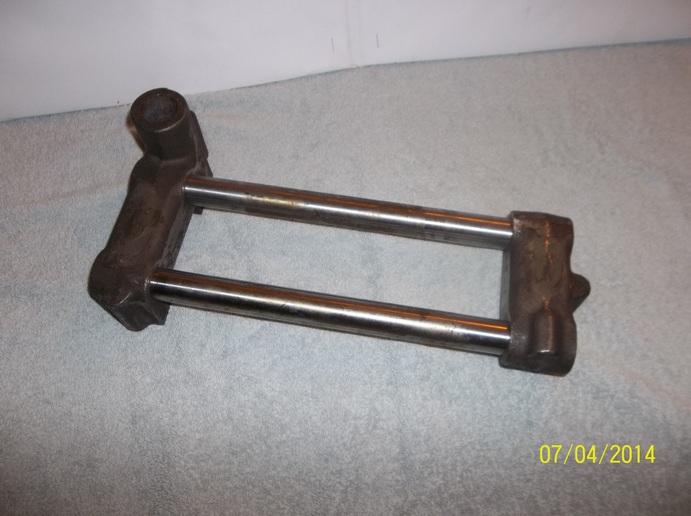

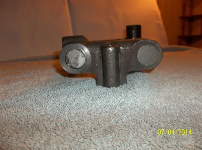

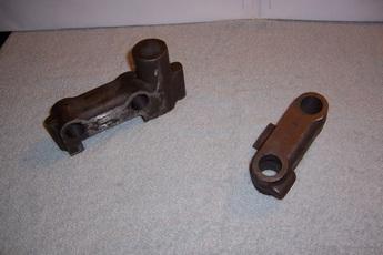

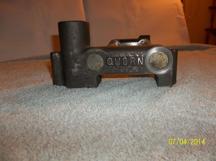

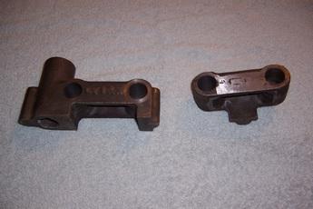

Got in the shop and was able to machine the base castings. The 1 inch bars are ready and fits nice. I started to machine the bases and looked in the lower drawer of my box to find two adjustable reamers, one too small but the other one has a range of 31/32 to 1 1/8 inches. How sweet when things come together. Here is a few pics.

« Reply #3 on: July 15, 2014, 11:37:56 AM »
Hi Nelson,
Have you thought about using split cotters on the castings instead of splitting the casting it's self? I've seen this proposed as a variant by quite a lot of Quorn builders and although I haven't built a Quorn, I've used split cotters quite a lot and I find them far superior to splitting a casting and using a pinch bolt.
This is shown in 2589 CotterLocks.pdf from "The Model Engineer" Jan 1961, the one in fig 3 is the most aplicable in my opion.

Re: Quorn (Corn) Part 2
« Reply #4 on: July 15, 2014, 07:15:59 PM »
Matthew
Thank for the kind words and yes I am going to use cotters instead of slits. My thought is why make a point of grit to get into when you do no need to. The only slit I'm going to cut is the spindle mount. The spindle is enclosed so it will not hurt anything. Also some of the spots I'm going to drill and bore at an angle so a cotter can be used.
David
I looked at one for years before taking the dive and well I in too deep to stop now. I believe it will be a big asset when finished.
Cheers All
« Reply #5 on: August 17, 2014, 10:20:24 PM »
Matthew
I plan to using cotters everywhere. The casting that are to be slit, I plan to bore at an angle to the shaft. The front bar I feel it will be a plus because of the angle bored will tilt it to a nicer clamping point. Several I looked at and apply the same boring at an angle to meet the shaft to hold with brass cotters. I am having a great time with it. I've made the thimble and making the cap for the right outside, the dust covers for all the others on the front bar. When I get everything I'm working on I will set the back bar in lock tight and well keep on forward till done. It may take me a year or two but I'm having fun.
Nelson Collar

« Reply #8 on: August 20, 2014, 04:19:07 AM »
I actually made one and a bit! If one is not careful splitting the castings on the Quorn can result in the holes closing up.
It also happens on making the old version on the Thomas Versatile Dividing Head if the original Mk1 castings are used.
So my Quorn has cotters rather than clamps. If you ' make a balls up' of the boring and overbore, the nip is not noticed.
Again, I can understand the lengthening to 18" rather than the normal 12". One of my long deceased mates did this when he made a fabricated one. He also built a ratchet lift to the vertical column and changed the pulleys to do three speeds.
Where the real excitement comes is the spindle and unless one is very expert( not me), the easier design of the Stent etc makes for almost as good a spindle.
As mentioned, the Quorn is an excellent thing to learn how to machine.

Norman
I will go with cotters on all the spots I can. The spots like the front bed bar has to be slit but I'm going to drop it so it will fit a cotter. On the tool holder I'm going to change the angle of the hole to fit a cotter. I know that the dust and grit will get into everything and if there is not a hole maybe I have it for many years, not that I have that many left. I am looking to work with it  and then I know how good or how bad I did.
