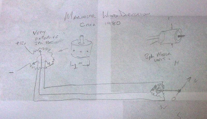

I've seen this done in a couple of clever ways:

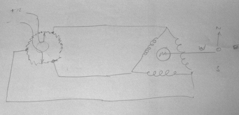

a) I used to repair and fit Yacht electronics and one make Mariner used a neat & simple 3ph potentiometer linked to a small 3ph motor in the head unit (see pic below). The pot, made by Penny&Giles, was the better part of £100 back then :(

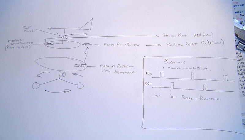

b) Saw this idea in an electronics mag's and thought it worth keeping.
The idea is that the wind speed vane, scans the direction vane producing two pulses . one pulse produced by the speed vane is counted to measure speed and it is also used as a reference to  time the direction pulse . measuring the delay between pulse thus gives direction.
[edit] thinking about it, the pot may have been configure as below.

Video of the mariner system working sort of - I think the pot and/or motor  is faulty (which is why i have it in the spares draw)

The second of BillTodd's pictures shows the easiest to wire as it takes just two wires but there is some careful mechanical work to make a head unit that will both work and tolerate outdoor conditions plus it needs some custom electronics at the display end.

Nothing really simple there so I have invented another!
Imagine a  transparent disk with binary codes painted around the edge, this disk is connected to the wind direction vane.
Another disk, this one non transparent, is connected to and rotates with the wind speed rotor.  There is a slot in this disk which corresponds with the painted codes around the wind direction disk.
A light is arranged to shine on a photo cell so that as the wind speed disk rotates light passes through the slot and on to the photo cell.
Electronics decode the binary code for wind direction and read wind speed from the interval between codes being received.
For the non electronic version have the signal from the photo cell connected to a loud speaker and paint the codes on the disk in Morse Code!  Only two wires required!

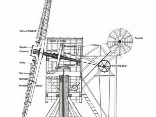

edit. Think how this fan tail is designed to keep the post mill facing the wind.

do you want the pot and motor shown in my video?
you may be able to fix / clean the pot (i have not even tried to open it)  I think the motor is ok but may need a front bearing.
PM me your address and I'll post it to you.

  • Posts: 1179
Re: How can you "drive" a wind clock?
« Reply #39 on: August 26, 2014, 02:49:24 PM »
ok Eugene it's on its way.
My guess is that the fault with the pot is mechanical. Probably, one of the wipers has come loose - P&G usualy use a sort of wire brush that wipes both the main track and the input track.
bill

What voltage / current do I apply to the pot to make things circumulate?
Eug
  • Posts: 1179
« Reply #44 on: September 08, 2014, 06:25:45 PM »
From memory, mariner used 10v but it will probably work with 5v. it's a1k pot.
